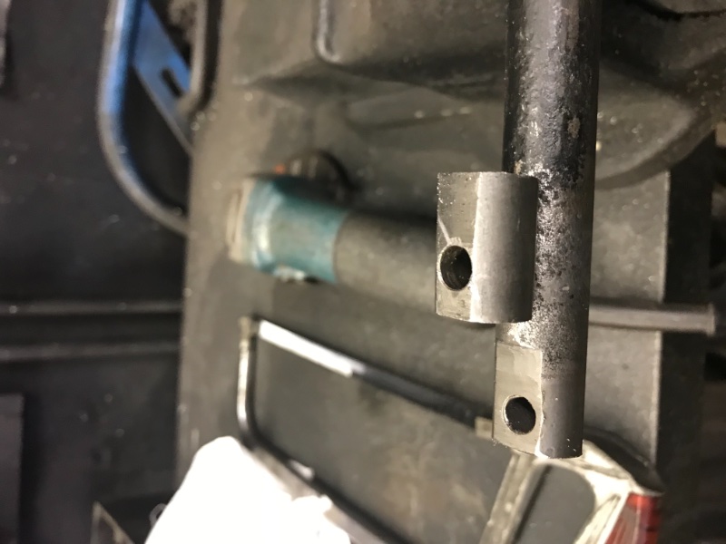

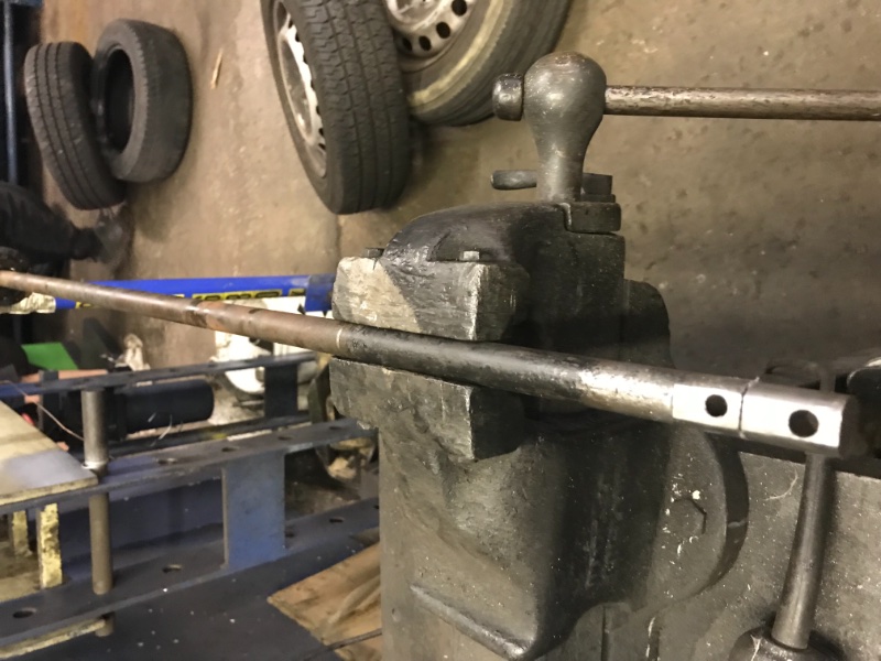

anyway column was out of the satellite so thought i woud shorten it by 2” just to play safe
now i have shortened it i reckon u could easy double that
pressed old pin out,measured flat surface distance from end ground & filed it accordingly measured distance from end to hole, drilled new hole then pressed in old pln back in, there is 2 spring steel washers under curved coupling spacers and were sligtly worn so i added a thin washer under each shim fitted coupling back together now tight as drum and steering wheel definitely feels in a better place

Nice one, you could also replace the stock pot joint with a universal joint from Borgeson or Flaming River while you were doing this mod, that's what I've done with the last few cars I've had.
Posts: 22199
Re: 2” matters it make a dfference
Blue wrote: Sun Aug 05, 18 10:06 am Nice one, you could also replace the stock pot joint with a universal joint from Borgeson or Flaming River while you were doing this mod, that's what I've done with the last few cars I've had.
I have done the same, uses a "Double D" UJ and also a roller bearing at the bottom of the column.
I have also taken the spacer out of the Challenger Column so it is about 5" shorter overall, I can just about squeeze my gut around that and the Kirkey seat......
