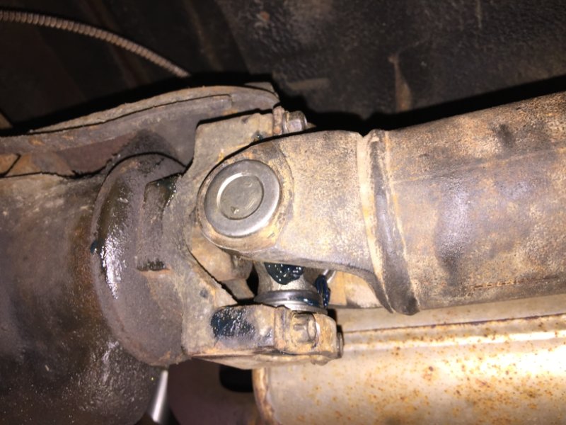

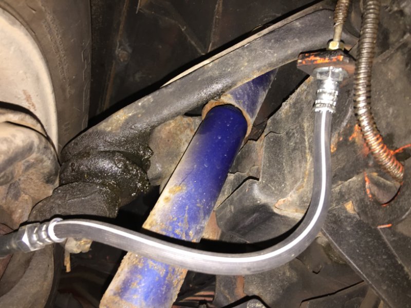

well it was all looking to good wasn't it. But I noticed the car was blowing blue smoke on start up and the hand brake cable was stuck. Took it too the local American garage and they confirmed the worst, needs a top engine rebuild. Also brake hoses corroded, petrol tank leaking at the level sensor and play in the drive shaft. So it's in for some work.
Here are a few photo's:

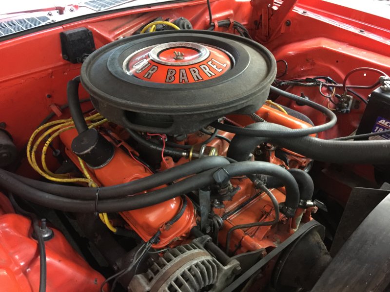

So not looking so bad, the car's had an engine rebuild in the last year or so and the valves and guides are new. The guy that rebuilt the engine forgot to put the valve stem seals on. So it was blowing blue smoke.
The other good news is there's no rot on the body work, it's all solid. And someone spent a lot of money restoring it.
I bought the car on ebay without seeing it, so I think I've missed a bullet.

Engine's back together.

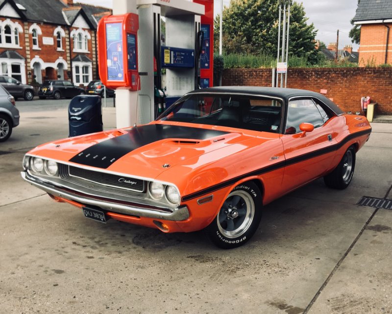

The stripe's on.
Re: Mark B's Challenger
Posted: Wed Oct 17, 18 7:41 pm
by Slowhand
Beautiful car Mark - Gotta love an e Body. Glad it turned out to be not too serious in the end.

Wasn’t sure if the engine was original on this car so I checked the engine number on the block and it matches the vin stamp near the cowl and vin tag on the dash. So matching numbers car :).
