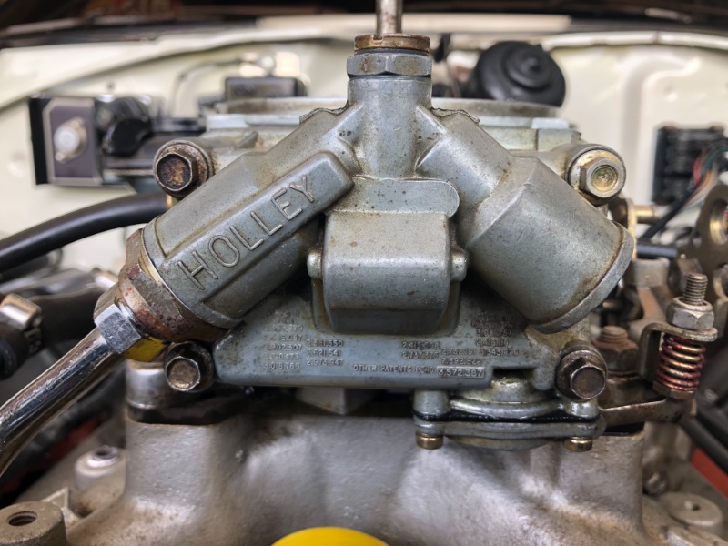

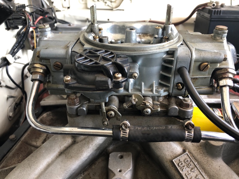

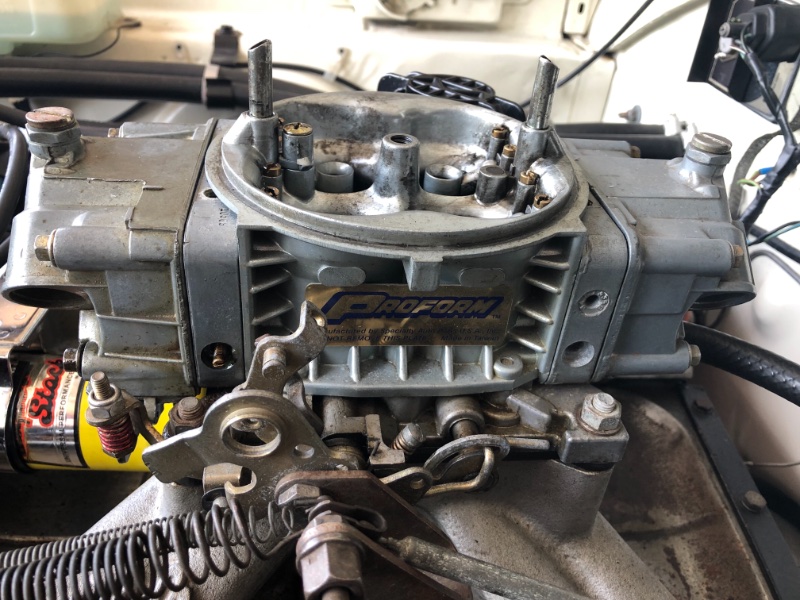

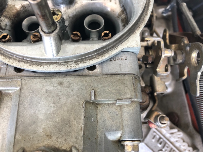

Can anyone help me with identifying the Holley section of this carb please? I need an accelerator pump gasket as a minimum but if I take it apart I want to refresh as much as possible and want to make sure I get the correct rebuild kit. Thanks Stewart.

The patent number suggests this is a 600 cfm. Would I be right in assuming that the float bowls will be the same for 600-750 cfm carbs?

Almost certainly started life as a 3310 before someone fitted the pro form main body, 750 CFM.

To my knowledge there are only 2 Holley style Accelerator pump gaskets / Diaphragms available - 30cc and 50cc.
That is a 30cc one.

Thanks Pete👍 Ordered a rebuild kit.
