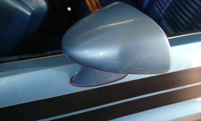

Been doing a bit of work on the Challenger. Replacing outer glass seals on the doors, greasing runners for the window mechanisms, applying a bit of Dynamat and other stuff and I suppose I should have realised there was something likely to be up before now - in that the door mirror didn't look as I expected (no screws showing on the outside).

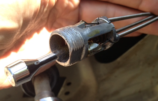

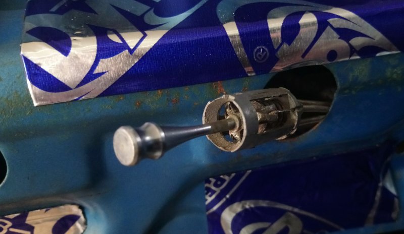

Well sure enough inside the door I found this all wrapped up.
So now I'm thinking that would be handy to have! A quick search online says I need to make a hole in the right place on the panel, get a plate to go behind it and a chrome bezel to screw on the interior side.
Only issue is - there are no threads on the unit.
Is there something else that I need?
Is it the correct mirror?
Cheers in advance for any help.

Dont know on the chally, but on my charger the remote mirror adjust looks just like that - 3 cables - and its pretty much 'all in one' with the mirror - which has external screws.
Having the adjuster but no hole in the panel seems odd -
Does the lever move the glass ?
Its either orig mirror and someone put a new panel on losing the adjuster or a new mirror and panel. Either way - odd.

It looks like the threaded portion of the remote housing has broken off !!!
Screen Shot 2019-07-23 at 22.54.00.png (120.57 KiB) Viewed 3562 times

The lever does work the mirror, the panel though is indeed a replacement.
I guess at some point someone has had a bit of an issue (probably when replacing the panel) and damaged the thread / knocked it off.

I think your door mirrors are General Motors - I'm no expert but they look similar in shape to those fitted to most of their 70-80's cars. Later versions have all the screws etc as internal fitments plus the usual "objects in the rear view may be closer than they are" script (earlier ones may have a screw at the trailing edge of the pedestal) - I can let you have pictures of how mine go together if it would assist for comparison.

Update. I've had a look at the ones I am intending to fit to Faux at some time in the future and the GM mirror control cable doesn't have a threaded end. The contol knob unit fits into a key way in the internal escutcheon which is secured IRC with a grub screw. Hope this helps.

I'll have a look into whether the fixings for GM ones can be had.

Yes, that is not a Challenger door mirror, so sounds like you have a GM mirror with GM remote. you can see that the operating lever shape is different too

Yes. Cables a bit short to work it's way round to the correct position without fouling the window and the mechanism as well so guess its leave as is - at least for now.
