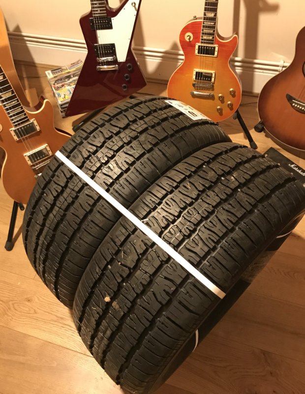

Hi All,
Has anyone had these on their Challenger / Cuda? Is the fit around the wheel arch ok? Do they bottom out over bumpy roads?
Looking for this sort of thing:
Thanks for any help you can give.

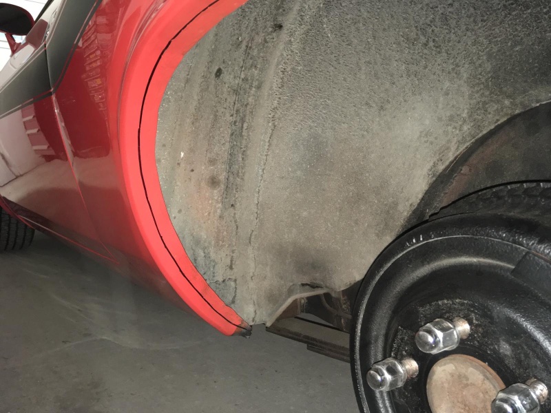

So I bought the 255/60/15s in the end, North Hants had a good Black Friday deal on. After some research the diameter on the 255/70/15s is to wide for most Challenger's inner housing at normal ride height and they only seem to work with air shocks or reshaping the leaf springs / adding another leaf.
Was going to get the arches rolled so they can fit and someone locally said they can do it but blue made some good comments below.
The lip area you are trying to roll is quite thick on these cars, I've never managed to roll the section successfully. You tend to end up breaking out the hammer and it might look ok from the outside but it's messy and you are defiantly creating a water trap. What I do these days is trim the lip back to about 1/2" wide, tack weld the 2 panel halves back together if you have gone beyond the spot welds and use panel sealer to fill any gaps to keep out the water. To the untrained eye it still looks factory.
So now going to cut back the inner lips with a grinder, wish me luck. It looks like there's surface filler in the arches for some reason, so it going to get messy.

Re: 255/70/15s on an E body?
Posted: Wed Jan 15, 20 9:07 pm
by Mark B
Finally got this done. Here’s the wheel arch returns cut back and the 255/60/15s on 15x7s just about fit.
