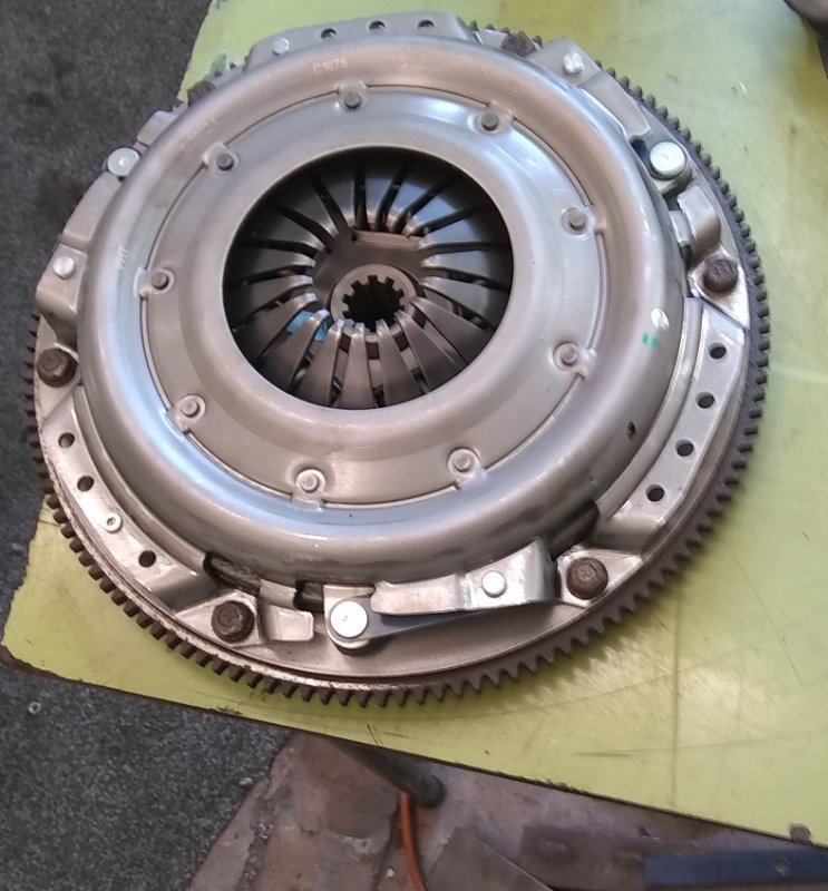

Morning yes its me again still tinkering with the cortina
I need some info and help please?
I have a 318 with a dart flywheel I think? along with the bell-housing to go with it.
I am mating a Ford T5 to the 318, and thinking of using the V6 11in Ford pressure plate?
My first question is, can I buy a mopar clutch with the same 10 spline drive as the T5 box?
If not ?
Second question is where to buy a mopar pressure plate? best price £??
I just want a standard clutch Thanks

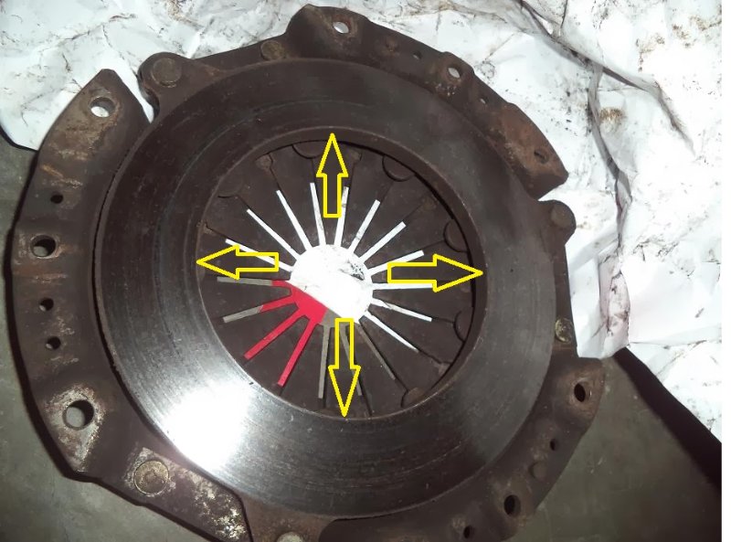

lever style cover used with flat profile release bearing
diaphragm plate used with convex profile release bearing

Well it looks like a I need a Ford V8 302 10.5 plate 1-1/16" 10 spline, as the V6 plate I got with the box is 11in and a small block dart pressure plate.
