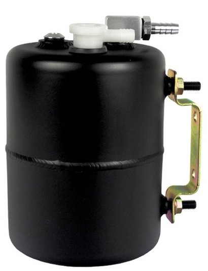

My brakes are now pretty rubbish when idle thanks to loopy-mega-psycho-cam. Fine once underway, but I'd like them back how they can be ideally. Its been suggested that I pop an extra vac can in there. There seem to be two types - one with an electric pump and one that just has the can and stores up a shot I assume.... One is five times the price of the other...
Anyone fitted one ? Did it do the trick ?
Anyone fitted an auxiliary vac canister ?
- vac.jpg (21.53 KiB) Viewed 12185 times

I put one on the '57 Ch**y and I was disappointed with the performance, and I had augmented it with a Vacuum pump too!
Brake performance remains inconsistent and you can still run your reserve of vac down, and you suddenly have a degradation of brakes - normally when you need it most!

I've fiited a couple with an electric pump at Anton's garage and had good results.

Pete - That's a kind offer (as ever), but I dont want you pulling bits off cars to lend me - you've got enough to do putting stuff ON cars ! Very interested to hear that even with a pump on it (microswitched or something I assume) it still ran out of puff. The whole point of the pump is to ensure consistency. What was the make/brand ? What I am hearing is you dont particularly recommend...
Derek - Thanks. Same question - do you happen to remember than brand ? Just curious given Petes experience.
I'm taking the consensus to be 'if you are going to bother put a pump in too'.

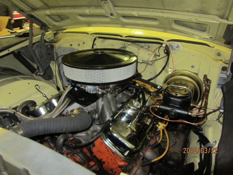

- IMG_0104.JPG (112.77 KiB) Viewed 12161 times

Brakes were epic before. Full wilwood kit, bigger than stock (I know you are not a fan, but I have no issue; they seem great). Car stopping not a problem - ( well, you know, the wheels stop turning. The car obviously careers onwards but with just the wheels locked now... as cars used to do...
(ref 'alot quicker' - yes. Have used her this week and 'tested'. Holy cow. Doesnt do much until about 4K then its like falling out of a window !)

Had the same problem (stroker Big Block with a silly cam) and I've fitted the same vacuum can (mine was Mr Gasket branded via Amazon).
Made a real improvement for me, i.e. now streetable with 5-6 pumps on the brakes before the can recharges, as opposed to 1-2 pumps on the brakes before a hard pedal!
So I'm happy with it, but I was starting from a pretty poor baseline.
I'm running big disks on the front and drums on the back on a '68 B Body.
May not be good enough for you if you're used to really good brakng performance.
