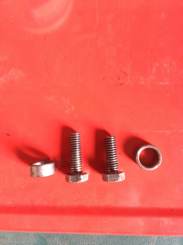

Well what a peachy day. Just tightening up the two bolts where the shifter cable bracket is held to the pan / trans and one of them didn’t want to go in. Finally got it to seat, torquing it up and it suddenly went loose. Wound it back out, covered in glittery trans fluid.

Today’s question, it’s been sat torqued up for a week whilst I raged at stripping one of the threads (I think).
1. Rubber gasket, if I take it all off again and take your advice on hooping the gasket to the pan first, will it still be useable / seal ok, or should I try and get another one fast.
2. Any suggestions on how to get the last bolt sorted, it winds in and starts to tighten, then slips as in my post above. I have nowhere to work other than on axle stands, so can’t get it on a lift and no time to get it anywhere before the Nats, so if I’m going to make it, it’s just about what I can do with zero talent in a few days.
Re: Speedo pinion adapter replacement help
Personally I would leave the pan now it’s on. If it still isn’t leak free get a cast pan and the modern plastic composite gasket and you’ll never have another problem. The correct way to fix the stripped bolt is to helicoil the case. The threads that hold the shifter cable go right through the case so just use a longer bolt with a nut on the end, fiddly but do able as a quick fix.

Thanks Blue, I was considering a longer bolt and nut, but was dubious about clearance, so that’s good to hear.
