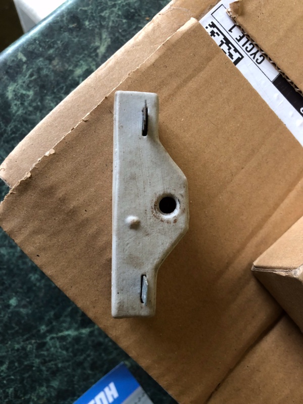

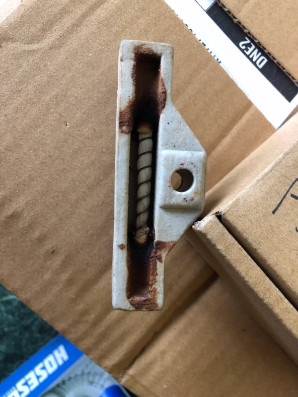

One of my heater hoses going into the firewall recently split soaking the ballast resistor in antifreeze / coolant. After replacing the hose and starting it again, the ballast resistor started smoking. It looked like this when I took it off
Fitted a spare that I have which is slightly different in design and looks like this
The original resistor has 1.12 ohms stamped on it, the spare is 0.8 ohms. The metal plate on the spare one gets too hot to touch after a couple minutes, I have no idea whether the original got hot or not as never had cause to fiddle with it before now.
I know that when it reduces the voltage it’ll generate heat, the original one was all ceramic though. The new one has a metal bracket to hang it by, this is the part that gets very hot.
Is the new 0.8 ohm resistor the wrong size ?
Will the metal bracket heating up scorch / damage the paint on the firewall or worse ?
Do I just need one that’s all ceramic like the original one ?
Or
Am I just being a pussy, and should fit the spare one and forget about it
I have electronic ignition, the orange box style
TIA

The 1.2 ohm one or bigger is usually used with a points set up and complimentary points coil
the 0.8 one is often used with orange or chrome box (and appropriate coil)
yes they get hot...less so when using the car body as a heat sink, i.e bolted down but they get hot
resistor and coil are usually a complimentary pairing, with the resistance of both combined, set to limit the current that the points or mopar electronic box has to switch off and on.
the 0.8 one would usually be used with one of mopars' performance focused igntion boxes and the coil that came with it.
so in theory if your coil was purchased to go with the ornage box 0.8 ohm should be fine
a the moment you will be getting more spark power than you previously had, but a hotter coil especially at low rpm when the dwell is long
but i am assuming you had the wrong ballast for the coil before
mopar boxes were designed for specific jobs
for example a chrome box with a 0.25 ohm ballast is supposed to be good to 10,000 rpm in a drag race situation i.e 10 -12 seconds and not much idling
if you fitted it to your car and drove down the A1 for 5 hours that box or coil will suffer and one will fail well in advance of its intended life span
if you used the 0.8 ballast with it you basically turned the more expensive chrome box set up into an orange box equivelent
bigger balast = lower current = leass heat in coil and box and a smaller rpm range
Basically more lilkley to survive none race use in a street car
ornage box is a nice compromise between performance and street
should be ok
