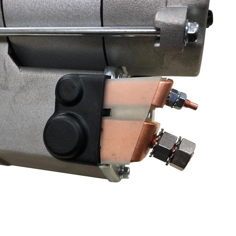

After I fitted the Mini Starter to the Dodge, I found an ad for a useful adaptor to move the terminals away from the engine block. I never did actually buy one so I'm not sure how well it works.
Just found it at Summit...
https://www.summitracing.com/parts/sum-820442
Surely worth a try at $20
(plus shipping obvs)

That adaptor will help with the block clearance issues on big blocks but might then cause clearance issues with cables and headers, not used one either.
