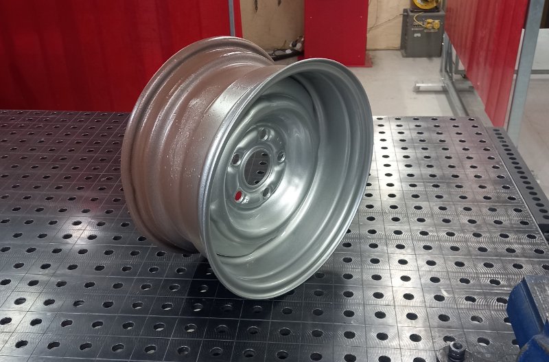

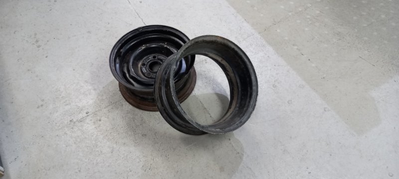

Ive been looking for the same thing for two years now, here a set I made last year.
I bought the black spoked wheels do do this, but since making them ive found the easiest 14x7 wheels around are weller wheels.
I have just bought another six to cut up,its a ball ache to do but was the only 14 x 7s available in the UK. Or you can buy them for £170+ from north hants tyres

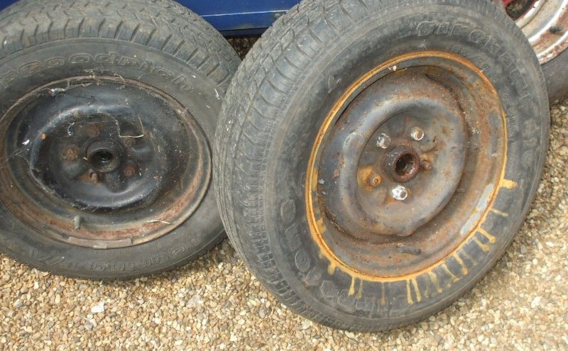

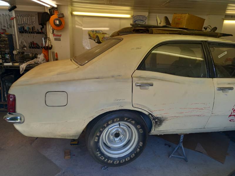

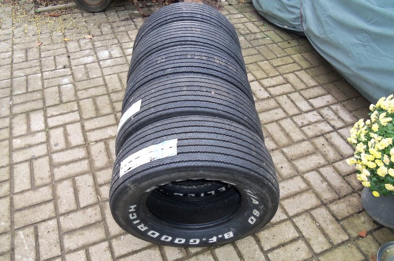

I agree, 14 are either £200+ each or not available. The only reason I am sticking with 14s Is i have these to use.Blue wrote: Sun Jan 26, 25 3:27 pm The selection of 14” tyres is very limited these days and will only get worse as there’s so little demand. Most choose 15” and then the world’s your lobster.

Re: Re barrel wheels
Yikes, how old are those?
over 10 years old
They were new old stock, had them checked out .There like new, no cracks rubber is nice and soft.
But put my small ones on for MOT
