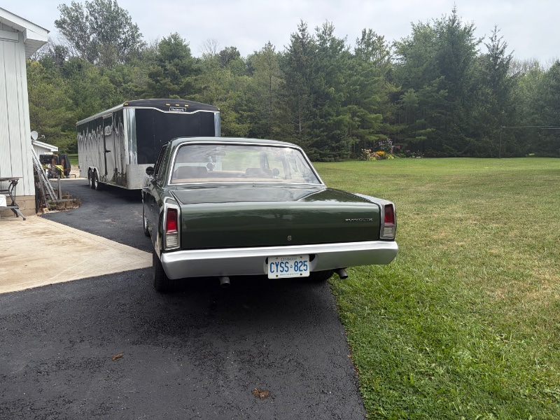

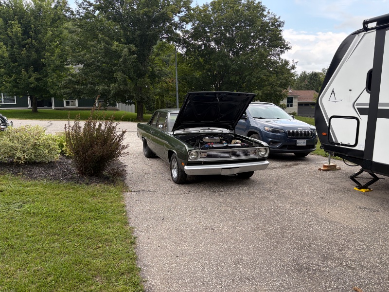

Got the car home today, went over it with Billy this afternoon.
Found a couple of things it needs.
Windscreen washer foot pump is leaking. Sounds like a common fault. I will replace the rubber foot switch with an electric one. Stop water from leaking on the floor.
The other problem is a bit more complicated.
There is nothing in the rearcend that acts as an emergency brake.
I need that for our version of MOT. The backing dust plates are home built, and the thick metal items that hold the e brake shoes have been ground flat. Looks clean, but it won’t pass.
It is an 8.8” Explorer rear end. And getting all the hardware ain’t that easy!
We thought a hydraulic e brake may work, but I think, that will not pass either. Will chat with tester next week.
But, it drives great, handles well, body and underside are just amazing! And the sound, really takes me back to the old Coronet days.
If I can blag a trailer for next weekend, I have been invited to one of the tracks for a private event. Only 40 cars!
And if my F150 has its new trans fitted by then, grrr!

Re: Jeff’s ‘69 Valiant
Posted: Sun Aug 23, 26 6:14 pm
by Stu Twin
Sounds like a fun combo in a light car.
Looks a bit tight for changing the plugs :D
I’ve heard of a few cars from the States missing hand brake hardware. Maybe it’s optional?
Posted: Sun Aug 23, 26 8:37 pm
by Jeff
Yes, one or two of the plugs look a little difficult! Will have to spend some time practicing!
Previous owner had a very understanding tester. Unfortunately I don’t, I don’t think. I will talk with him first. I think I have found the hardware I need. Just means axles have to come out. Is what it is I guess.

Stu Twin wrote: Sun Aug 23, 26 6:14 pm Sounds like a fun combo in a light car.
with the manifold going 'up' it should be ok changing plugs. on my 65 dart with a 440 i used to reach under the (homemade) fendwerwell headers from the front and although tight it was 'easy' to get to all the plugs.and that was with the early 'a' body's narrower engine bay too.

Get yourself a plug socket with a hex on the end so you can use a spanner on it. Always been my approach with big block A bodies.

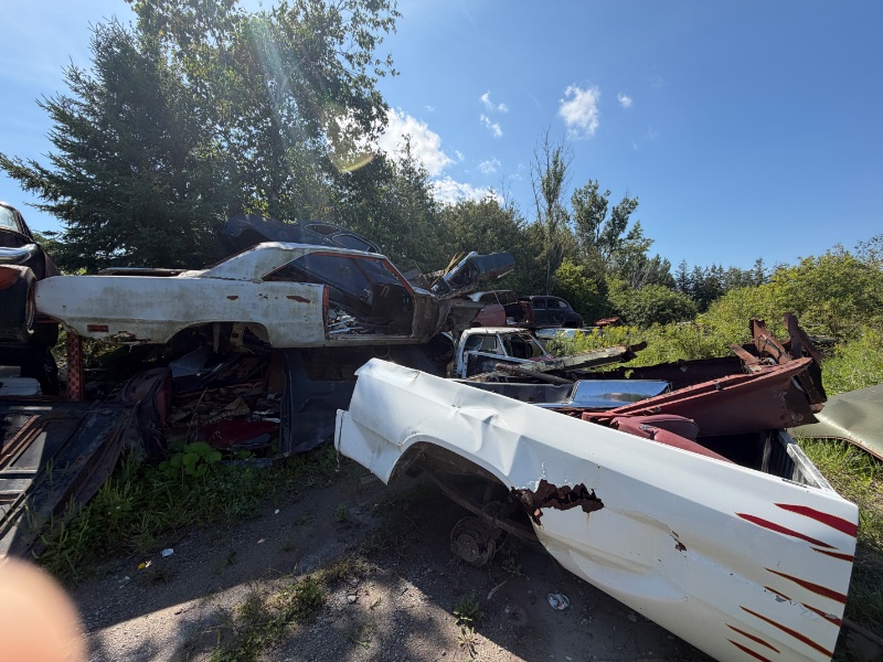

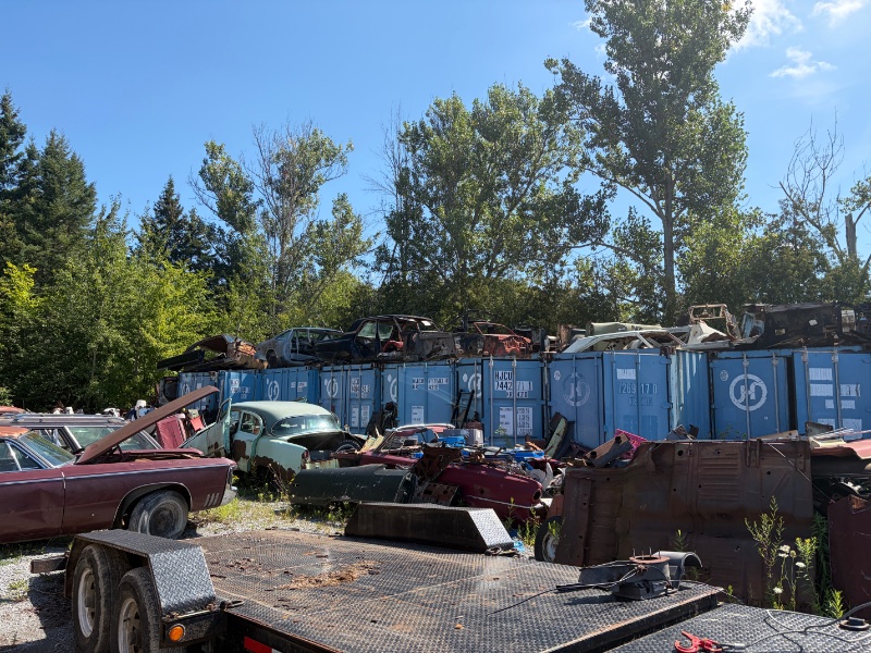

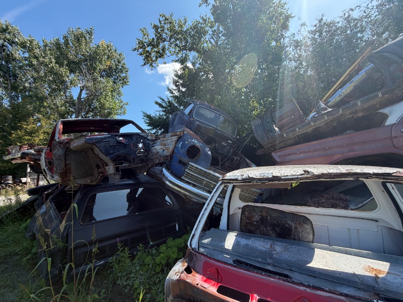

Today I went to national moparts. It’s only 30mins away.
Got some defrost vent tubes, and some parts for the windshield washers.
