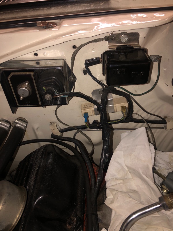

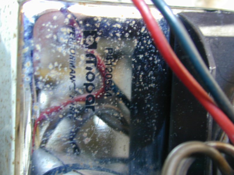

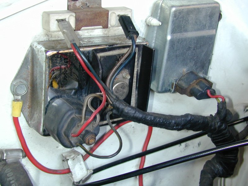

A few pics of the box: as far as I can read the part number is P4120534.

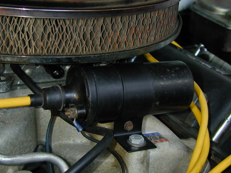

As most of the coils are oil filled and as Pete says, they are better off mounted vertically, one of the reasons I want to replace.... Sadly no markings on the coil.

I suspected it wouldn't be straightforward....

Ok looks like a mopar chrome box to me
P4120534

P4120534

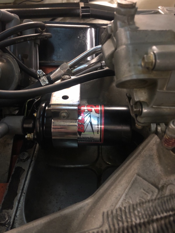

I'll try and measure the ballast resistance later and maybe splash out on a blaster II

yes if there is nout wrong with it use it as mopar intended
with a ballast and a low primary resistance coil

I think I'm past worrying about fuel consumption
I've just measured the ballast resistor, it's a bit lower than your estimate at 0.9 ohm, does that change anything or should I get that blaster on order ?

I think you will be ok
i'll caveat that with i have no idea what you did to your chrome box in the past
but it was designed for uprated coils and lower Resistance ballasts from 0.5 to 0.9 or the 1.2 -1.4

Nice one I'd best go and work out a new mounting bracket to get it vertical...

Fitted and running nicely Thanks for the advice

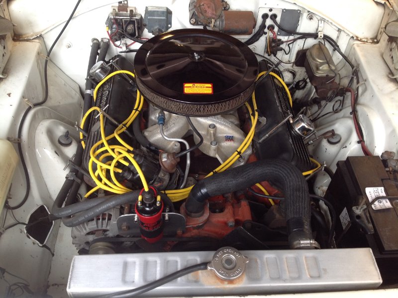

Hi. Sorry for the thread revival but when I searched this seemed to be the most relevant information.
I had my Road Runner tested on a rolling road yesterday to help with carb set up,more in this a bit later. What reared its head was a misfire I thought was sorted and additionally an overheated coil.
The car was set up for me previously and the ballast resistor was bypassed the reason I was told was that not enough voltage was reaching the spark plugs. I ran the car like this for a while and it certainly felt much better at higher revs. During this period I had a coil fail (Super Stack 8140) and replaced it with an MSD Blaster 2 82023. This coil appears to need a separate ballast resistor and when running with it lacks the power it has when not. It runs a Mopar performance module and electronic ignition.
My coil is mounted in the V longitudinally and I realise this is not correct,yesterday it was suggested mounting it upside down much further forward in the engine bay,I’m with the orientation but the position?
I have NGK BP5S plugs which are new and I replaced what originally the car came with,the tech yesterday suggested that my misfire could be down to these running too hot and detonating,he suggested BP6 or 7 to eliminate this,the misfire was evident at 4800 rpm + but at times did not affect the smoothness of the curve recorded on the machine.
Sorry for so many questions, I must admit to feeling a bit deflated and lost for a direction.
