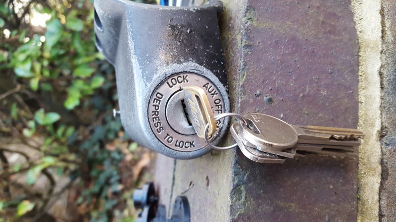

flat face ignition lock with switch held into housing using only a grub screw d shaped 4 pin bullet connector, 1 brown, 3 white with coloured trace wires.
both lock housing and connector are date stamped
late 72
same switch same lock housing different wire colors and modular spade connector
VJ on wards
3 wing mounts on switch
the steering lock has lumps either side of key and 3 screw holes in the base for the wing mount switch
different small bore to top of switch case due to no collar around the lock output cam in the housing,
modular spade connector red blue yellow and black wires.

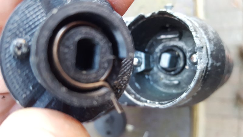

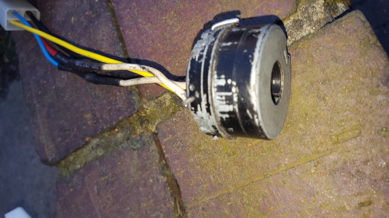

switch parts

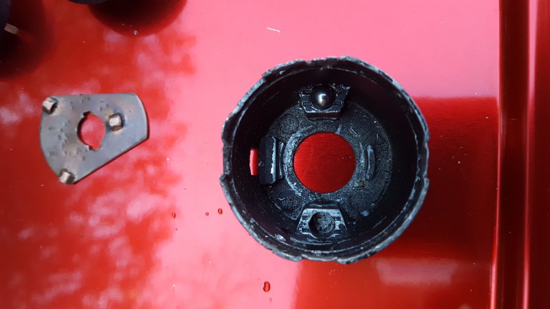

case includes 2 ball bearings and 2 springs, neither should come out easily leave them alone, one of mine was missing hence first picture shows ebay purchases to put it right.
Plastic cam/contact carrier,
plastic cam/contact carrier return spring
3 contact "float" springs
contact (copper)
base with wires.

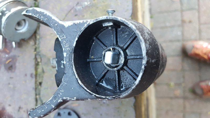

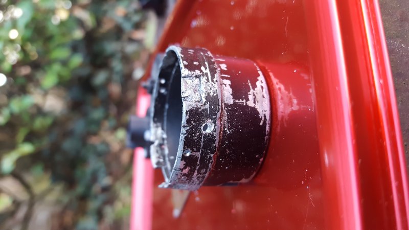

clean case
use ball pein to gently hammer out the crimp sections
make sure 2 springs and 2 balls do not fall out...
check base fits easily. it has a key the means it only fits 1 way

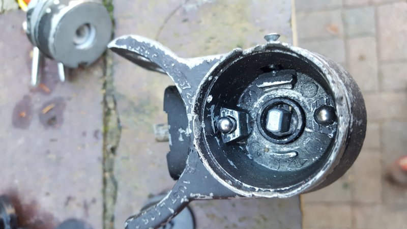

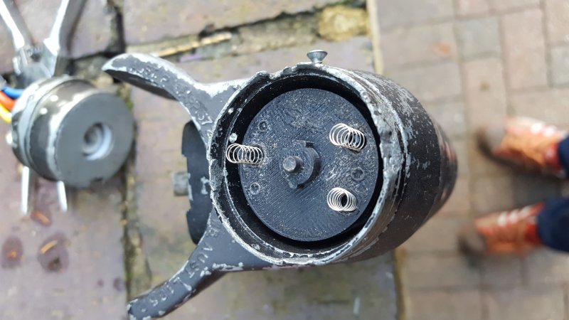

1) put case open side up
2) put in plastic cam/contact support so that it rests on the balls with them in the middle flute

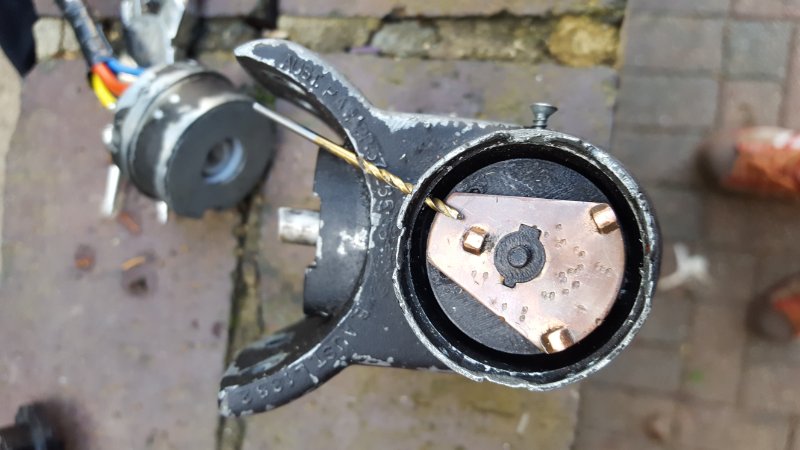

3) put in the 3 "float" Springs
4) put the contact on and hold it down flat
5) carefully establish a position in the wall of the case to drill a hole that will allow you to pin the contact in this position with your drill bit.
6) Dismantle and drill the hole.
Ready to start

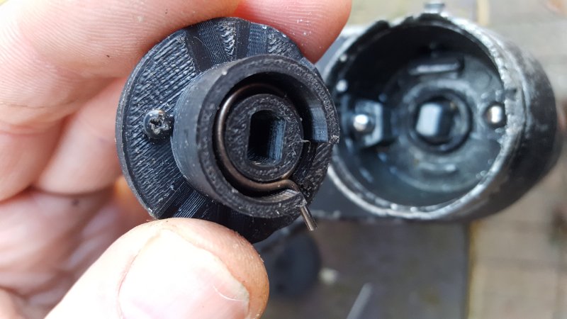

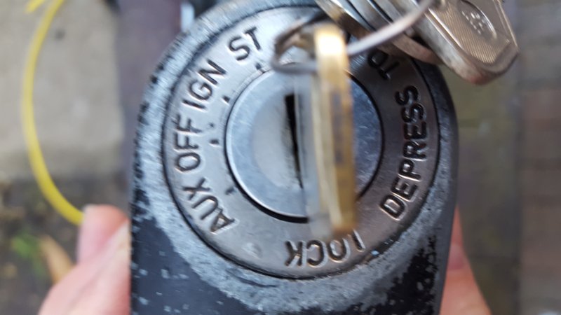

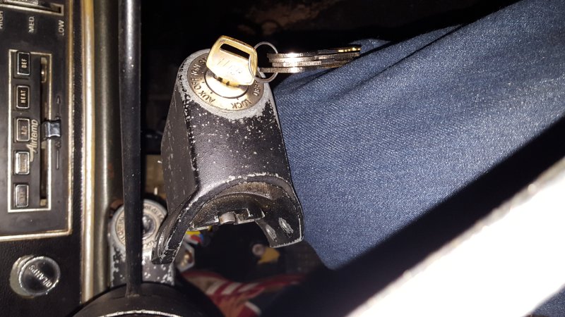

1) Put steering lock on edge of bench with key removed but lock in the the Lock position, steering lock plunger out.... it will balance
2) put case into steering lock
3) check balls and springs
4) put reaction spring into spring holder on cam/contact support (see pics)
5) Put cam/contact support into case and mount onto the end of the steering lock poking up through case (see direction in pics, it can go 2 ways and 1 way is wrong)
6) hold it in place, pick up lock put in key and very carefully check that there is no "SPRING" action until you are moving from IGN to START, any spring action before and you have the cam on the wrong way and you will Bananarama! by going further
7) turn key back to LOCK and remove, place lock back on edge of bench (see pics)
8) pull out cam again
9) check balls and springs in case and put the cam back in, the same way.
10 put in the 3 "float" springs
11) put on the contact, it only goes on 1 way, its obvious which way as its too narrow ot be supported by 2 springs at one end
12) press it down onto the drive cam and pin it in place with your drill bit
13 check orientation of base in respect to its key and the gap in the case
14) place it on to the case making sure the n1pp1e on the bottom of the cam/support goes into the hole in the base
15) press it down quite hard and pull out your drill bit
16) keep it compressed and use the ball pein to pein over the thin bits to hold the case together.
Options
use hot glue gun to really seal it up so it won't fall apart
OR
if there is nothing left to bash over with the ball pein hammer go back to your drill..
check positions of wires on the switch base
choose the 3 areas furthest away from the wires and drill through the case into the base 2-3mm. you do not want to do this near the wire entry points as you will drill into a contact and short it out to the case. Do this with the base properly in
cut 3 small sections of paperclip and stick them into the holes. make them 4mm long and bend the ends over.
make sure they don't come out by using hot glue.

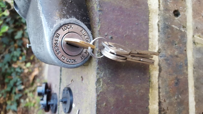

couple show switch used in running car

- Proof car running
- 20190310_160718.jpg (89.45 KiB) Viewed 1417 times
- 20190310_160727.jpg (85.38 KiB) Viewed 1417 times

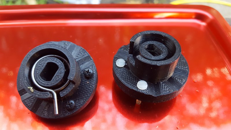

Re: How to rebuild 71-82 aussie ignition switch

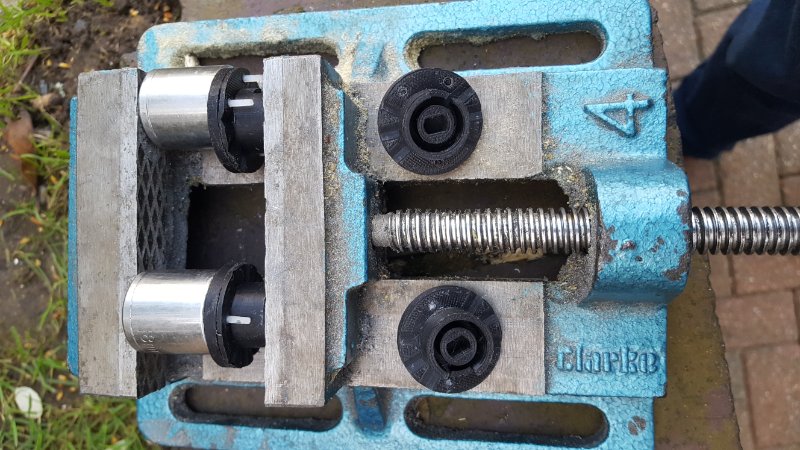

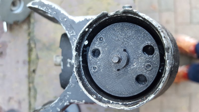

PS anyone wants a plastic middle bit
£20
plastic printed at 100% fill from a fibrous plastic similar to that used for plastic road signs
plastic printing meant it had to be done in 2 halves and aligned
this is done with nylon screws
whole lot glued together and the heads of the screws ground off
it is used in compression all of its life so it aint coming apart
spring mount was thickened slightly
n1pp1e on the bottom is over long and will need trimming to fit your specific case and base or drill out your base
£20
- 20190310_153311.jpg (67.75 KiB) Viewed 1417 times
- being glued
- 20190310_164921.jpg (102.28 KiB) Viewed 1417 times
