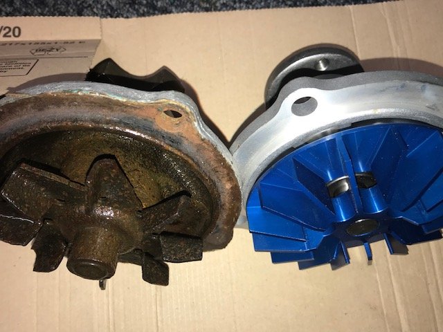

So I decided to fit a new water pump following a chat with the twins at xmas.
I have always suffered from 'traffic panic' a little. Now my first 440 I ran for ages on a 22" rad (recored, but still a 22) and a rubbish fixed fan and no shroud. It behaved 99% of the time but I did boil over once going into Harpenden (like 30 mins stationary). So it didnt like traffic basically. I swapped to a big 26" ally rad with a shroud but it could still get warm.
When I fitted the warmer 440 (which came without a water pump as the casting was needed for a numbers match engine) I swapped the pumps over, installed the rad, shroud, bigger viscous fan etc. All good. BUT (on admittedly a hot day) it did get hot in traffic to the point where I had to abort and let her bubble over. Anyway - given that my cooling system is all big-and-top-notch I assumed my problem was in the timing and the unwrapped ceramic headers. A chance conversation with said twins made me think of something else - the water pump. It only happens when stationary (idle) and the problem followed from mild-hot engine and is seemingly independent of the rest of the cooling system.
Flokool pumps are supposed to double the flow rate, pair with a high flow thermostat and they can (unrestricted) drop 30 deg from stock.
So today I decided to start pulling it all to bits and changing it. Thought the internals may interest you all.
Ignoring the crud on the old one - Look at the difference in the pump ! The blades fill the hole now and the gaps are really small round the edge compared. I can see why this moves it round. Lets see if it does the trick... Cant hurt !
Old vs new -
Old vs new -

Interested in the outcome of this Morgan, keep us posted please, just another thought, how is your thermostat, if it's not opening all the way it could give you problems too.
Re: Cool, man... (water pumps)
That does look like it will move alot more coolant, as you say blades right across rather than a cake mixer.

Ignoring the manufacturers claims which being American are liable to be total cobblers, the modern impeller design can only move water more effectively. I also only use Mr Gasket high flow thermostats, I believe they keep the temperature more constant due to the higher flow rate when they open.

OK sportsfans, water pump is in.

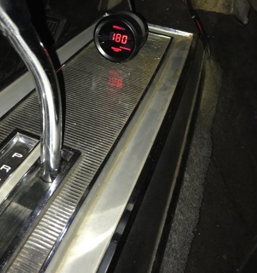

Its difficult to tell at the moment how effective it is, but all I can really say is that it sat there and idled for 20 minutes and I could see via the digital the thermostat opening and closing. I didnt put the high-flow one in yet as the old one has only done 500 miles and appears to be perfect.

On the pump itself, went in first time. Really snug fit for the impellers but doesnt foul, all bolts lined up, even got the viscous fan coupling through the pulley first time TWICE (twice bacause I fitted it and forgot the shroud first time DUH! ) and given how frustrating getting the fan bolts in can be I was really chuffed. Looks a well machined bit of kit.
