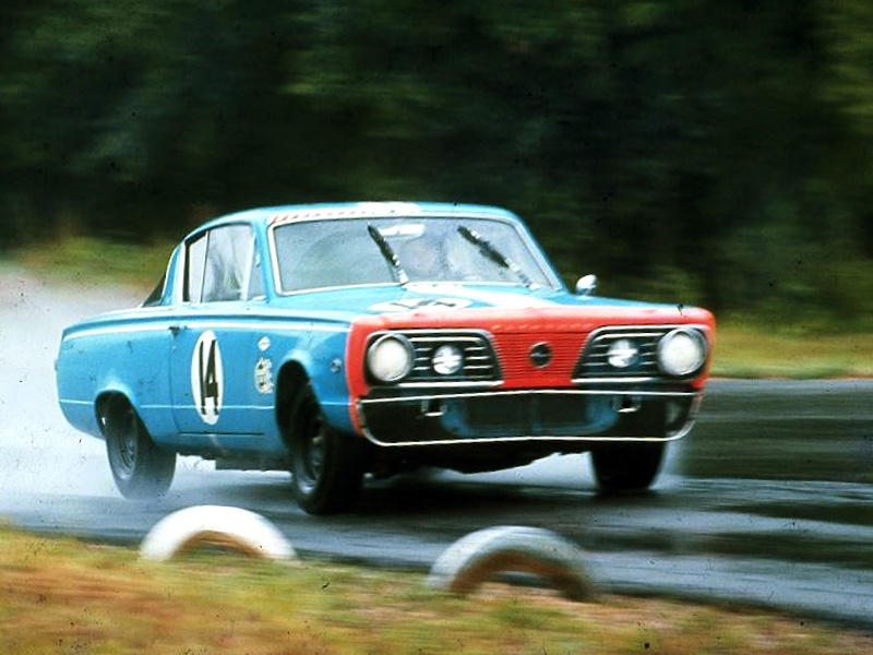

Hello,
My name is Daniel and I represent CCK Historic. We are a classic car restoration and historic racing specialist. We are building a 1966 Plymouth Barracuda as an FIA race car.
The car will be built as a recreation of the car Richard Petty drove in the inaugural year of the SCCA Trans-Am race series. More info on our website here.
http://www.cckhistoric.com/category/plymouth-barracuda/
http://www.cckhistoric.com/project/plymouth-barracuda/
So far the car is in primer and largely stripped down. There is more work to be done before it gets painted in blue with the orange front.
The biggest hurdles I have at the moment are converting the car from drum brakes at the front to discs. And also converting from the automatic gearbox to an a-833 4 speed gearbox. If anybody has ANY parts that may facilitate these two conversions please get in touch. Likewise I have available for sale the complete interior from this car and the automatic gearbox and components. Thanks very much.

- Petty Barracuda.jpg (160.04 KiB) Viewed 2539 times
