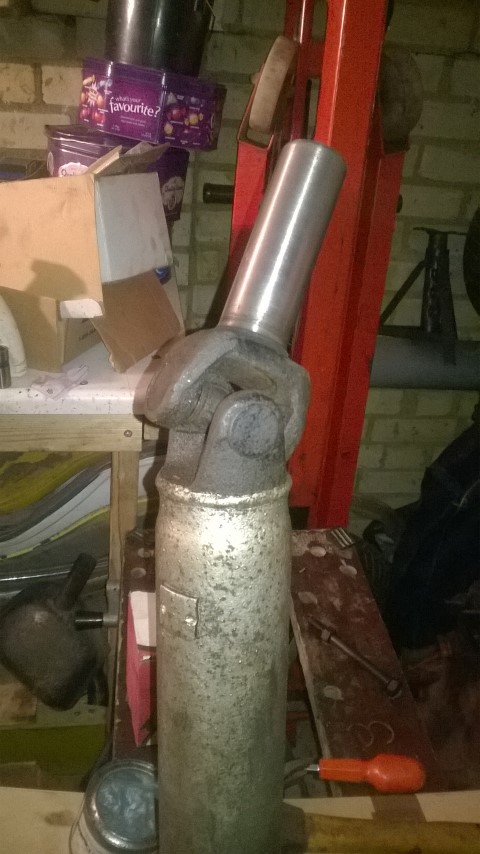

Dug out spare shaft
Picture tomorrow
Front joint mint
Yoke ok
Rear joint is dead
Based on measurement your shaft takes small dodge joints
UJ 7260.
Used in dodge trucks until the late 80s
U.S. Automotive. Will have them. Get a pair of greaseable body joints instead of a sealed for life joints if you can. (dana) Spicer make them
Unless your shaft is bent I doubt it needs a balance
WP_20160203_001 (Small).jpg (141.41 KiB) Viewed 2637 times
WP_20160203_002 (Small).jpg (133.82 KiB) Viewed 2637 times

Dave999 wrote:Dug out spare shaft
Picture tomorrow
Front joint mint
Yoke ok
Rear joint is dead
Your shaft takes small dodge joints
UJ 7260.
Thanks Dave, much appreciated. Pete is coming up on the 13th, let me know when I can pick the propshaft up, can only do weekends really.
I will contact US Automotive about the UJ.

2) I'll check my spare prop-shaft out tonight. you will need it before the weekend if you want uncle Pete to fit it. (I know he is just coming for a look but I'm doing my best to play on his conscience)

The thing in the pic, that's a propshaft right? :oops: and is it a complete replacement for what is on the car? and I need to buy one UJ (the one you said in an earlier post? let me know how much you want for the propshaft too. What do you mean about a big hammer? lol

SammyH770 wrote:
Great, thanks Dave, I will come to the Watford place as it is nearer, about an hour and a half from me so I'll leave work at 4 and should be there by six, I can only do Monday though?
Monday is fine
i'll PM you full address and phone number
Yep that's a prop shaft out of a wrecked VH 770 charger 318 v8
that I found in west Sussex car had had front wing taken out by a tree which had twisted the front chassis arm up
but was insurance write off "chassis must be destroyed" so I took everything else worthwhile
let me have another look for a joint and if I find it i'll put it on this weekend
that means it should just swap in.
Buying 1 spare new joint will be useful in case the front joint decides to die.... its a 20 quid part
all I did was clamp the yoke in my vice with a cloth round it and waggle the thing about. no obvious signs of ware no grittiness but I'm not going to twist it like a motor does due to my tiny ladies hands
you can have it it hasn't moved in 8 years
I'll take your old one at some point if you don't want it or buy me a pint at the nats
I only had it for cutting down to size. I once had a plan to fit a Toyota W58 5 speed manual gearbox to my car but once I saw the chassis hacking necessary and the cost of custom bellhousing clutchfork etc I change my mind. :)
yes your prop shaft is a big long metal cylinder with a swivel joint at each end. connects gearbox to axle
the shiny bit is the yoke it has a spline to the inside that slides over the output shaft of your transmission. it just slots in
it moves back and forth a bit as the rear suspension goes up and down
it has a seal around it to stop all the oil in your transmission falling out
the other end joint (the rustly looking one in the pictures) is clamped to the input on the axle by two tiny metal straps and 4 11 mm headed bolts
you wouldn't think that it takes the full torque of the engine but it does.
BIG HAMMER
the joint is held into the end of the shaft by metal cups (filled with rollers) that fit into the eyes in the end of the shaft you can see them in the pictures looking like they have never been hit with a socket and a big hammer
the cups tend to get stuck
so although last night I got the retaining clips off and gave it some attention with an old socket and a really BF Hammer
they didn't move
so its having a bath in WD40 at the mo.
and the BFH will come out again.
I don't own a press and my VICE aint big enough to push them out so I have to tap tap tap
1/2 hour job
