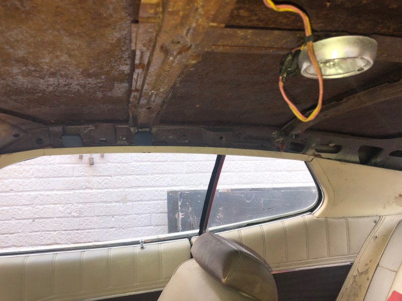

My Charger came to me without any remnants of the headlining, including the bows (or any other fittings). I know that either four or six bow liners are fitted, but I have no idea which mine originally had!
More confusing is that there appear to be five sets of holes along the upper edge inside the roof, presumably for the bows to fit into (also one extra set of holes beneath these). Can anyone shed any light on this for me please? I’ve taken a photo showing the holes (attached).

- IMG_3406.JPG (79.68 KiB) Viewed 1980 times

Mine is an SE and iirc has 4bows thats all I can give you as I'm yet to reach the stage of refitting a headliner.
Re: Missing headliner and hardware - 73 Charger
Perhaps all 73s have a four bow liner? It would be nice if that was the case, but Sod's Law probably says otherwise!ScottyDave wrote: Fri Apr 26, 19 6:02 pm Mine is an SE and iirc has 4bows thats all I can give you as I'm yet to reach the stage of refitting a headliner.
some of the holes might have been for plastic stoppers that acted as a place for self tapping screws to screw into that originally held on a big plastic finishing strip that clamped headliner on inner side and rubber seals for door and rear side window on the other
i say this based purely on my own car which is australian rather than any knowledge of yours
bows would go into the higher set of holes i'd guess, hanging headlining taught across the majority of the roof
the bow tunnels on the headliner back, end before the sides of the headliner, and the sides left flapping tuck in/are pinned under trim piece or window rubbers.
i think
don't take as gospel...just a guess based on fiddling with mine
you are in luck
73 parts book here
http://www.mymopar.com/index.php?pid=107
dodge 73 body manual here
http://www.mymopar.com/index.php?pid=109
use first to ID parts list
use second to see how they go together
you will have to manually search both as they are scans not OCR-ed text
73 parts book here

https://www.ebay.co.uk/itm/1-x-Fast-Fix ... SwcnpToC5B
I used a Hi temp spray glue for my Headlining soundproofing something like this
