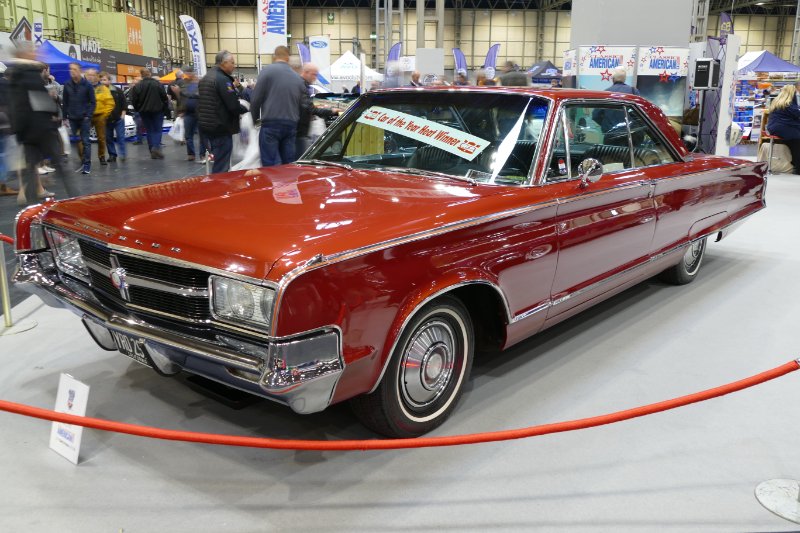

I am already a member, my first quasi-American car being an Aussie VE Valiant 273 which will be for sale soon as I have just acquired a similar shaped car but twice the size! Arrived in pouring rain at night, of course, unloaded in local car share car park then brown-trouser drive for last mile to my house with no seat belts, steamed up window, no dash lights, ultra-sensitive brakes, not so great headlamps then a dash up my quite narrow sloping driveway where you only have the one chance to get it right - no stopping for any reason else you won't make it. Almost fell off edge of drive one time but made it safely into garage where it just fits. It really is as big as a whale, it seems as wide as a whale for sure in the dark. One pic pasted below but more here:
https://sites.google.com/view/1965newyorker/home
It has a strange electrical adjustment system to operate the brakes on a trailer which in wiring terms looks quite dodgy. Also some campaign stickers for local county comissioner in the glovebox: Vote for John Barr Lipscomb.

Congratulations on your purchase!
I know you mentioned poor headlights, but i think a lot will depend on whether you can find donor 5" lights as I assume the current ones are sealed beam units.
Re: New car arrived: 1965 New Yorker
Cool car👍
You’ll get used to the size😎

Very nice, John :thumbright:
Similar to Geoff Mitchell's 66... 8-)
