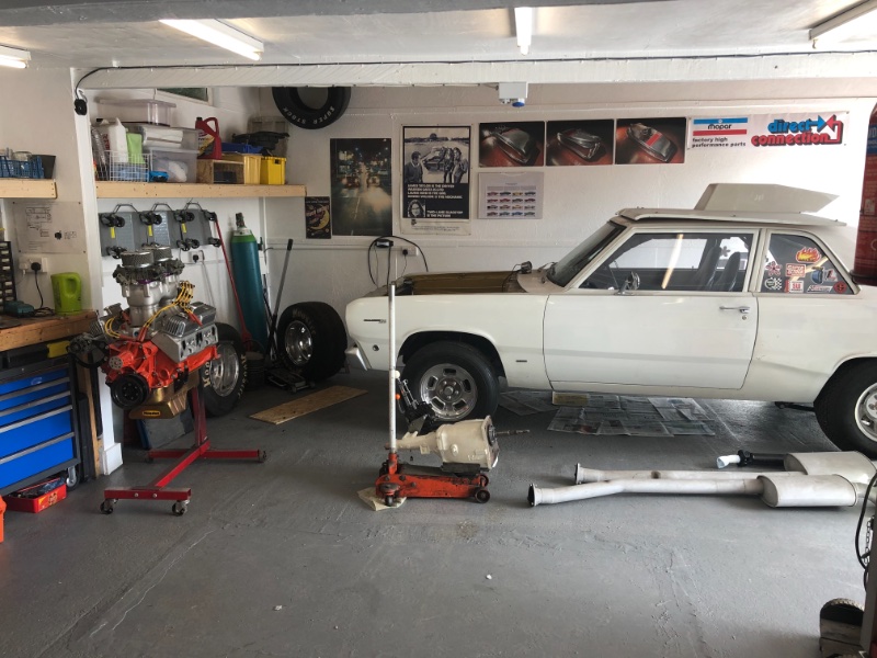

Posts: 14558
Re: Blue's Valiant
Blimey a year since the last update! Much has changed, Covid,retirement and moving to a smaller workshop for a start. After a bit of a think it was time to let the Valiant go, well some of it at least. Engine I am keeping and the four speed set up I will sell Separately. Royden has bought the car so it’s not going far, it goes in for paint in 2 weeks time and then I will be fitting another 408 with an auto trans. No doubt I’ll still get to drive the car so it’s all good.
