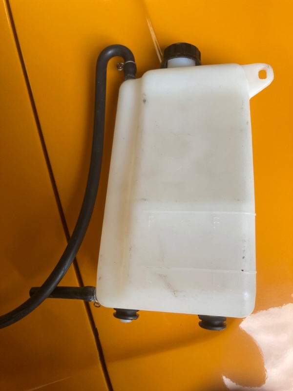

Most of our old cars didn’t come with expansion tanks and will run fine most of the time without. I’m a big fan of fitting them to keep the system purged of air and it certainly helps keeps temps down in traffic. Positioning isn’t that critical I don’t think but the higher the better seems to make sense. I use one from a Kawasaki Mule, it’s big enough and a sensible shape for ease of fitment.

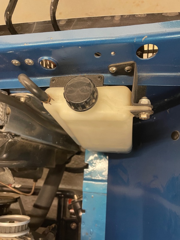

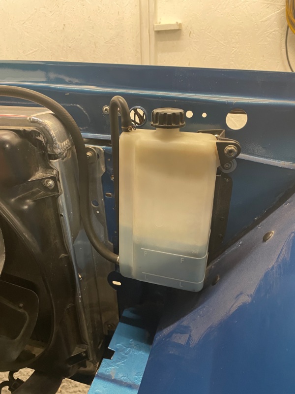

That’s uncanny timing, just sorting fitting this today!
I was also wondering not only about height, but distance from the rad for the return.

Next to the rad is ideal but as long as you’re not fitting it in the boot I’m sure it will still do it’s job.

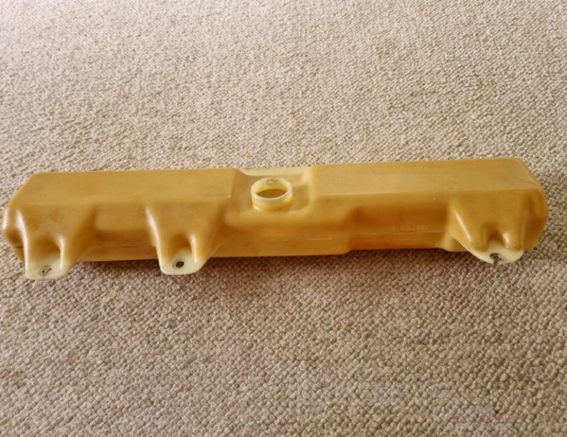

Was going to go down the aftermarket expansion tank but an original one popped up on ebay
got to get a cap but they're a common Mopar unit so available new
