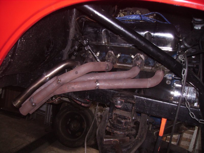

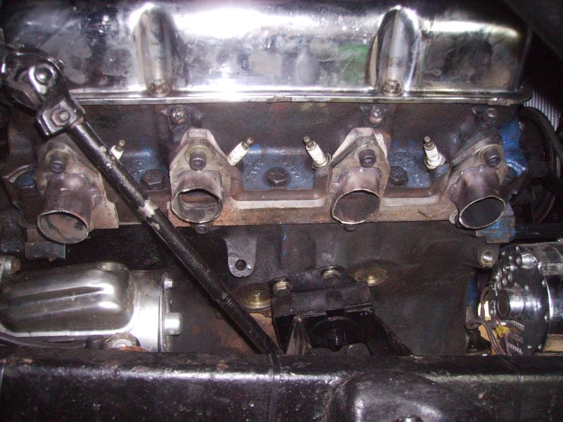

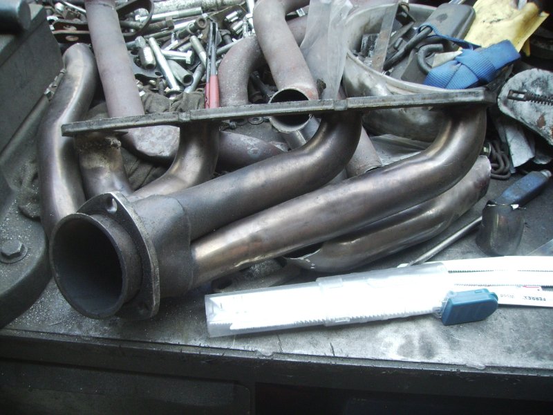

today we started on ashley's headers. we have a couple of pairs of small block ones at 1 5/8" and a couple of pairs at 1 3/4" which as it's a big block we thought were better suited. especially as one pair were stainless fe ford ones. so we didn't need the new flanges ash had bought so they'll go 'in stock' for later. with the flanges cut from the fe set leaving about an inch stub of tube at each port we got them bolted to the heads. the driver's side had to have the divider cut out between the rear 2 cylinders as the steering column will pass through the header there making removal and fitment easier. we cut the collector away too giving us a set of tubes to play with. we also cut the flanges from the other larger set (big block mopar) as well as their collectors. more tubification next, lol.
neil.

we're getting there on the worst (steering) side :thumbright:
neil.
