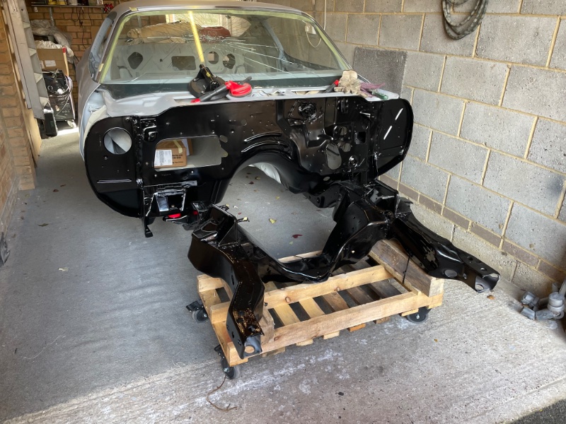

However I’m 69 so time is very precious and any spare hour is on the car,

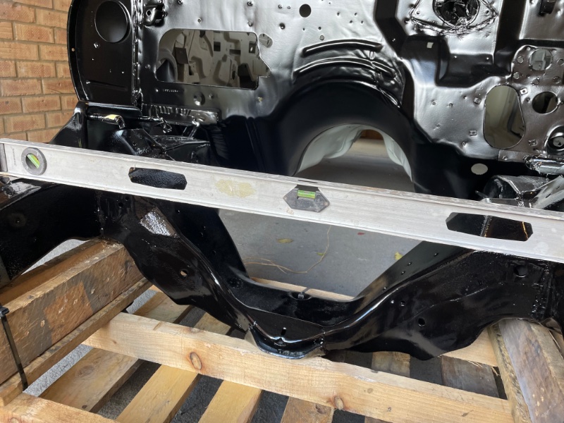

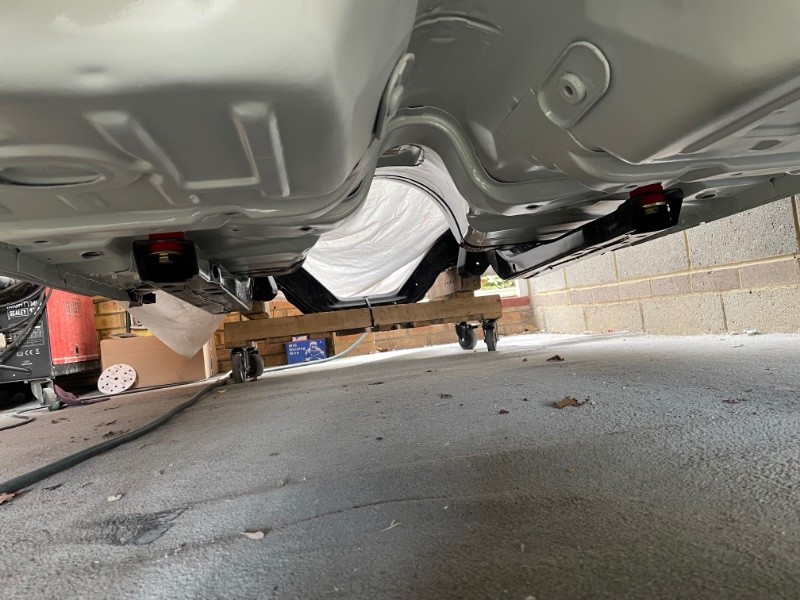

Had to do some shuffling around today as I wanted to fit my subframe,
It’s a big heavy lump and I’m single handed so some creativity is definitely needed!
Reasonable pleased with the fit, just a quick centre and the level was pretty close , may need to shim but require much better fitting alignment pins
Which I’ll have to make I guess ?

it's getting better every time i look in
will you waxoil or similar inside the subframe, sills etc once all the painting's done?
neil.
neil.
Re: My very last restoration!!!
Absolutely!
Everywhere I can stick the probe!
Old school but it bloody works,
The spinning tip thingy works very well providing one gets the waxoly nice a warm ,
But obviously at this stage everything is done oil and grease free, so getting things like door hinges the side about it a challenge!

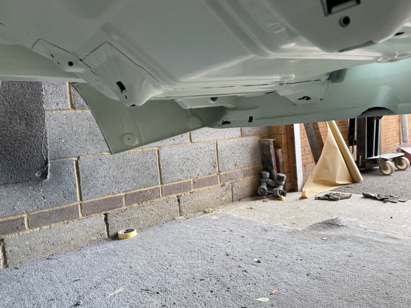

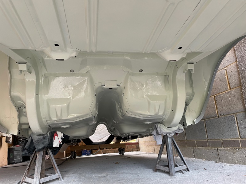

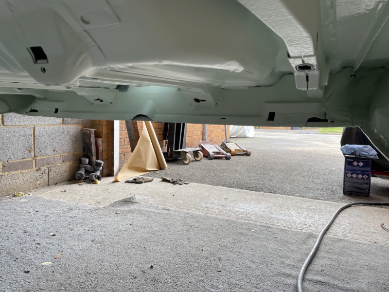

No court yesterday so I cracked on and got the rear underside in paint,
I’ll be able to lift the axle and cart springs into place next week.

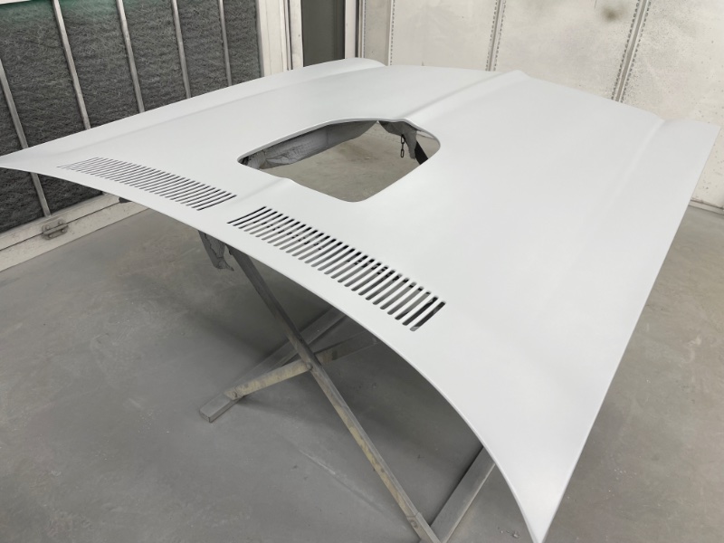

I flatted the epoxy and 2k primed the Hood today
As per made in Taiwan but it’s actually not to bad,
No idea at this point whether it fits ok !
Time will tell
Looking back at my never ending summit invoices my parts are very global!
Time will tell
