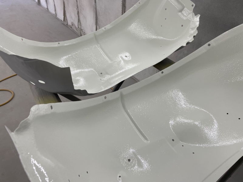

Detailed a bit more of the block today
And started to get some colour on the inner fenders
Tedious items as flat black one side and body colour on the other !

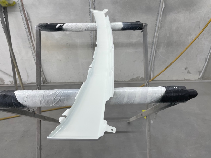

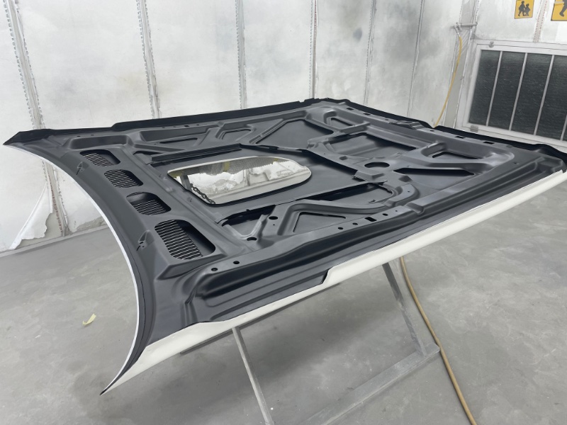

The whole flat black under the hood on theses F body’s is a proper PITA , finally finished it today, so now just old school white !

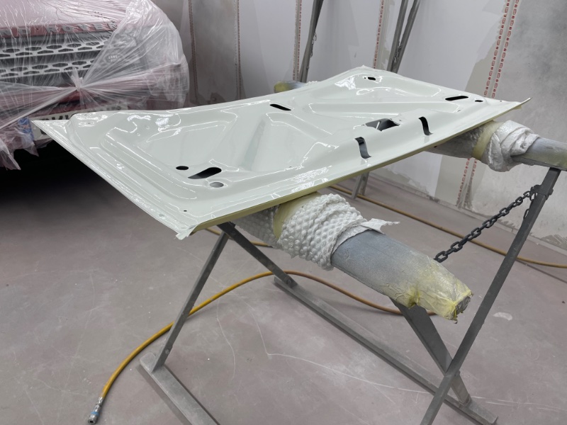

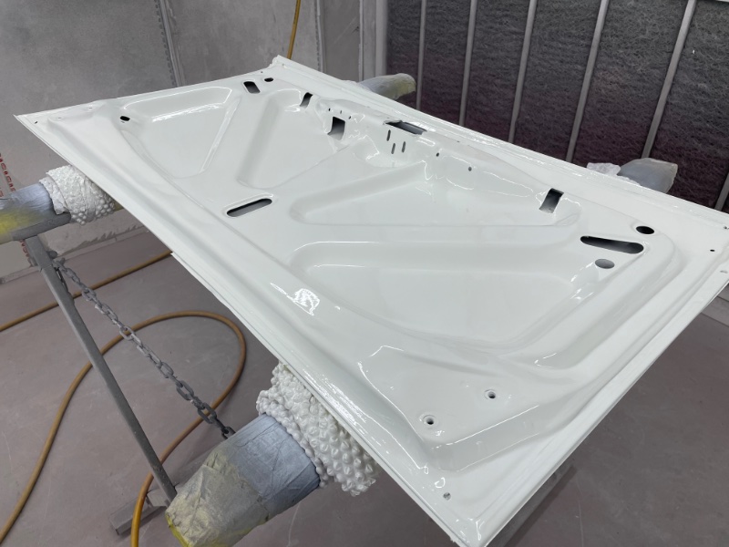

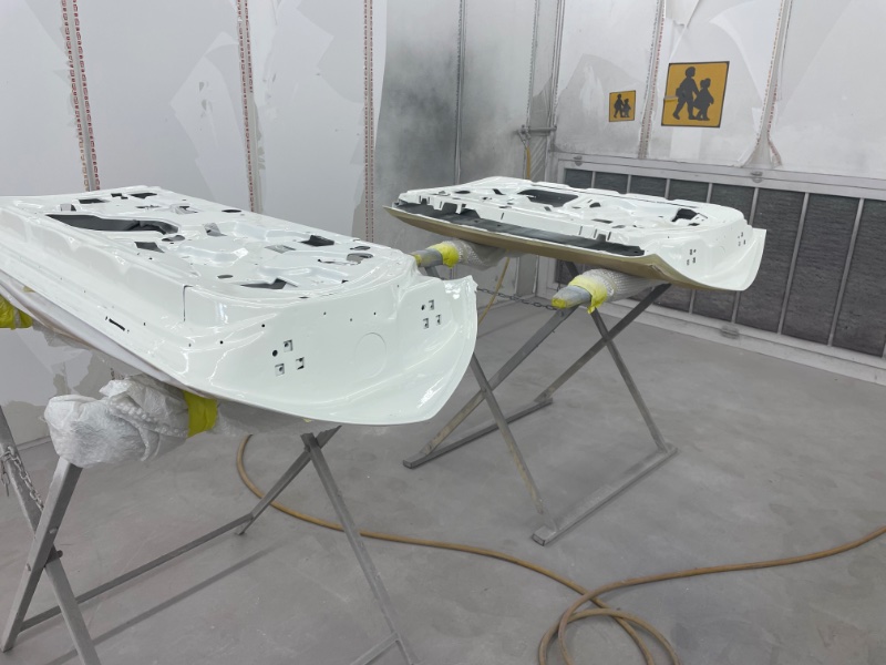

Finally getting some colour on the turd
Pleased with my colour choice,
I’ve gone for Porsche Grandprix White,
A late 70’s RS colour , absolutely spot on for GM Polar but a shade cleaner,
And more importantly reproducible, as it’s a catalog colour
