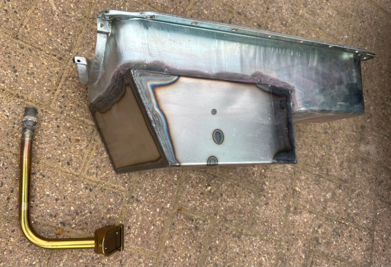

Meanwhile, back at the oil pan…
Todays job was making a trap door, it opens on acceleration and closes on braking in order to keep the pickup covered. It needs to move swiftly with oil surge so the door itself is aluminium rolled loosly around a steel rod to act as a sloppy hinge. It moves very freely and shouldn’t become jammed. I’ll fine tune the location before welding it in.

Posts: 7602
Re: Blue's Barracuda
Your'e a clever sod, that trap door is a clever bit of stuff.
Posts: 14617
Can’t take any credit for that Del, its pretty much a standard mod on race oil pans, especially on roundy roundy stuff where you have oil sloshing in all directions.
Posts: 14617
Pan pretty much ready to finish weld. Pickup tacked to the 1/2” boss. I left a 1/2” drill inside it to perfectly align it while tacking it, as expected it slipped out easily afterwards so anther job jobbed…

Posts: 14617
Pan and pick up TIG welded Today so that’s another bit finished.

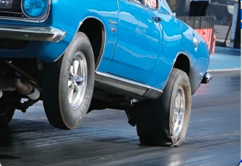

Posts: 22237
On the verge of Tyre shake....
Tyre Crush.jpeg (69.24 KiB) Viewed 188 times
Posts: 14617
Not something I can feel but I’ll try 12psi next time and see how that responds.
Rapid Richards
Posts: 54
Joined: Sun Sep 21, 25 10:49 am
Post by Rapid Richards »
I'm not sure a Nostagia Superstock has enough wheelspeed to produce proper tyre shake but I agree with Blue that increasing the pressure might help reuce those wrinkles (don't you dare Rob, Stu) getting under the contact patch, after all thats part of the tuning process.
Posts: 14617
No it’s not tyre shake, its just deforming the tyre excessively. Extra pressure might not fix it, the sidewalls could be worn out, there’s not much left on the tread area.
