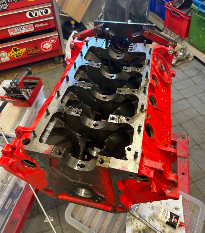

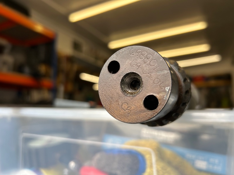

Block is stripped and all the main oil galleries at the back opened up to 1/2”, main bearing feeds reamed out. It only had half grooved bearings, I’ll go with fully grooved. Unknown roller cam turned out to be a Crane, more suited to circle track use with a lot more compression than this engine will have so unlikely I’ll re use it. Big ‘ol deburring session next.
