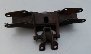

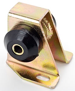

I have another k member in stock LOL if I go that route but I believe this is and easy fix with the right transmission mount Pete ...the difference between the two I believe is the later mount has one bolt as opposed to two in the 64 mount which you can see in the photos ...

Personally I'd use the later style spool mount and mod the crossmember to suit.

Blue do you think that would be an easy mod?

That is exactly what we are going to do in the '64 Polara, which has the same original set up as your car.
The "K" frame will be swapped out and a Trans cross member fabricated and use the Spool mount made of Urathane.

pete walton wrote: Sat Jan 16, 21 5:16 pm Blue do you think that would be an easy mod?
Yes, should just be a case of chopping the old mount off and welding a couple of "ears" to the crossmember to accept the spool mount. Something like this...

Blue wrote: Sat Jan 16, 21 5:29 pm
Ahhh a picture paints a thousand words ,,,looks fairly easy

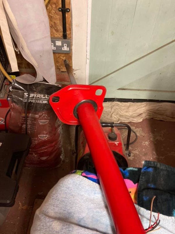

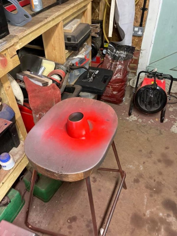

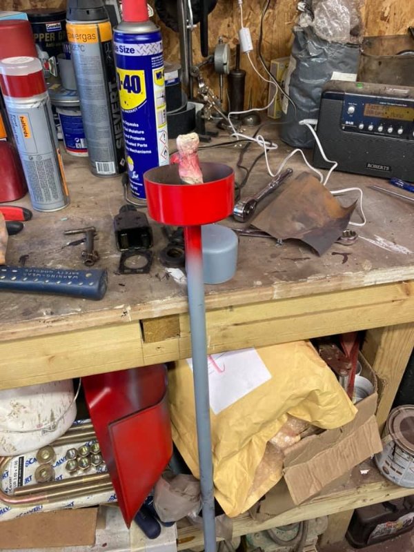

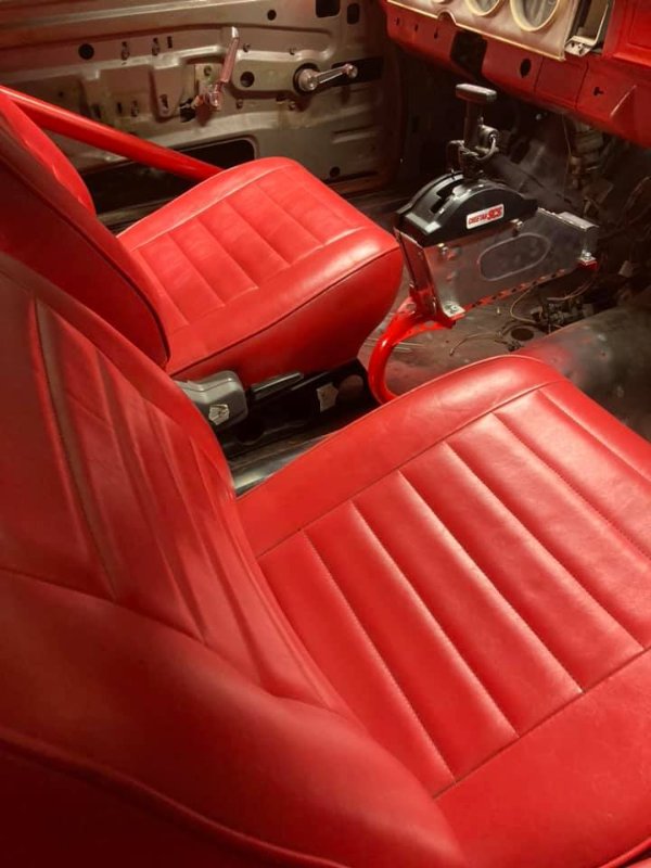

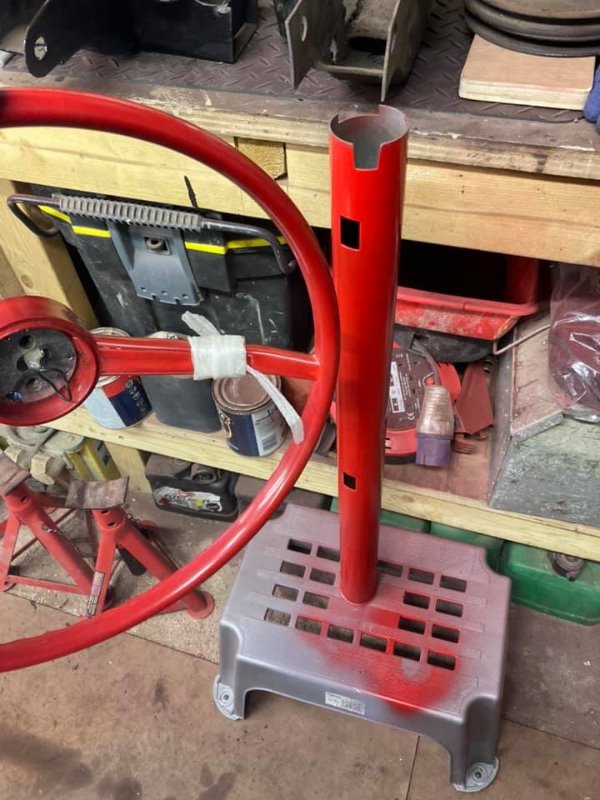

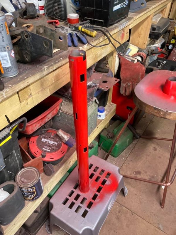

rebuild steering column ,and paint to match seats ....Halfords to the rescue ..waiting on a few parts and it can go back in
155833176_5366063410102471_5811857704459272909_n (1).jpg (77.16 KiB) Viewed 18563 times

Post by pete walton »
Not a bad match to the new steering wheel ,,,quietly pleased with the result and saved a few quid in the process ..Waiting for some bits from classic industries to reassemble the column ie turn signals electrics and bulkhead gaskets .

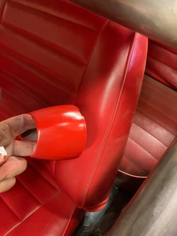

few more steps

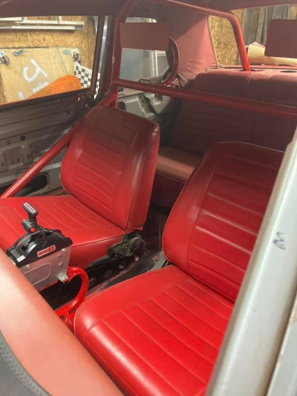

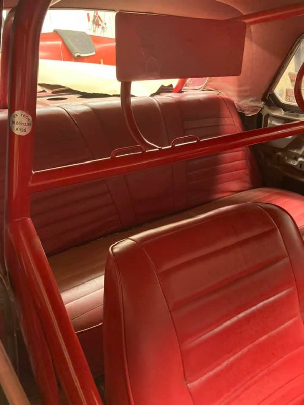

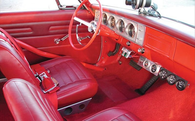

Hoping it will look something like this when finished ,although this has the push button shifter
Re: 64 Plymouth Belvedere post car
Nothing "boring " on this thread !!!!
Nice to see a pic that inspired your interior build.
Keep them coming :thumbright: :thumbright: :thumbright:
Posts: 14656
Its all very red! Good to see progress Pete.
Posts: 3721
Coming together nicely :thumbright: Please say you're sticking with the Gold centred five spokes 8-)
