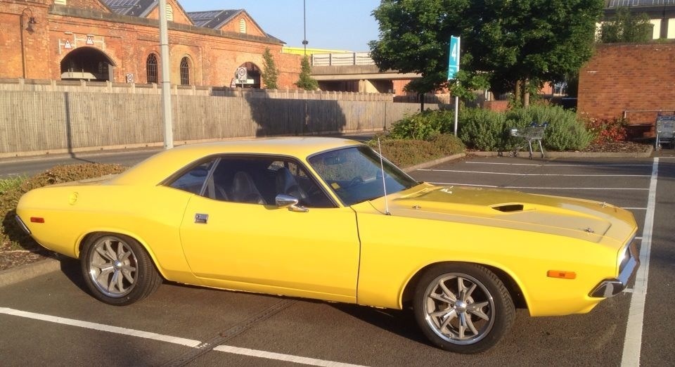

Cannonball wrote:
Adrian Worman wrote:The single biggest improvement you can make to grip and handling will always come from large dia alloy wheels and low profile rubber.
If you want lateral grip in bucket loads you need wide, modern rubber, just trick suspension parts won't hack it without a decent tyre compound, sidewall stiffness and tread width :thumbright:
put your pic up for him ade,y ;)
These fitted pi55 easy Miles, 17X8 fronts on 235/45's and rears are 18X9 on 285/40's, with all that Hotchkis hardware I got on there it handles really well, took on a late C4 Vette in the summer and when he finally caught me waiting at a set of lights he asked me 'how a 40 year old car handled like that'

Sweet Ade! I remember the conversation :thumbright:
