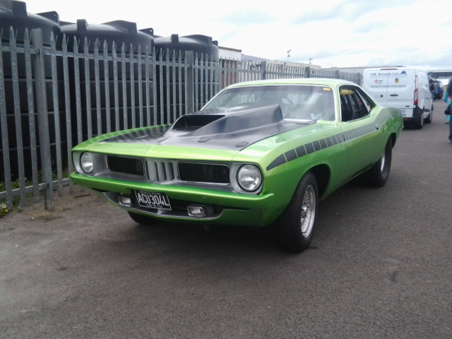

Went over to see Turnip, and the Cuda was broken.....right hand head was off, no piston in one of the bores, but was told, not catastrophic, crank grind etc. and all would be put back together hopefully.
Les
Someone was being optimistic, crank, rods and pistons are all scrap :cry:

Spun a bearing but we didn't catch it before it spread its self through the motor

Sorry to hear that, is the block usable ?

Fingers crossed for you Jon....noticed the Cuda parked up and looking a bit sad on Saturday....you looked busy so we didnt want to bother you
cheers Steve :thumbright:
