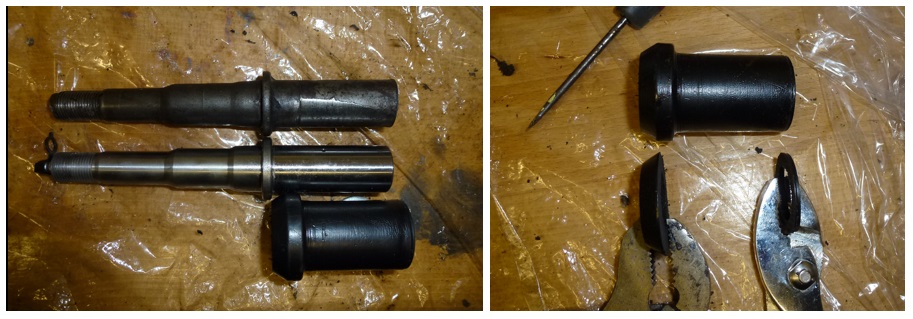

I bought the same pivot shafts and bushes from hotchkis as you did, now my sway bar mountings don't line up, looks like I'll have to trim 6mm off mine as well, has yours been ok since you did it?

Posts: 4262
Yep. Almost glad you found the same thing - Seems odd. But yes, mine are A-OK.
Problem (and solution!) can be seen here. Supplied poly is too long for the spindle. Mushroom bit needs trimming. :scratch:
