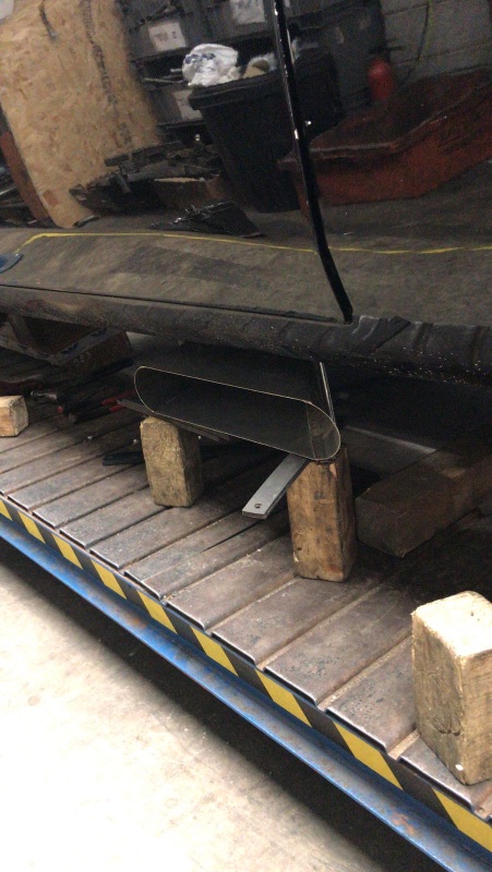

Trying to find some of this Oval tube night mare unless you want 6m of it :(

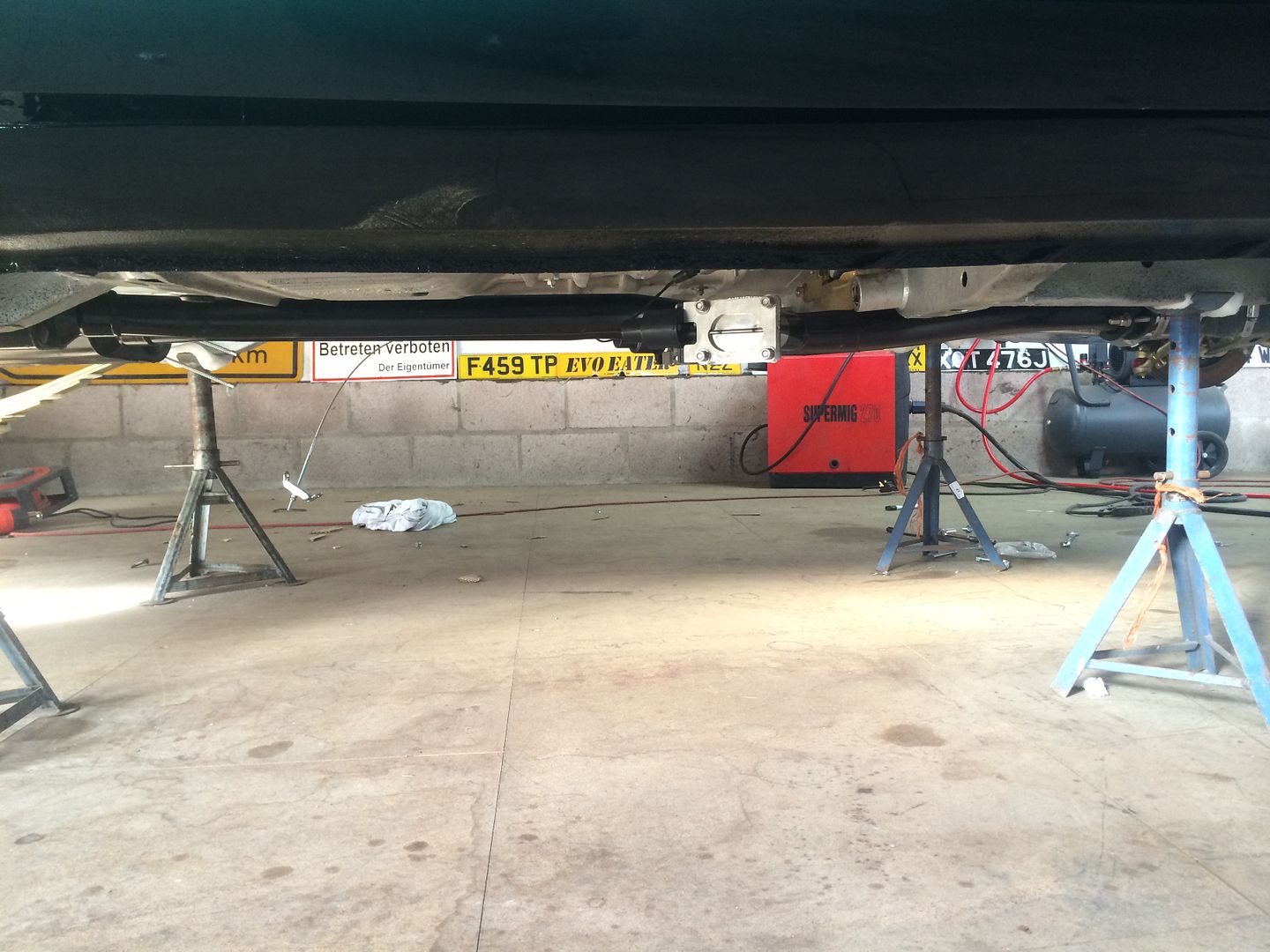

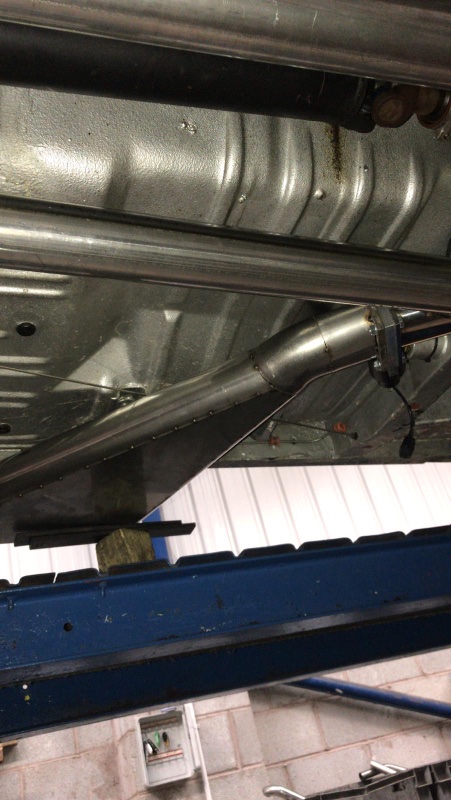

Dave81 wrote:Will........... 8-)
Looks like a tricky route for the propshaft though!
It may be the camera angle, but will it get past those flowmasters?........ :shock:
You got me thinking the same now
:cry:
The rear part of the system is as it came of the car so it should fit :shock:
Not sure what the bore of a standard 383 8 3/4 prop is ?
Been offered a 3inch or 3.5inch prop at prop shop think i will go 3 [-o<

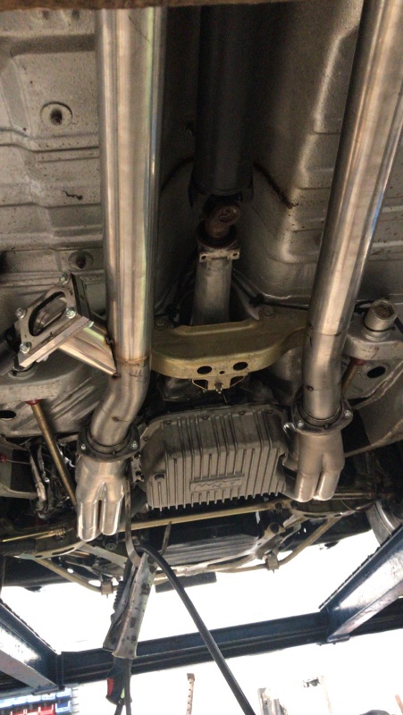

Posts: 22114
Normally the exhaust hangs below the Drive Shaft.
I have got 3" TTI's and an "H" Pipe so it is all pretty grim to get the Prop out but in service there is no problem..........
Re: Exhaust Cutouts/Solenoids
Upgrading my exhaust to a full 3 1/2 system with new horns.
This time the horns are made of 2mm to help with warping
