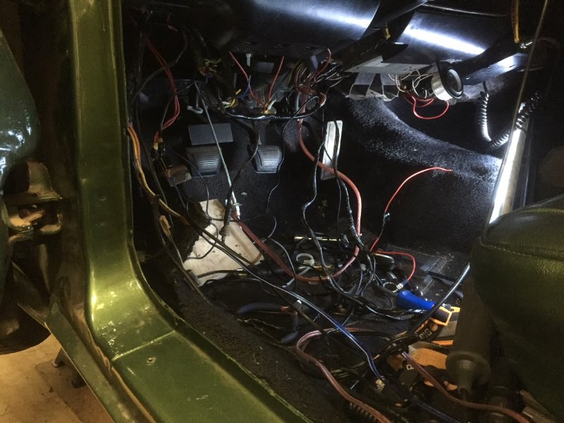

Being as progress ground to a halt on the brakes (Re above) decided to start tacking the wiring ... :? DOn't you just luv unpicking several previous owners hacks and lashups. Going to remove virtually everything and start again
Re: Jimbo's 71 Charger "Snot Rod"
Posted: Sat Mar 03, 18 7:47 pm
by Pete
Best way, really; and probably quicker in the long run too...

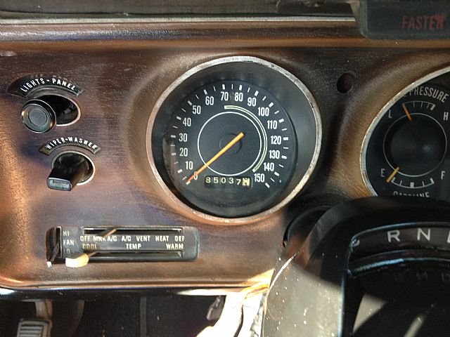

Back to the boring stuff and more wiring this evening, need to remove the dash and pretty much start again with the wiring, such is the state of the hack or wiring.
Removed the HUGE old radio - Its Massive LOL Will keep this in a safe place, but can't see how to pull the rest of the dash out.
Undone the screws at the top and bottom on dash, and its all loose now ... Any hints/tips for next step welcome ?
Posted: Wed Mar 21, 18 12:40 pm
by ScottyDave
Did you get the screws under the speaker grill?
Posted: Wed Mar 21, 18 1:16 pm
by Dave81
If its anything like the A bodies you have to drop the steering column by a couple of inches to get the cluster out.
Have no idea if thats what you need to do on a Gen 3 though!! :thumbright: :-k
Posted: Wed Mar 21, 18 5:42 pm
by ScottyDave
Dave81 wrote: Wed Mar 21, 18 1:16 pm If its anything like the A bodies you have to drop the steering column by a couple of inches to get the cluster out.
Yes I forget about that, you do have to drop the column...can't remember if there's anything else it's been three years since I took my dash out.
Posted: Thu Mar 22, 18 2:41 pm
by MilesnMiles
Drop the column a touch as said. Also need to detach the heater controls and plug too. Remove gently leaning it 45 degrees towards you and then you can unplug the various bulbs etc on back of dash. Might also fine the speedo cable holding it. Ensure it has some free play by pulling the outer cable thru the bulkhead a bit.
