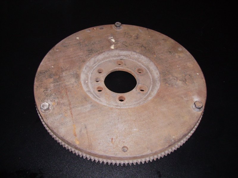

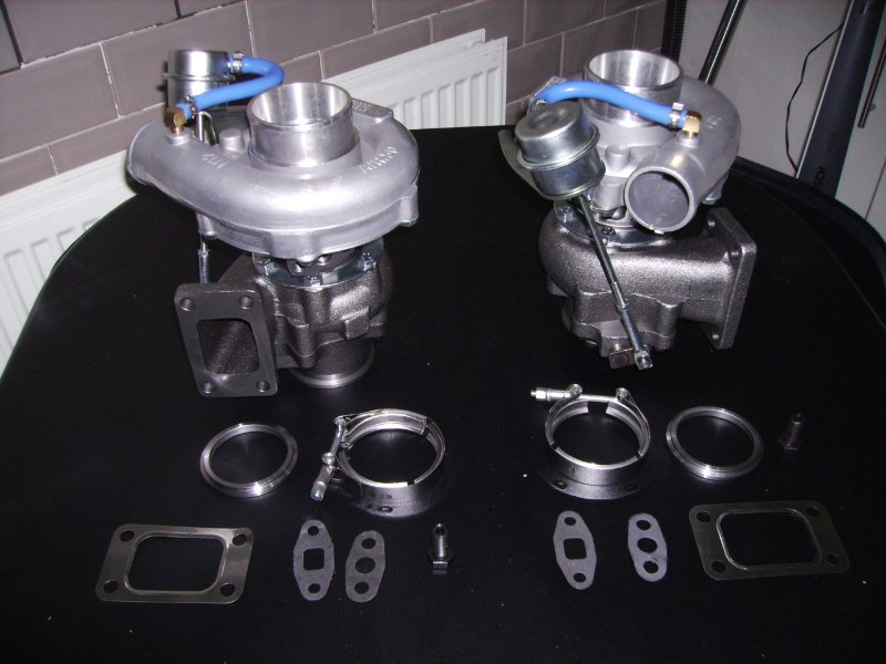

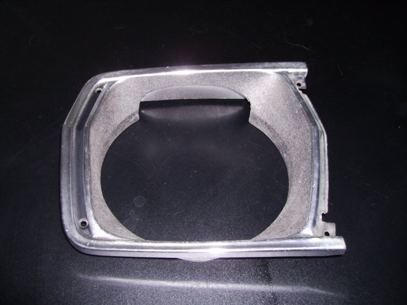

the o/s headlight bezel was here from pennsylvania, the chinese turbos from leicester and perhaps least glamorous but very important the manual flywheel from sevenoaks ;)
just the chinese stainless headers from california and the flywheel balance plate from speedway motors in nebraska.
this really will be an international build, more so if i get some black leather seats from a 'luxury' german anonobox via the breakers :lol:

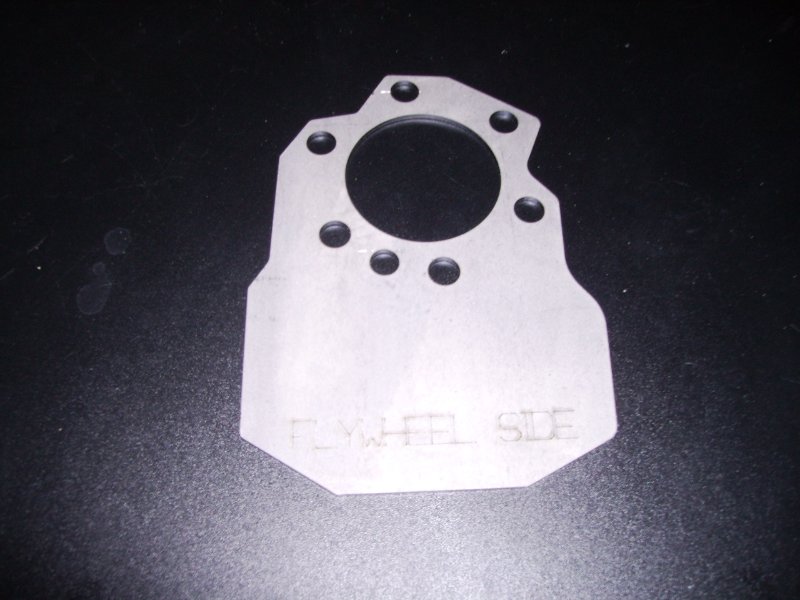

today's delivery was the balance plate from speedway motors. this is sandwiched between the crankshaft and the 350 neutral balance flywheel to simulate a 383/400 external balance flywheel. the advantage is the 350 flywheel is lighter than a 400 one so the engine can rev quicker.

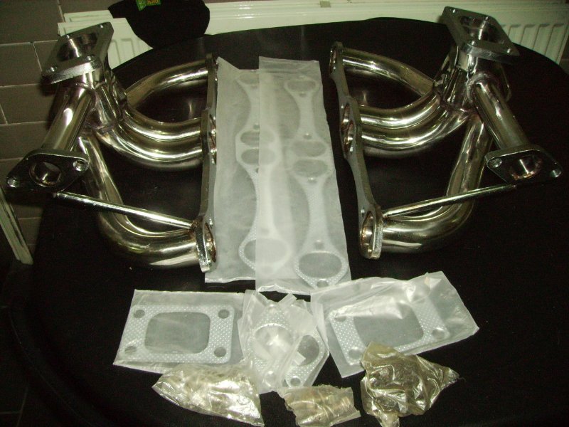

the stainless turbo headers arrived today :D

Posts: 22143
Re: 68 valiant signet 2 door
:thumbright: :thumbright: :thumbright: :thumbright:
Shiny!! 8-)

Mossy68 wrote: Mon Mar 05, 18 10:40 pm Shiny!! 8-)
that was the first thought that popped into my mind ;)
Posts: 2328
Looking good and as said shinny :thumbright:
