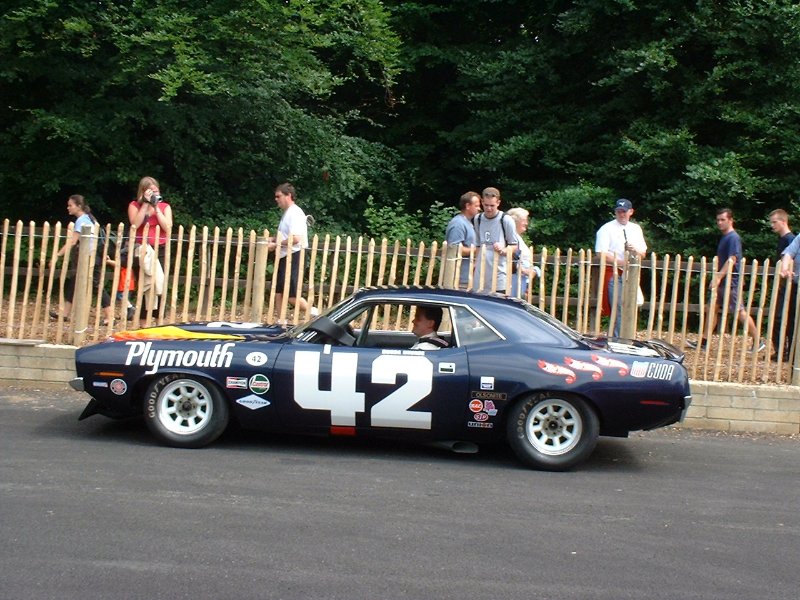

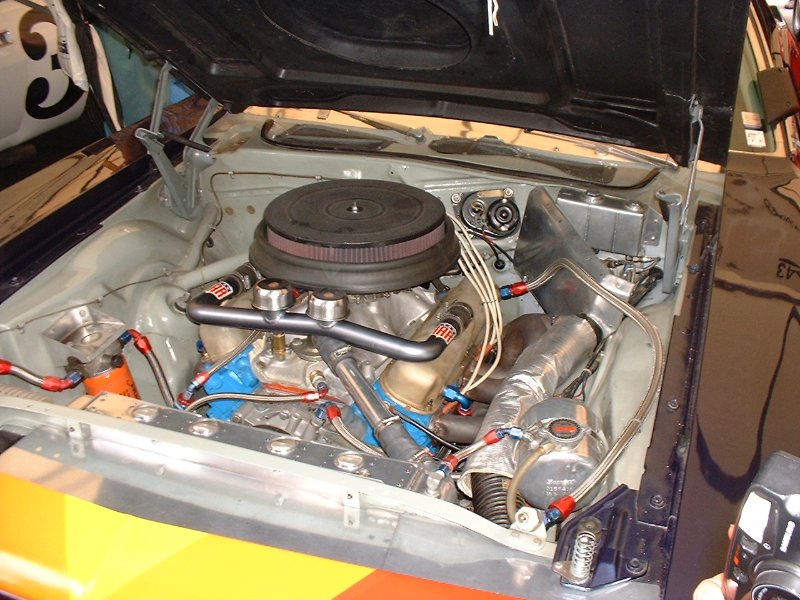

A few pictures of the real deal from Goodwood some years ago! AS Pete mentioned, we were there (in our E-bodies) to meet Gary Savage, son of Swede who originally drove it. Good times, and a great car!
..........................................................................................................^ Gary!

got to love that car and a small block as well 305cu. in i think
Posted: Thu Dec 06, 18 10:24 pm
by Matt
Yes the race cars ran de-stroked 340s to come inside the 305ci capacity limit for the series.

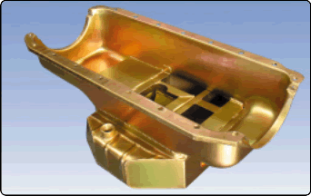

Good luck with the build Matt. The most important part of the engine build for circuit racing is the oiling system as it’s incredible how much oil surge occurs under hard cornering / braking. Also getting the oil back to the sump quickly, you can end up with all the oil up in the valve covers when running at high rpm’s. These problems are often particular to wet sump cars and depending on the regs, dry sumps are often not allowed. To build an FIA eligible car the model would have to have raced in period in Europe as confirmed by the RAC / MSA and have the necessary papers. I know you were not planning on going down that road but there seems to be some confusion concerning what is FIA eligible. We prepared and raced an FIA legal 65 Vette at Goodwood for many years. I also campaigned the 69 Superbee back in the day and that was a real learning curve and fantastic fun. Be great to see another Mopar out on the circuits amongst all those Mustangs and Camaro's. Happy to help if you have any questions.

Good point about the oiling. Dave Billadeau is building the engine and the intention was to use the Milodon pro-touring sump, for which they claim "Full competition baffling is capable of handling full road course use" Just have to hope the oil drains back into it quickly enough, as you say. The fly in the ointment is that the special pickup tube for this sump has been out of stock for about 6 months and the 'available' dates keep getting further away, so we may have to reconsider. It's a pain because I've already bought the sump and it was an eye-watering amount of money. I'm trying to avoid a dry-sump system due to cost, timescale, and complexity.

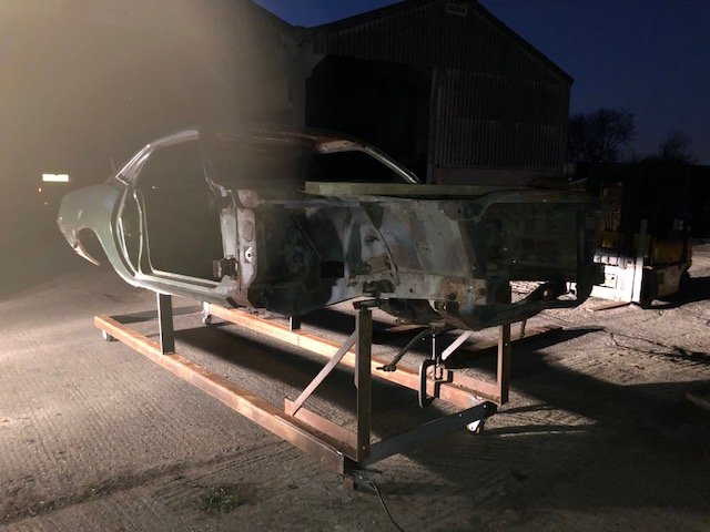

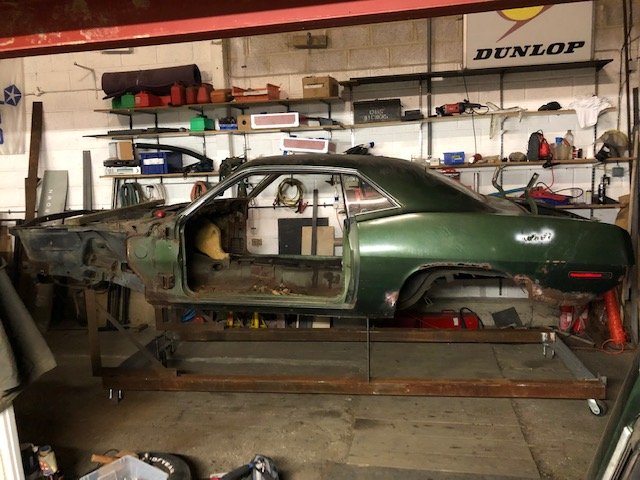

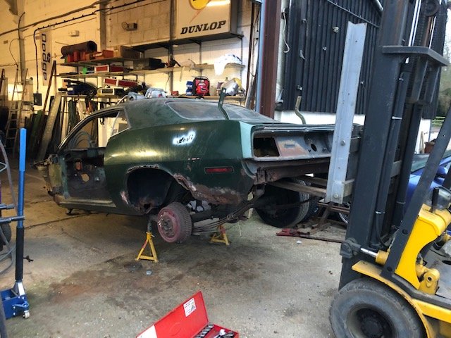

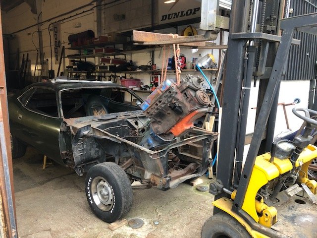

A bit more progress last couple of days.
Stripped the car down to bare shell ready for rust repair.
Engine & box out . 383 not original to the car and probably seized. I have no idea why the sump appears to be on back to front !
Rear axle out
Built a substantial rolling jig to mount the body on. I can make reference jigs from this for positions of frame rails etc as most of the rear sheetmetal will be cut out for replacement.

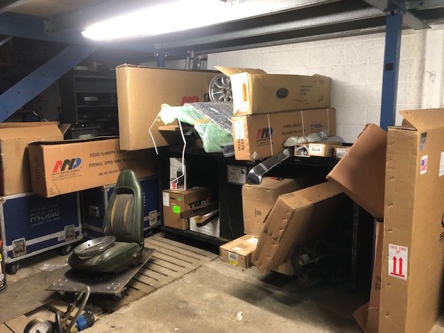

Got all the sheetmetal ready to fit, although I've now decided that the whole front floor pan will need replacement so will need to order that separately. A friend can call in a favour with an airfreight company so it should be with me soon, and cheaply.

That IS fast work, big stash of new parts already, is that a minilite in the pile too?

I one of those sumps on my 408 cu.in. and one one the 340 T/A expensive but they will make sure you always have enough oil :thumbright:

Ive just put the circuit race sump on my 440 sixpack engine in the coronet,nice piece of kit.

Same sump on my 440 blower engine. If I’m correct the pickup was treaded to larger hemi size for the pickup.
Seems to work well !
