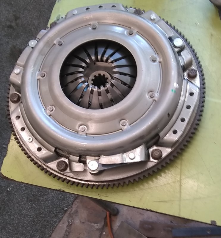

Ok I need a 10.5 clutch,
Doe's anyone have a 10.5 pressure plate at home in garage, they could give me a dimension please
Am looking for the inner dimension of a 10.5 pessure plate :read2:
TIB3300
Posts: 631
Location: Sheffield
Re: Small block manual Clutch help
Post by TIB3300 »
I know I have posted this info in my build but just incase someone wants it ay a later date
All from rock autos
All bolted to 10.5 Dodge flywheel
Dodge MU16751G {#90314}
10-1/2" Clutch; Diaphragm Style
1999 V8 Mustang 381021 10-1/2" X 1-1/16" X 10T

you have about the same amount of meat around the cover plate bolts as i do with a 10 inch holden v8 clutch on a flywheel designed for a 9.5 inch aussie mopar clutch
its worked fine for me..although derek was heard to say how the hell do you drive that in traffic, the weight of that clutch is horrible....
you get used to it....
