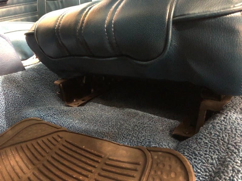

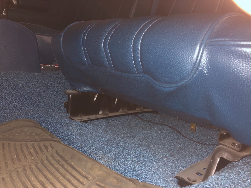

Re: Bench to Buckets.....
Here you go, mounts inside the hump.

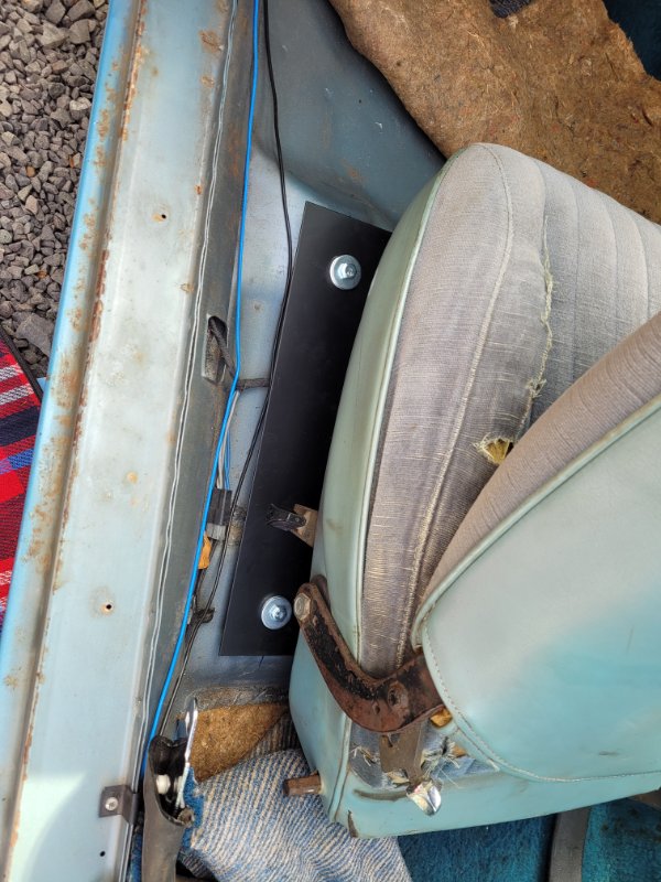

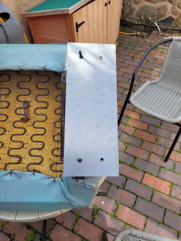

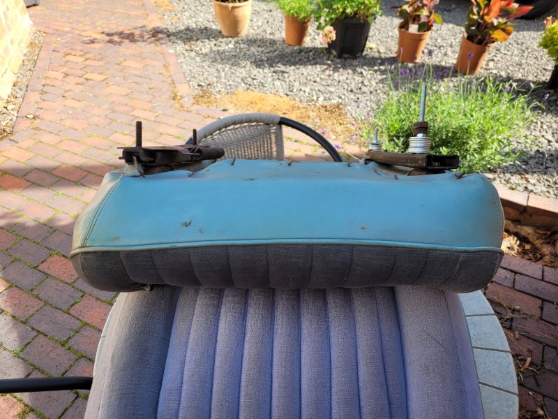

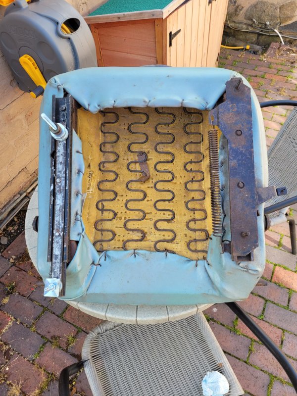

I spotted the factory dimples today for the buckets....I needed the Z bar, which I haven't got.
So ordered a lot of steel plate in various measured sizes and set about relocating the seat 60mm towards the transmission tunnel.

Went for a test drive.....much better albeit a bit lower than when i had the bench. Feels good though. Will do the passenger side when I can be bothered, it only the two strengthening plates to do on that.
