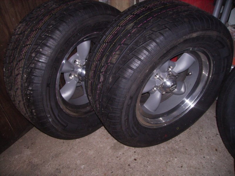

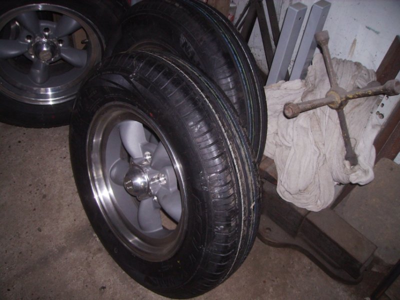

we went to the nsra swapmeet today and i collected the torque thrust wheels. we can fit the new tyres now. i also got a used late fe 3 bolt starter and a nos windsor one which will work by swapping the nose from the fe one if it ever fails. i bought a matching late 184 tooth flexplate from ebay this evening so that issue's sorted. i checked rock auto last sunday for distributor prices and bought a repro single point one for £69 including shipping etc so was very happy with that. the last thing i needed was a carb but as ashley bought a tunnel ram and 2 carbs for his 440 today i'll have his holley 750 vs for the nash.
neil.
neil.
Re: '58 (nash) rambler american family project

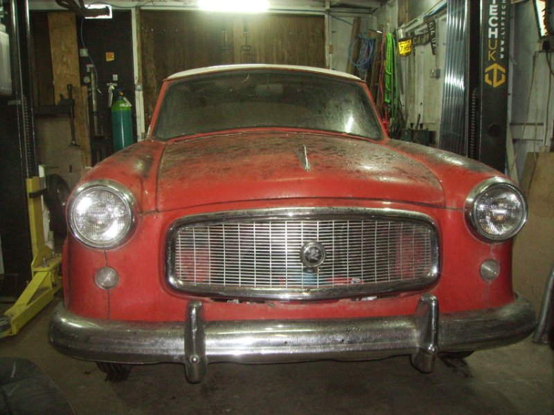

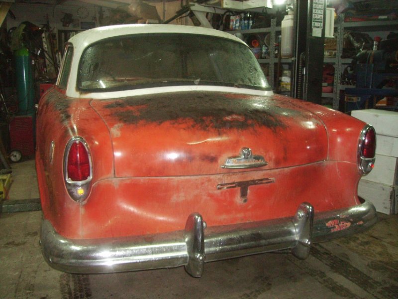

well that's the wheels and tyres all ready. we just have to build a car to fit them to now
and it's been a while but here's a reminder of what we're building, lol
neil

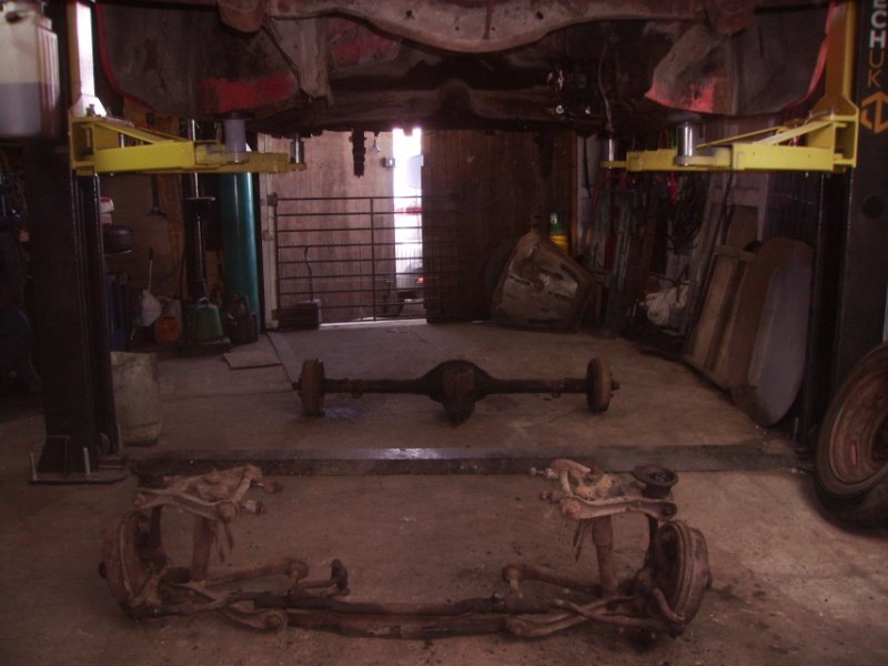

well, there's no going back now
the back axle, fuel tank and complete front suspension is out and on the floor. so it's not coming out until it's on it's new wheels, suspension, axles etc.
everything came undone with no snapped bolts which was a bonus. i reckon the tank will be reused, it just needs a dent popping out and 2 spiked holes welding where i guess the old fuel was 'drained' before shipping .
the steering box/column etc will be next then we'll start offering up the straight axle

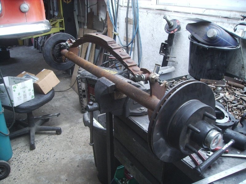

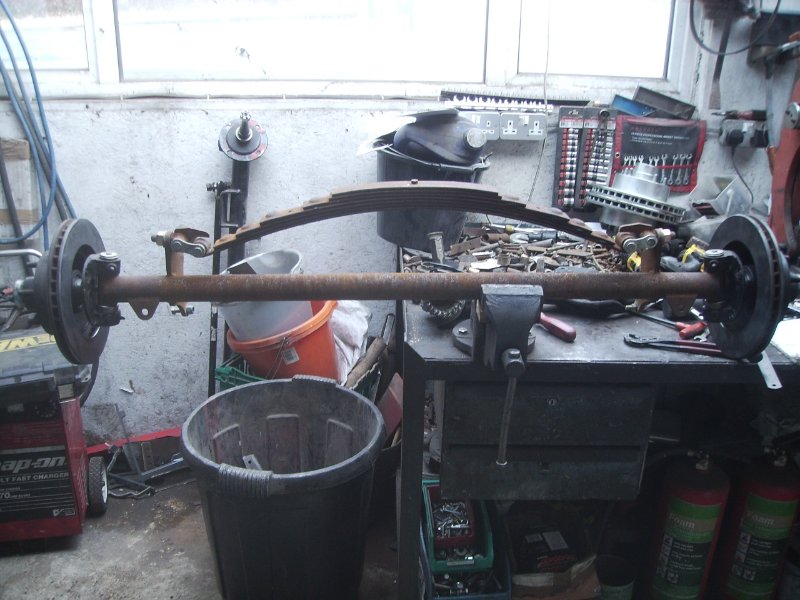

today we dissassembled both front hubs and ashley's axle. we cleaned the surface rust from the discs with a twist knot cup wheel on the grinder, vicious things they are. odd wires fly out and dig in you, even through clothes. anyway the hub swap was straightforward except the inner seals were about 5mm different inner diameter but they swapped over easy enough. next again the surface rust was cleaned from the axle bosses so the new kingpins slid in nicely with their thrust bearings and shims as required. the hubs are now on the spindles and that's where we are to date.
neil.

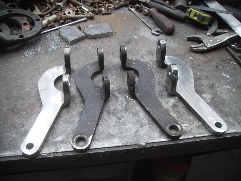

ashley's axle came complete with all the steering arms etc whereas mine is pieced together from parts. so although we could've used the pair available and sorted ash's later it made sense to do them now. we sorted a lump of 1/2" plate and drew around them before cutting them out with slitting discs and a drill for the corners and roundy bits. clamped together we ground them the same before drilling them again clamped together. lastly they needed nice tight 90 degree bends which isn't possible with either my folder or the hot spanner. so we cut 1/2 way through, bent them in the vice then welded the corners back out to the same thickness. another grind up and some primer and gloss black and they're ready to fit.
neil.

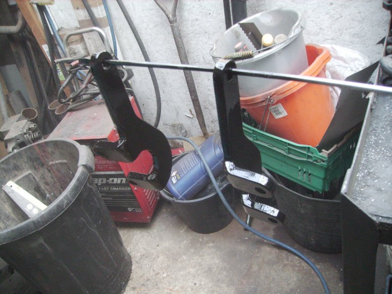

cheers Dave, yes it'd need to be some kind of jumbo press/folder to put tight 90 degree bends into 1/2" steel plate that's for sure.
today we got all the hodge podge of parts together, well we did after some relieving of the new steering arms to clear the caliper brackets anyway. then with the box of rod ends, nuts, bolts, washers and top hat spacers from rally design found we made a track rod. the paint's drying on that now. lastly we cleaned the threads in the hairpins and screwed rod ends into them before bolting them to the axle too. it'll soon be time to offer it all up under the front of the car.....
