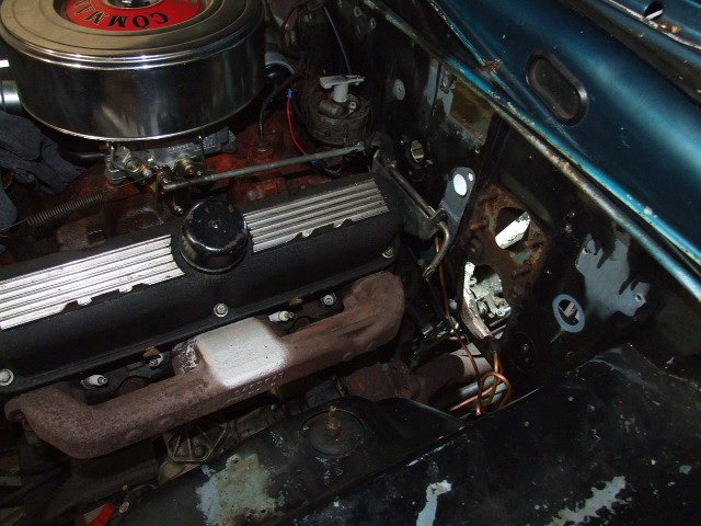

part way through making the frame connectors.
but while the floor is out i finished the gear linkage (note the awesome hacking of the floor)
changed the lower worn rubber/brass bushed mount for a 1/2 inch rose joint and rose jointed the remaining linkage. now has zero play and a very positive feel when selecting gears.
another issue i could feel when driving the car home was that the throttle was heavy anywhere over 1/3 throttle and extremely heavy nearer full throttle. Inspection of the linkage determined that the quadrant on the gearbox went to a dead straight position and wouldn't allow for actual full throttle and was just trying to bend the linkage. The secondary choke only opens at the last 1/4 of throttle movement.
possibly due to the Edlebrock carb' linkage changing the position of the quadrant no adjustment i tried was going to work? Cut and welded one rod attachment point on the quadrant to change the pivot angle so there is more adjustable angle to play with and re-adjusting the rod lengths now has full throttle and a light linear pressure to the throttle linkage and kick-down lever.

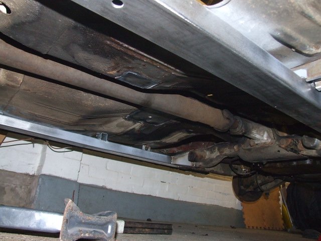

Frame connectors in with just a few more welds to finish. Reason it took so long was that with a conversion like this you always need to think 5 steps ahead and look for reasons why something cannot be done.
so i had to mock up the RHD stuff to mount the handbrake to see where it'll need to go through the chassis to mirror how it was originally fitted.
the hole in the side of the right hand frame connector is for the handbrake cable to go through. if i had not worked that out it would have meant a complete redesign of the handbrake linkage.
also i have made brackets for the outer seat mounts and will still need to make u channel brackets for the inner seat mounts to attach to the frame connectors. the floor moves so much and cracks otherwise. (hence the repair on the left hand inner seat mount.)
