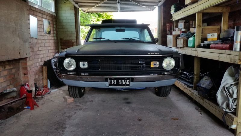

Front end all complete and back together for now:
Hood will be sorted in August and maybe on for the HRD's.
Another target date set and missed though...........The car wont be at the NATS this year. Due to varying factors (it isn't exactly road legal with its issues), and my lack of trust for it, I'd rather get it sorted and right before I embark on a 200mile round trip.

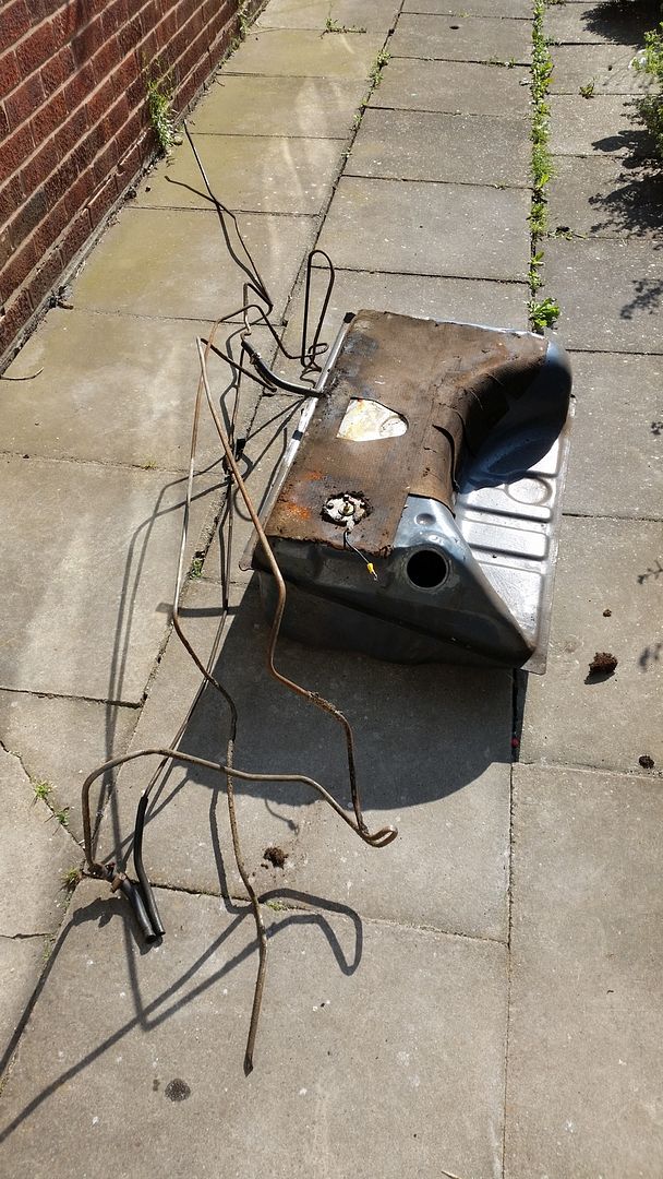

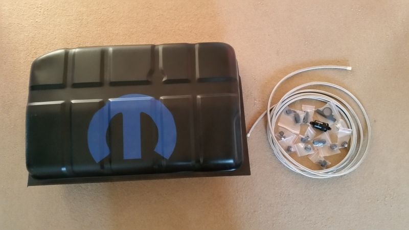

One of the issues is this car has been bodge city in some part of its life. The biggest one being the fuel system. This has resulted in varying issues including closing down a petrol station and having it evacuated. So with a brand new cooling system sorted, I'd like a new fuel system next!
Time to drag out the old Bananarama! (please note bodge #114 Fuel tank sender modification) :roll: :

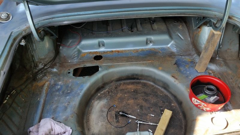

Like I always do I add stuff to the list as I go.......sand the trunk floor (only surface rust):
So to fit: New Tank, New Sender, New tank Straps, AN6 Braided Teflon fuel lines c/w inline 30 micron filter from tank to fuel pump and new braided Teflon from pump to carb.
Plus, AN6 braided Teflon hose with one way valve (negative pressure) on the vent line. I've decided to add a small air filter to the end of it to try to eliminate dust and debris being sucked into the tank.

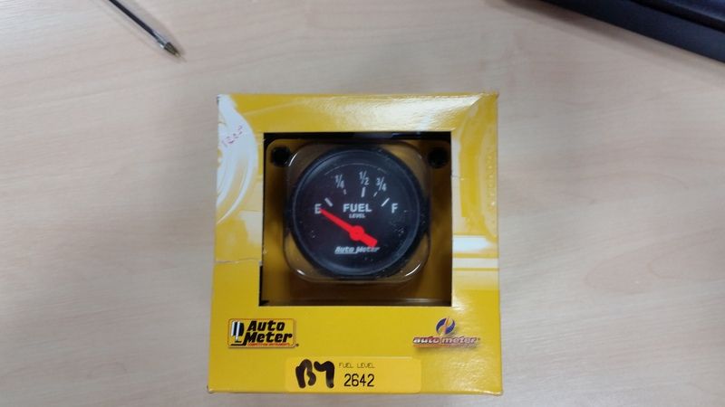

One of the issues was the new sender was erratic on the stock fuel gauge and over reading on the aftermarket. Did a resistance test and it was saying 73 ohms empty and 3 full (Chrysler is 70/10). so I knew that wasn't the issue. So I've ordered an Autometer replacement for both that runs in that range!

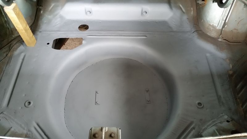

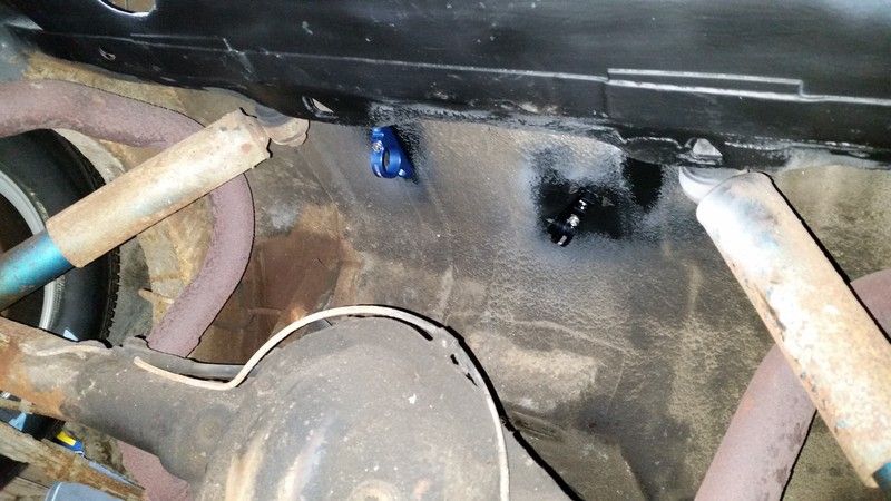

Lots of sanding in the Trunk, then some primer for protection:

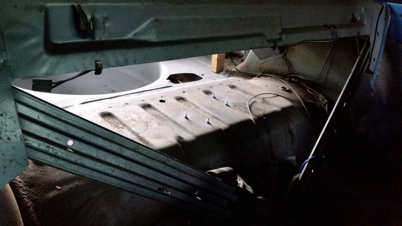

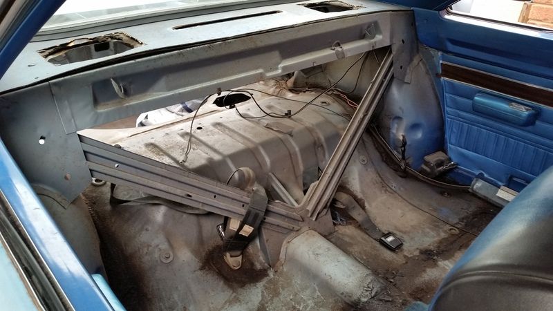

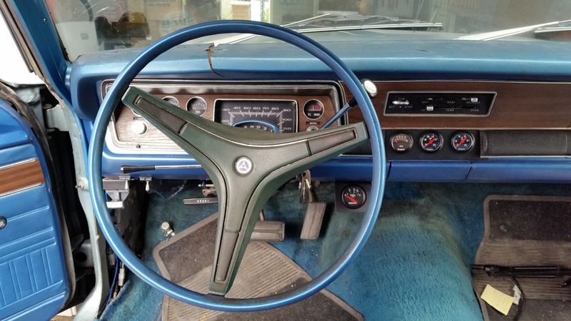

Mounted and run the new wiring for the Fuel gauge. The nasty dash mounted one is now in the bin (Makes the interior look a bit more tidy):
To run the new wire front to back I had to remove some trim.........:help:

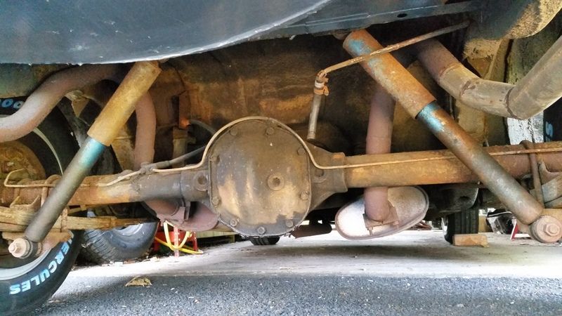

The factory underseal set like concrete and explains why this car is in such good condition underneath. Had to sand it down to get a flat mounting position for the new fuel lines.
The blue ring is for the vent line and will consist of one way valve, plus filter and braided hose.
The black ring is for the actual fuel line. This will follow the stock route, but will have a 30 micron filter located at the rear (away from heat source). I also much prefer being at the back (no puns intended), so locating the filter hear makes it easier for gauze replacement and making sure the connections are tight:
From the trunk:
Ran out of time and energy to do more than that......Next stop...Fuel line! :thumbright:
