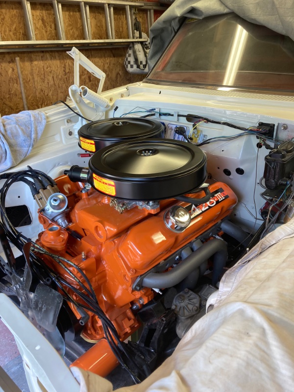

After a deep google its seems its advisable to run a vacuum line between the two carbs and into the back of the inlet manifold ,also need another line from one carb base into the valve cover breather ,so these little bits are in the post as we speak ...I have a small problem with the convertor but that also will be dealt with and when that gets sorted it will be put in place ... So its just a waiting game now which is sometimes painfull . Another thing i have been advised to do is run a fuel regulator which i did not want to do as i wanted a stock look but sometimes you have to bow to superior knowledge ..so i will take the stock fuel line out from the mech pump to the carbs and run a new line into the regulator .Putting the stock line away for the future ....so anyways here is a photo of it all mocked up with the stock fuel line in place ...

Posts: 14656
Re: 64 Plymouth Belvedere post car
You could fit the regulator in place of the T piece and to the untrained eye it would still look stock…
Posts: 14109
Aye, 'tis a thing of beauty :love10: :salute:

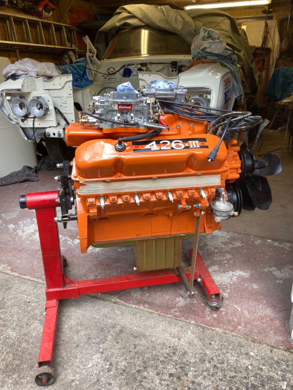

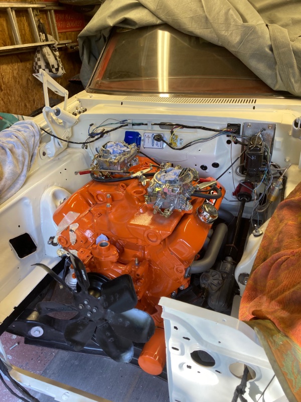

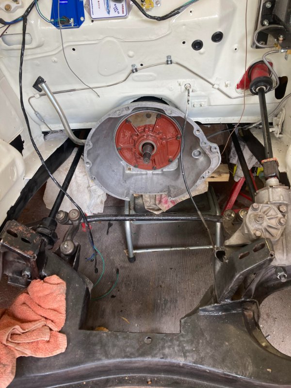

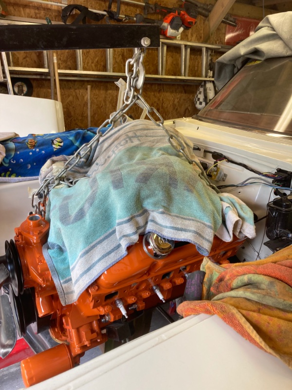

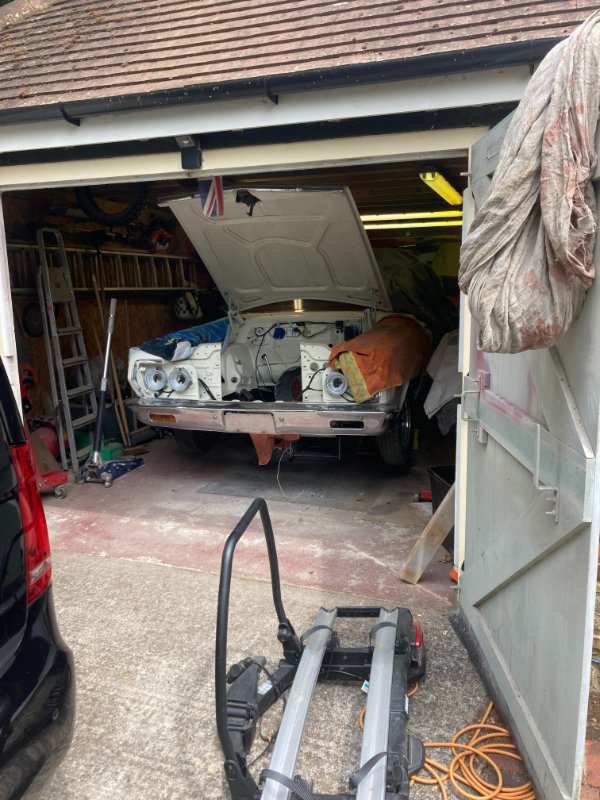

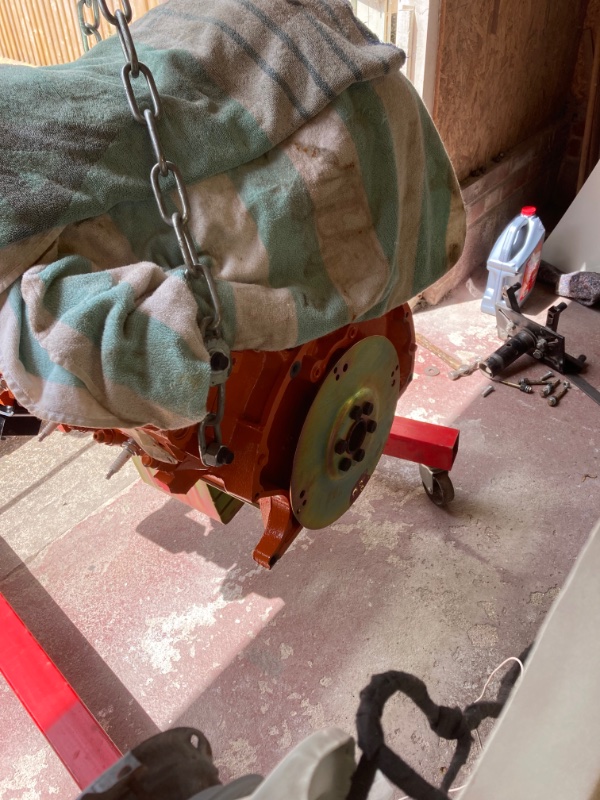

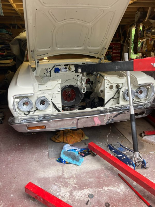

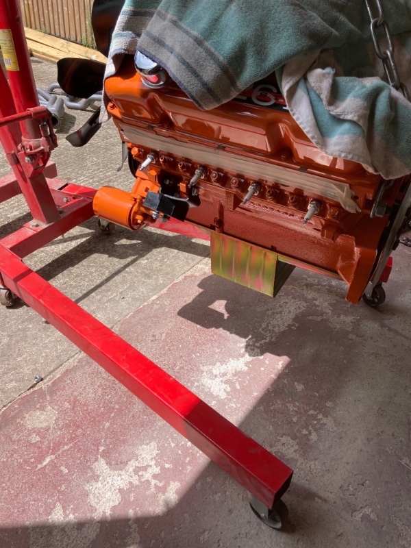

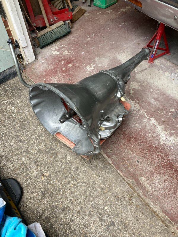

Finally got some parts to carry on ..i would have put the engine and box in together but this engine is big and bulky with the inlet on so i decided to break it down into bits ....Got a few little jobs to do but the engine should be in next weekend .....

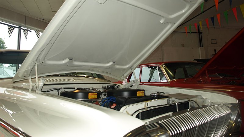

Have you checked yet whether your air filters will fit under that stock hood?
Usually, if not always, the bracing on the underside needs cutting to clear the filters on max wedge style inductions :-k :shock: ;)
Eg:
pete walton
Posts: 1403
Post by pete walton »
I did a trial fit but you got me thinking now??? ...I do have a spare hood which i was going to butcher for a hemi style 64 scoop ....stay tuned we will find out this weekend
pete walton
Posts: 1403
Apart from a non compatible throttle cable it all fits as planned
