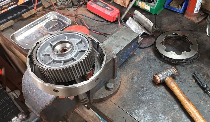

Post by Johnny Dart »
I'll have a look at my parts 727, and see what drum that has.
Johnny Dart
Posts: 946
Re: Johnny's Dart repairs
Posts: 14656
Just make sure the other drum has the same width bush, thin and wide bush drums do not interchange as individual items.

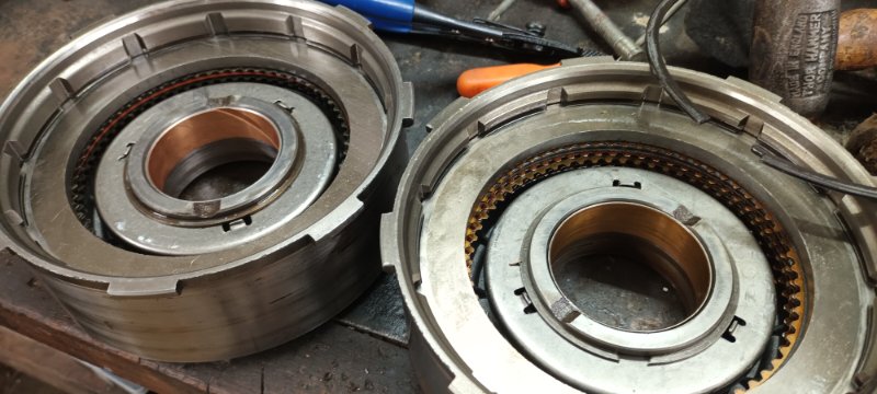

That's lucky , the spares 727 has a big bush 4 plate clutch housing , so u can use that.

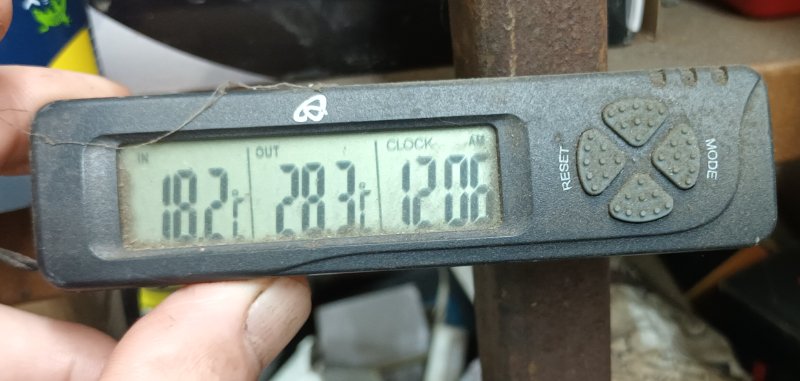

Cool in the barn today, 10 degrees different inside to outside.

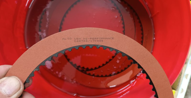

Front clutch drum done, on to the rear clutch drum , new plates and steels, bush and seals 🦭
Johnny Dart
Posts: 946
I failed to take a pic of the front clutches, but they are also alto red material and kolene steels.
That's the rear clutch built up.
I think that will do for today 😊

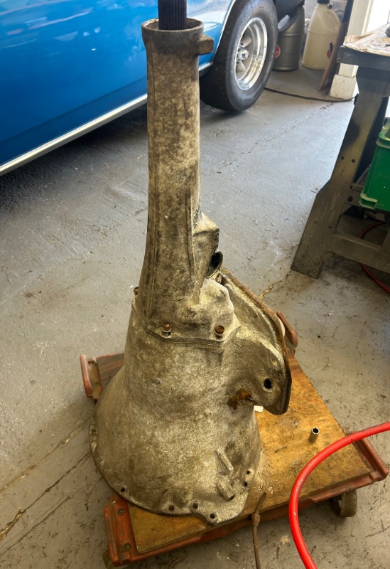

Posts: 14656
Hah, I’ve been making a start on this fine specimen this morning….
