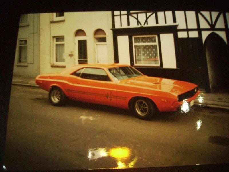

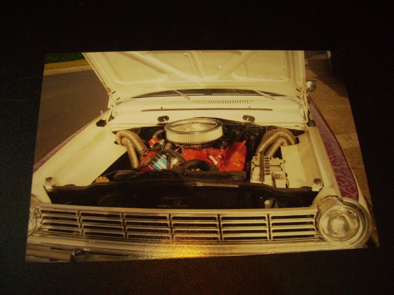

this afternoon dawn (the wife) was tidying cupboards in the loft and found some old photos. i had a look and here's some of the 74 challenger and the 65 dart i had.
the challenger was i guess an old race car when i got it, very 70's with radiused rear arches and jacked up all round. i used mk2 escort estate front arches on the rear, made lower 1/4's from sheet and cut a mk1 cortina sill for the rear valance. i lowered it stupid low and had to fit a 1/4" skid plate under the driver side header as it was only 1 3/4" off the ground (skid plate reduced that to 1 1/4" but it was sacrificial). the 14" wheels didn't help either. i carpeted all the inside as it only had the 2 front seats. it was a 318 car with some tuning bits, 340 heads, cam, victor inlet, double pumper holley, headers and a full gold moroso dress up (it was the 80's). it had the full gauge cluster, was a console bucket seat car with factory ratchet shifter (slap stick?) and lsd and the vented hood. again, it was the 80's so excuse me the heartbeat graphic stripes i painted on it in cellulose as was the orange itself (lots of flatting and buffing by hand :( ).
next the 65 dart, originally a /six car i fitted a 440/727 and went for a super stock vibe. i spent 3 days making the fenderwell headers which had 36" long 1 3/4" primaries. the rrear axle was from a dodge diplomat and the rear arches were from a 90's transit. the body was very rusty so we spent weeks after work replacing the rot before i gave it an off white paint job and burgundy stripes with gold lace over them. not forgetting the name, a race car's gotta have a name right? i had the bench seats retrimmed, i made new door cards and fitted all new door/boot rubbers which made it a lot quieter.
IMG_0004 (1).JPG (71.97 KiB) Viewed 1722 times
IMG_0006 (2).JPG (79.23 KiB) Viewed 1722 times
IMG_0007 (1).JPG (81.25 KiB) Viewed 1722 times
IMG_0008 (1).JPG (86.93 KiB) Viewed 1722 times
IMG_0005 (2).JPG (82.93 KiB) Viewed 1722 times
