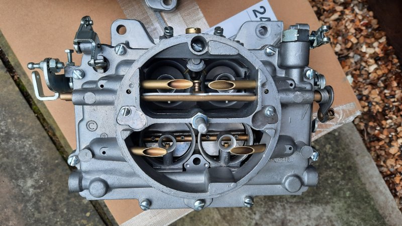

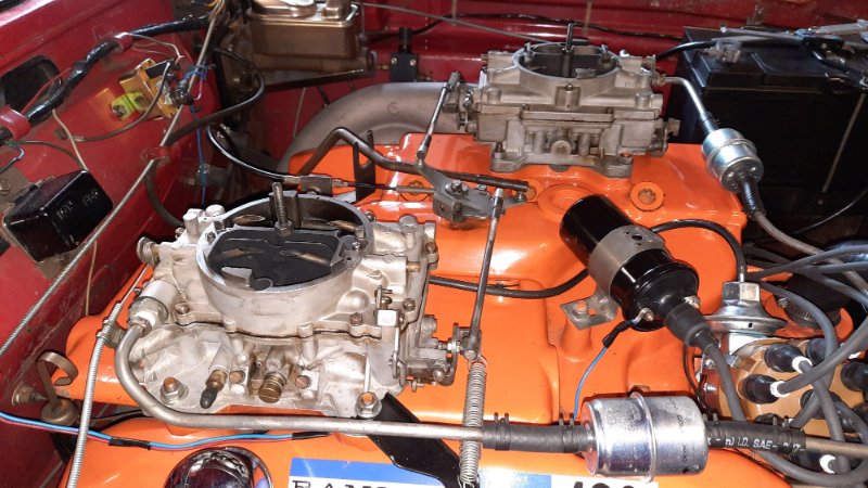

So... a couple of months back we got to the point where we realised our original (to the engine) carbs really could do with a proper rebuild. They were supposedly rebuilt 20 years ago just before we bought the car but judging by how the rest of the engine was thrown together, they probably just had a rudimentary clean up at best :roll:
As no one we knew wanted to get involved we had to take the chance on finding someone ourselves and settled on the safer option of a UK company rather than shipping them over to the States or Canada. Best option we could find was Coln Engineering down in Gloucester. They had some experience with Carters which is quite a rarity over here so we took the plunge and dropped them off with them the week after Easter.
https://www.colnengineering.co.uk/
After discussing what we thought was needed, and what they could offer, we agreed to have them disassembled, ultrasonic cleaned, spindles rebushed, steel parts replated, reassembled and bench set-up and tested. We supplied a rebuild kit from Mikes Carburetor Parts https://www.carburetor-parts.com/
which arrived within a few days and a screw kit from Laysons Restorations
https://www.laysons.com/
which took a few weeks... true to form, but at least it arrived! :lol:
I'm still waiting for any photos that Coln took during the strip down and rebuild but here's an idea of what we started with...
Then after 5 weeks (3 weeks waiting and 2 weeks work) they came back good-as-new 8-)

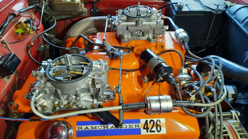

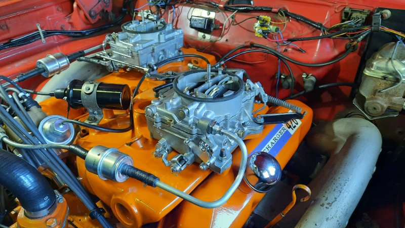

Then today, with the help again from MMA-mate Ian, we got them fitted with new fuel lines and spent a bit of time (understatement) setting the idle mixtures and getting them balanced.
Then on the 2nd turn of the key 'she' started right up and was idling smoothly within a few seconds - rather than the usual few minutes after a few turns of the key!
Road test started off well too; no stumbling or pinking under load, but after a while we did notice a bit of hesitation under load :-k

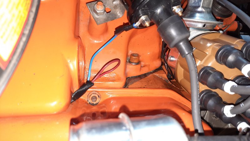

Back in the garage, earlier suspicions of a vacuum leak were confirmed by spraying some WD40 and brake cleaner around the base of the inlet, in the only place it's accessible (centre of this photo, where the inlet meets the head). We confirmed there was a leak using the the rubber tube in the ear method - we could hear a similar noise to when we put the other end of the tube in the carb, for balancing :shock:
So just when we thought we were all set to use it for Brooklands, we now need to replace the inlet manifold gasket(s) and may as well do the valve cover gaskets while we're at it as they are tricky with the inlet in place.
