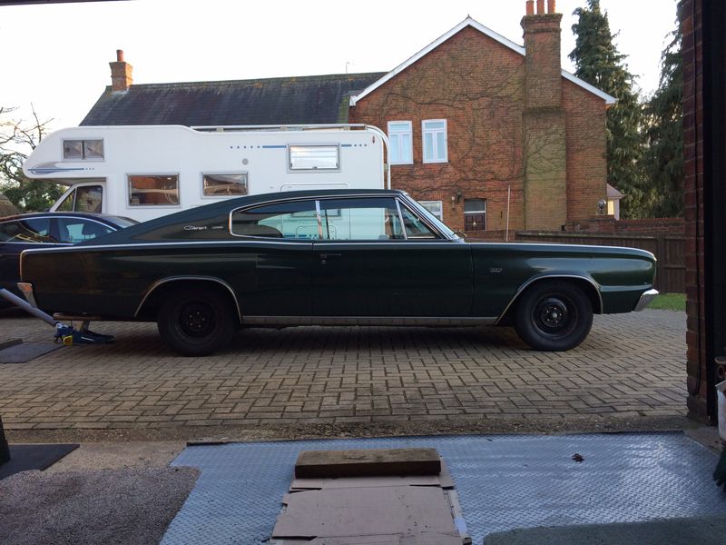

I've been having a bit of an experiment with heights. This is as it is now

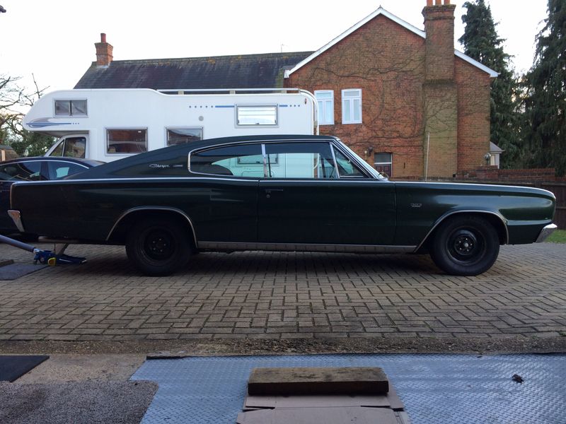

Measuring at the bumper, this is 1 1\2" lift

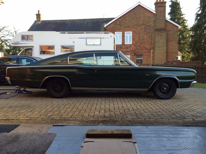

And this is 2" lift
Considering I would like to raise the front up a little 2" would be great on the rear.

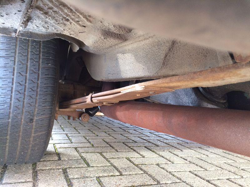

This is a better view of my springs. Should that top leaf be bending down slightly as it passes over the end of the 2nd leaf?

2" is too much IMO. Don't need a rake on that design. 1.5" for me.

MilesnMiles wrote:2" is too much IMO. Don't need a rake on that design. 1.5" for me.
I do want to bring the front back up a bit as it's quite low at the moment. I dropped it down as I couldn't see the road/cars behind through the mirror due to the rear being low and the rear window although is huge it's at a very low angle.

XP29 wrote:Measuring at the bumper, this is 1 1\2" lift
And this is 2" lift
Measuring at the bumper you’re going to get a false reading
Maths and angles and stuff
2” at the bumper is probably only about 1.5” at the wheel arch
Measurement at the wheel arch, that’s what you would need to give to your springiest if you’re having them re-arched
I like what you’re doing btw
Personally I would go slightly up on what your ideal would be as you just know they’ll settle in time

Small jack between the axle & chassis rail and lift the body without taking weight off the tyres. Tyres will sit a good 1/2 to 3/4 inch higher if you jack just the body and take the weight off them.

Cheers guys. Just looking at bits from Summit. I've decided to replace rear shackle, front bushing and get the add a leaf. I'm going to have a go at it myself, it's pleasing being a complete novice accomplishing stuff on the car. If this gives me what I want great, if not I'll go the re-spring route. Annoying thing is Summit have a 2 week wait till the bushing set come in.

looking at your spring I would say they need reshaping so while you are waiting it may be worth doing.

Yes tat top main leaf is a concern. What is the rough cost of having a pair redone at some where such as Brost?

You'll also need a spring kit of new clips,sliders and interleaves.
http://www.manciniracing.com/lespreki.html is an example,shop around prices vary.

latil wrote:You'll also need a spring kit of new clips,sliders and interleaves.

I'm trying to weigh up cost of having mine redone compared to new springs. I think new XHD springs are about $130 each, so guess around £260 to get here. How much is re-doing springs roughly here?

To re-arch and re-temper is around £200 and to add and extra leaf is about another £40.
those interleaves are galvanised steel the originals were just solid zinc
with only a few microns of zinc they don't work very well
get some of this
http://www.ebay.co.uk/itm/Preweathered- ... uJVekqFWdw
cut to width of spring
drill hole in 1 end for the spring bolt
hole should be exactly the length of one of the plastic sliders in from the end, and in the middle of the strip
put between springs facing forward
trim to length necessary
job done
no need to lube springs zinc against steel is self lubricating
the plastics can be purchased as a separate part.
