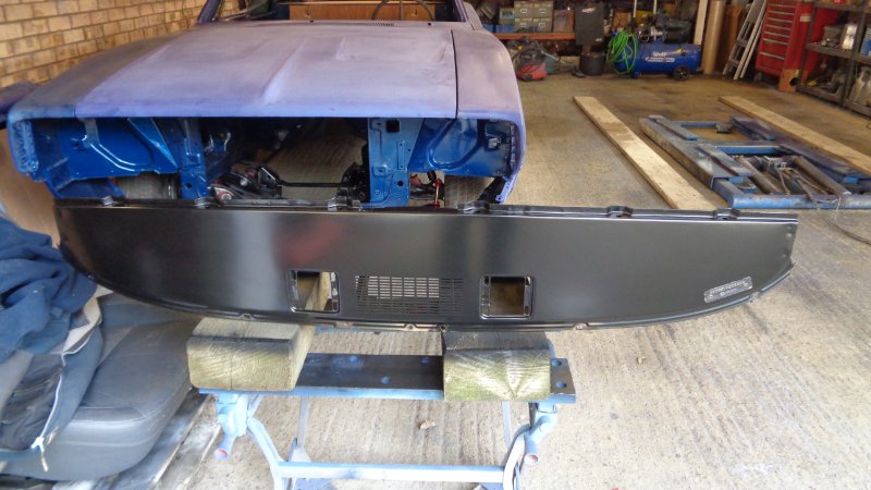

dash was taken back to bare metal ,we didn't remove the vin tag as we wanted to leave the star shaped rivets in place ,
sprayed the dash satin black , yet more money on new vents

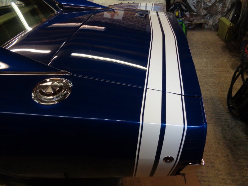

stripes arrived and fitted

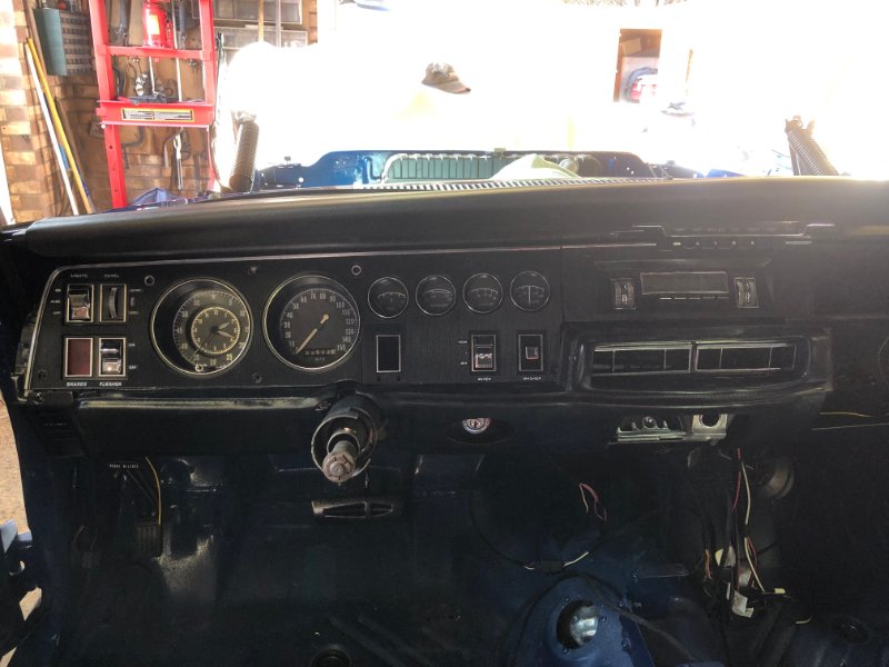

dash in just waiting for the chap to come and fit the new front screen

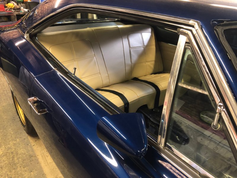

the long awaited fitting of the back seats
,starting to see the light at the end of the tunnel now

now i wish i had checked them other gauges as the water temp and oil pressure are not working
clocks out again and after a quick phone call to someone the make sure i have got it right about how the check each gauge, and both gauges are dead.
the time clock works but dose an hour in 5 minuets ( i think that may be a bit fast ) with the clocks out strip the time clock and adjust the speed to slowest setting
on the net again to order replacements

the new water temp and oil pressure gauges fitted and the dash back in place , sort out the center console wires ,carpets down and front seats in after a bit of trouble finding the holes , the same with the throttle peddle , drain down the rad and add some antifreeze ,start up and let it get warm to mix that antifreeze . very good oil pressure and temperature stat opens at correct temp . that bloody time clock is still running way to fast so disconnected for now , need to look into that some more. still got kick panels and sill plates to fit
Re: 68 charger project
Posted: Mon Nov 04, 19 10:34 pm
by Derek
The clock in my Charger ran fast for a few years, I read somewhere that to slow it down you have to wind the clock backwards around 24 hours while it's connected, I did this and the clock has been fine for years now.
