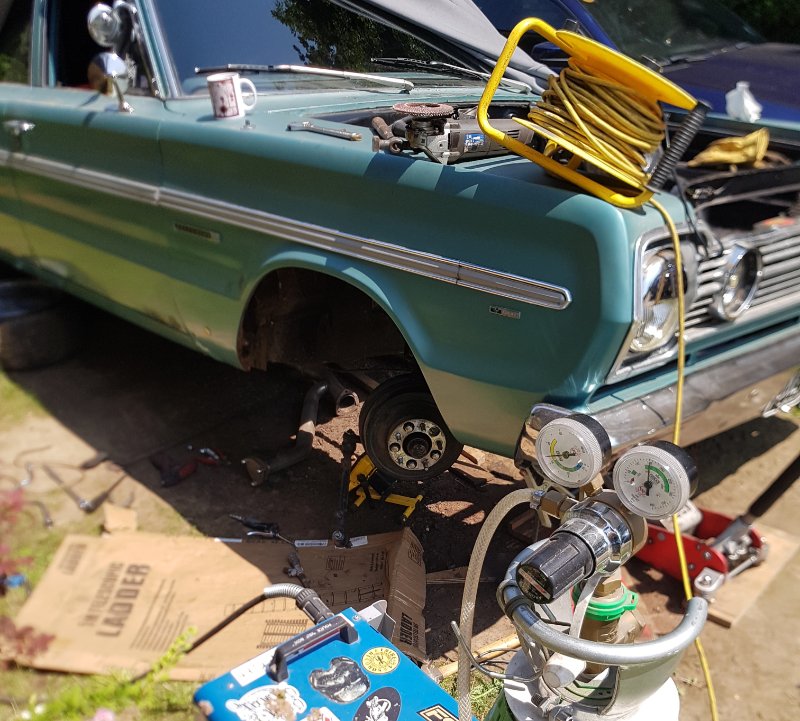

Posted: Tue Jun 23, 20 8:00 pm
by deppmobile
Sorting out a couple of holes in the chassis leg way laid plans for the engine today :cry:
I reckon this wagon had lots of fun at the beach in its time considering how much sand came out of the chassis leg! It just seemed to keep coming!
Back to the engine tomorrow I hope :thumbright:

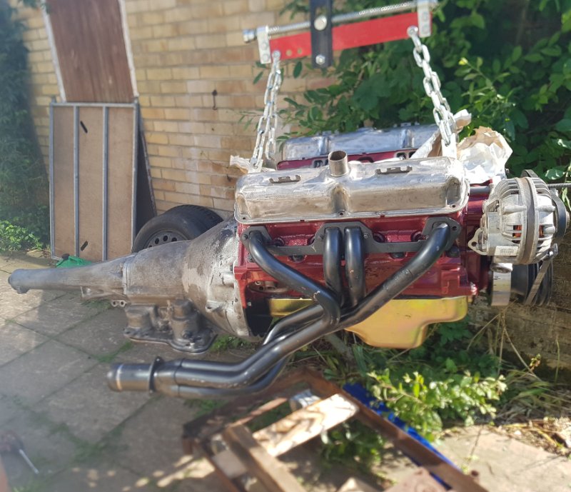

Posted: Thu Jun 25, 20 5:28 pm
by deppmobile
And in! First time I've tried box and engine in one - surprisingly straight forward :thumbright:
Cripes it was hot..... :shock:
