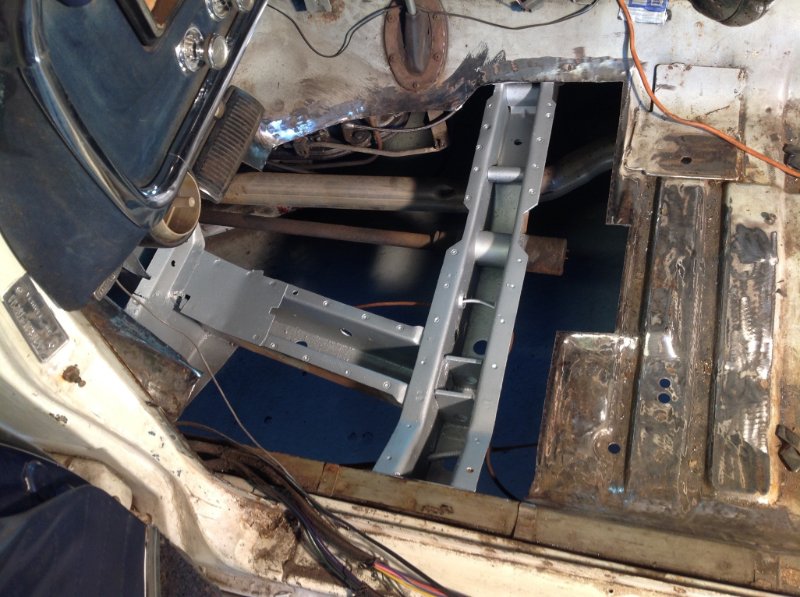

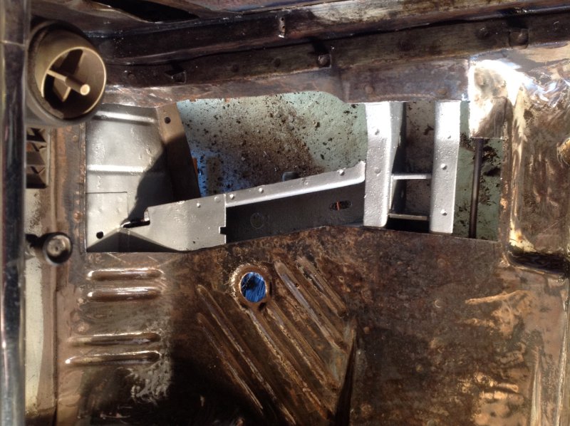

Not much to show for yesterday, got the patch trimmed up and the box sections primed, then spent the rest of the day crawling under the car chiselling off the underseal. Miserable job that...

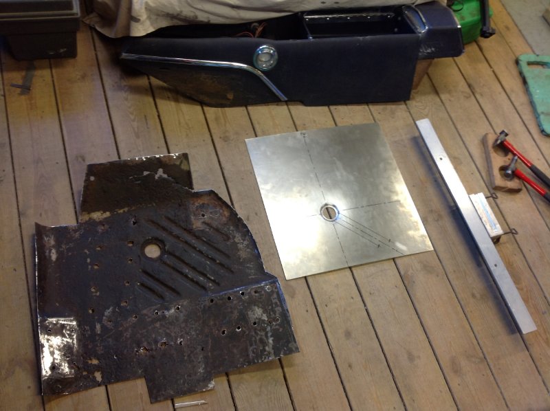

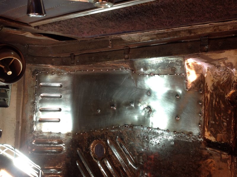

Yeah....I could do with her a bit higher off the ground really, but working with what I've got.
Tacked and welded, not the neatest job in the world but it's not going to fall out. It's never as easy in the footwell as on the bench :roll:
Floor 18.jpg (112.55 KiB) Viewed 5570 times
Floor 19.jpg (116.49 KiB) Viewed 5570 times
I suppose I better start on the other side #-o

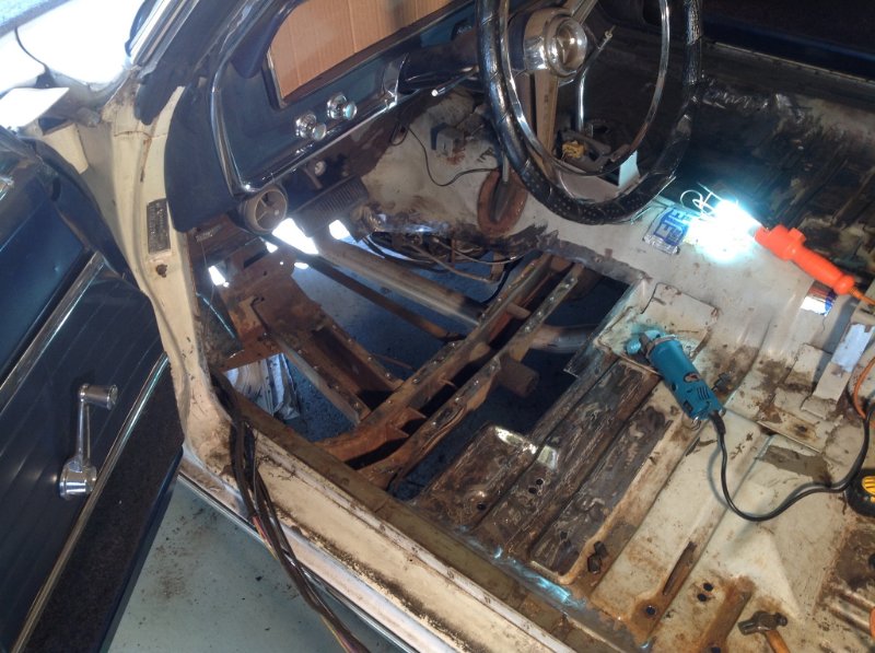

Drivers side cut out, rather more than the passenger side....
Floor 21.jpg (105.05 KiB) Viewed 5533 times
Floor 20.jpg (153.4 KiB) Viewed 5533 times
So here's where Blue's advice to get a new floorpan would be sensible, but I'm at home, with time on my hands, no money and probably just enough 18g left to fill the hole. Soooo... :geek:

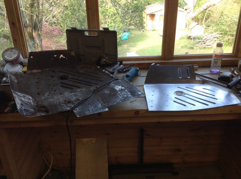

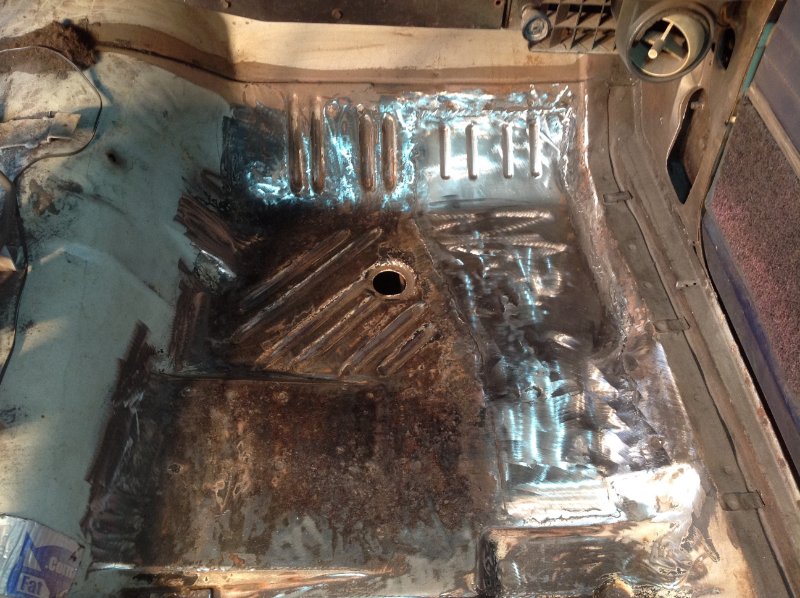

Yes :scratch: I think this one will be made up from a few bits. The hole seemed as good a place to start as any.
I think my neighbours will be fed up of the sound of hammering by the time it's done....
Floor 23.jpg (81.85 KiB) Viewed 5515 times
Posts: 3680
Re: Dom's 66 Coronet 500

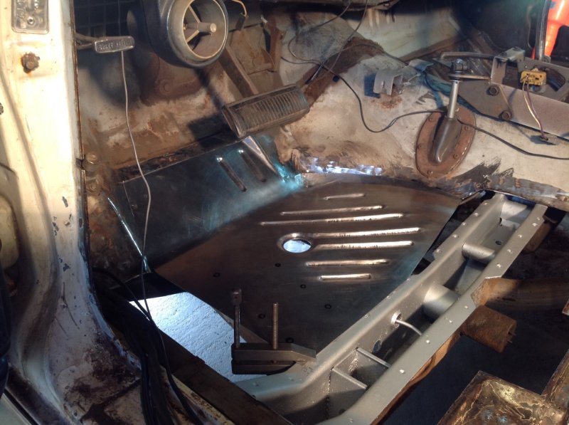

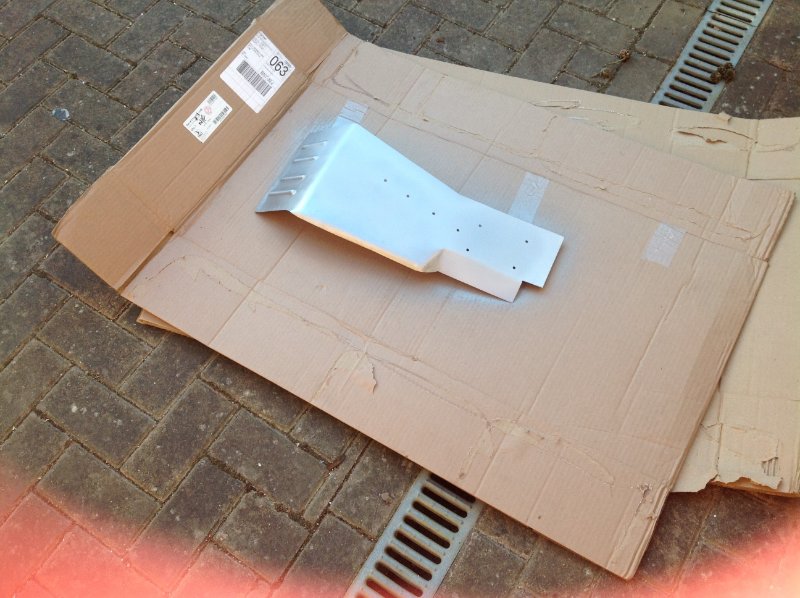

The chassis sections cleaned up nicely
Floor 25.jpg (104.42 KiB) Viewed 5497 times
A lot more bashing on the main panel
Floor 29.jpg (92.13 KiB) Viewed 5497 times
Seems to fit OK, now to fill the gaps...
Floor 28.jpg (90.76 KiB) Viewed 5497 times
