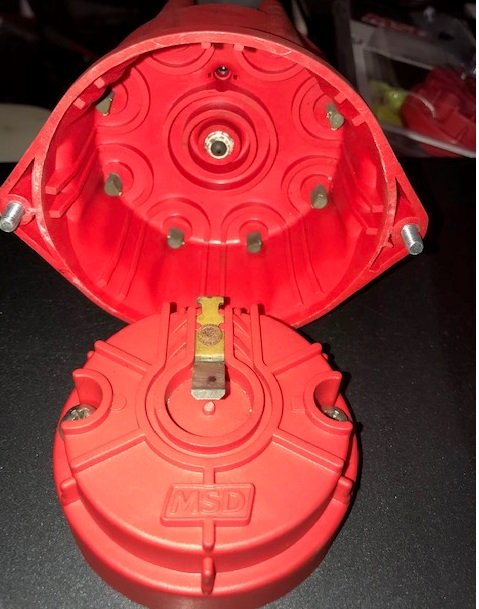

Swapped em over, fired her up.
I didnt roadtest BUT she didnt pop or bang once. The idle is dreadful anyway (v rough cam) but she ran, after a minute or so I was able to remove foot from throttle and she sat lumping away - no bangs, no pops. Ran her out of garage and back and she didnt stall or cough. So early indications are good - fingers crossed pending road test.
Question is still why. Cant see anything obviously wrong - the old cap and rotor have done MAYBE 5K ? Few years old now but still. No cracks, clean enough, spring gap good. If this DOES cure it I'm a little stumped. But I'll report back to my fave therapy group.
Morgan.
ta-da - taking a punt.
Not as shiny as when it went in, but OK.

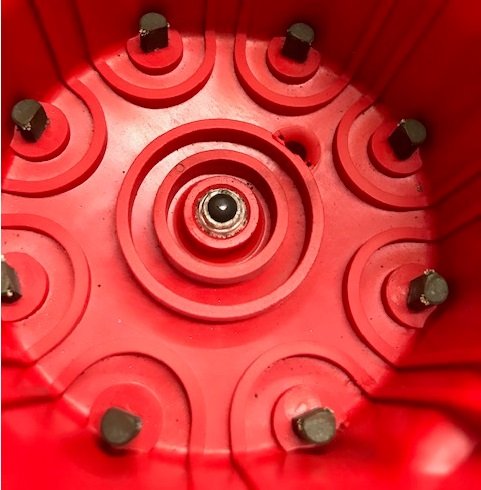

Old ones - nothing obvious.
Minor grot - slight rough bits but... ???

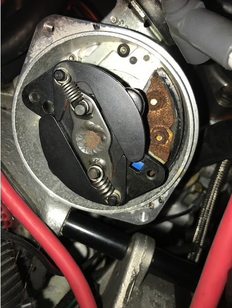

Posts: 22113
Re: Misfire ?
The springs look a trifle heavy in the photo.
Also, if you get really keen, you can phase the rotor too....

Re: Misfire ?
Interesting point. The new spring did sit lower, i noticed on removal. I’ll check it in the cardboard tang thing.
I dont think i want to go phasing ... haha - i’ll settle for ‘working’. When it comes to see you, knock yourself out. :)

Re: Misfire ?
Duh - just re-read post. Springs are stock curve. I had a faster advance setup ( lighter springs) but reverted to stock when troubleshooting.
So its 16/34 all in at 3k with stock mech advance currently. (Verified to be true)

Well, had a look. Pickup in cap gave a definite ‘pop’ but now moves freely. This might have been it - i could prove by swapping back i suppose... we’ll see how bored i get :-)
Started her agin, all the way up to temp. Sweet as. So i think its cured - one for the knowledge banks anyway...
