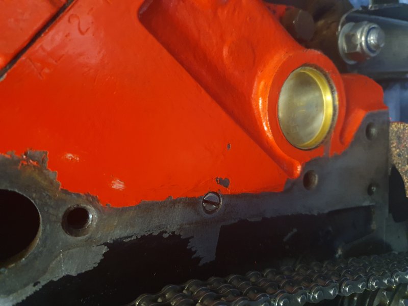

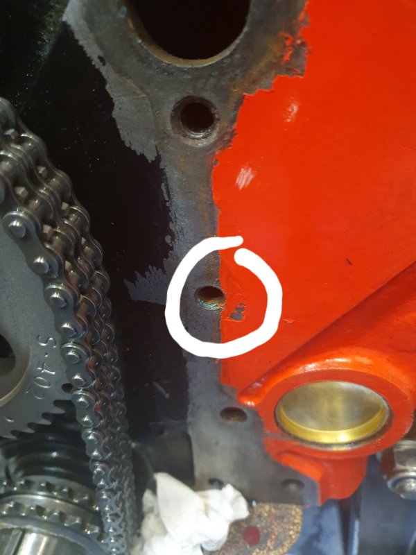

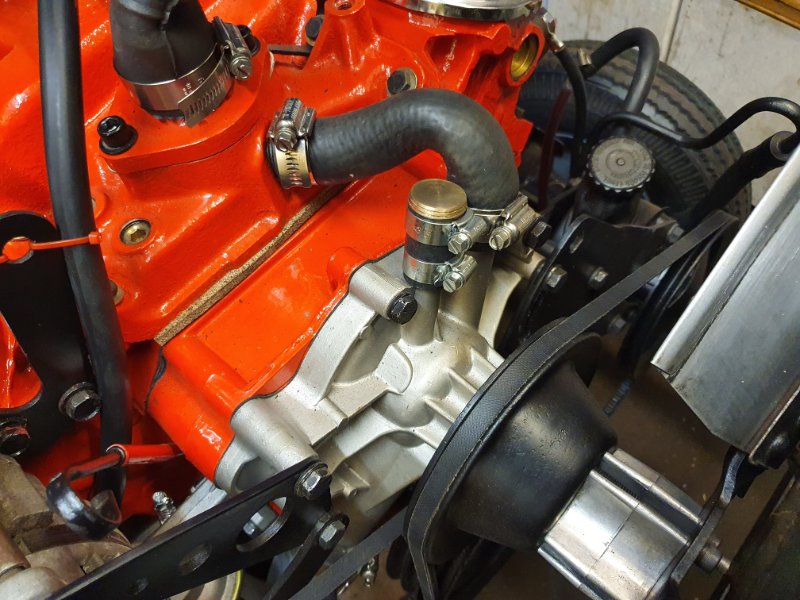

Little bit more progress, fitted the plug leads and set the distributor for 10* advance, then turned up a plug for the heater hose.
Mounted up the radiator and starting filling only to discover a large water leak :cry:
If you remember further back I replaced the timing cover with a later year than that of my block, well one bolt location isn't used on the newer cover and I now know it's drilled into the water jacket #-o
Strip it all down again fit a plug then reassemble.
After all that today we have...

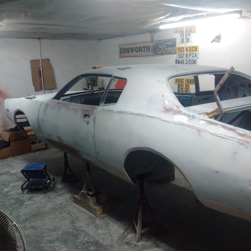

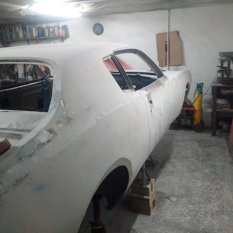

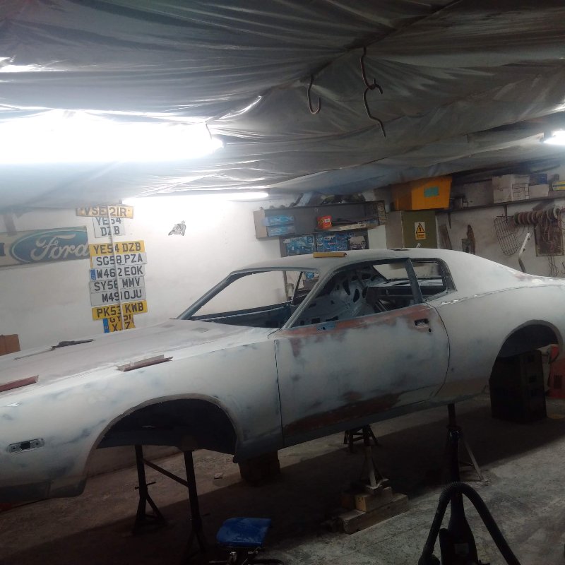

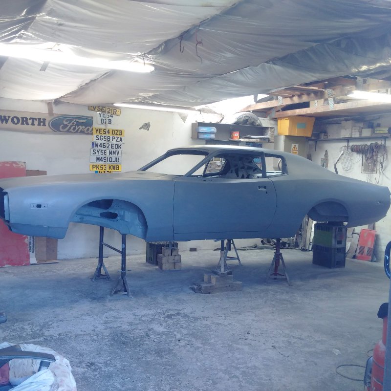

On a more positive side my brother sent some progress photos of the block sanding the other night and its taking shape nicely. I've run the engine up a couple of times, adjusted valve lash, set the initial timing, fitted the FBO limit plate and checked the mixture setting.

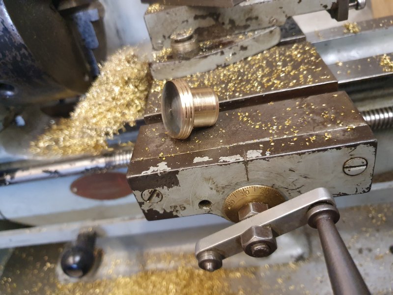

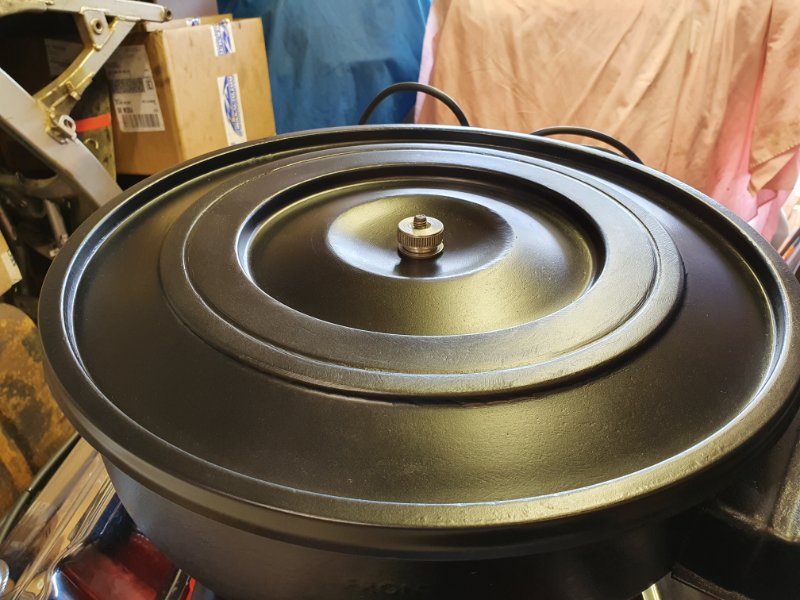

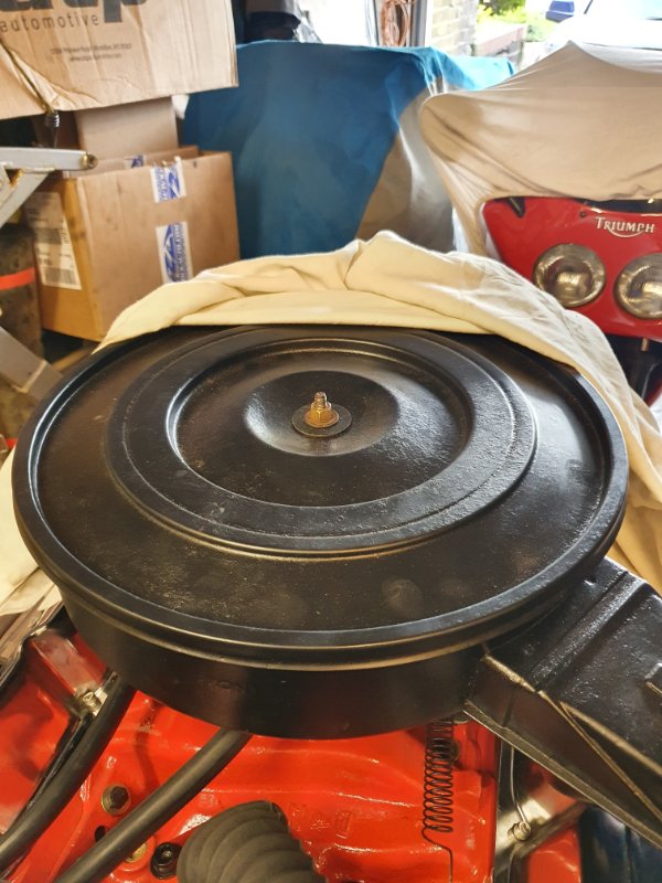

A little bit of tinkering, didn't like the top of the air filter or the nut that held the top on. So gave it a little rub down and repaint then on to the lathe to turn up a new thumb screw to secure it.

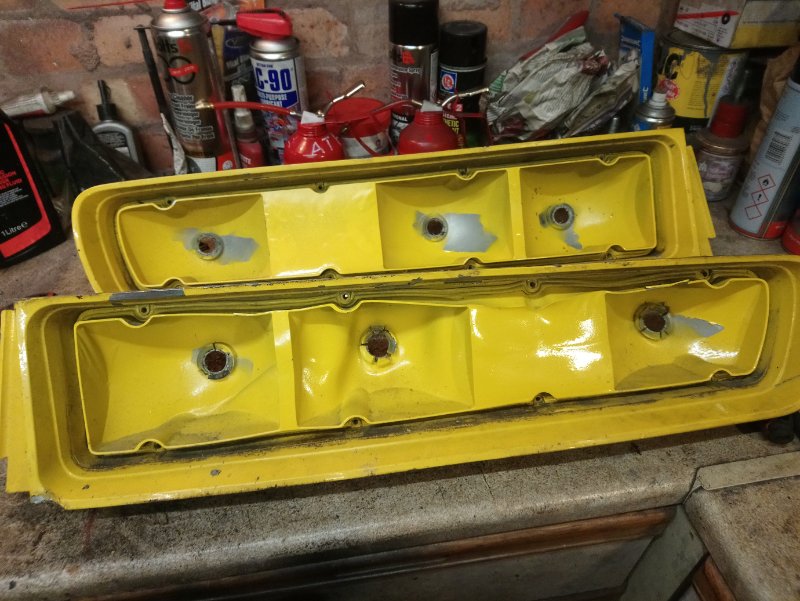

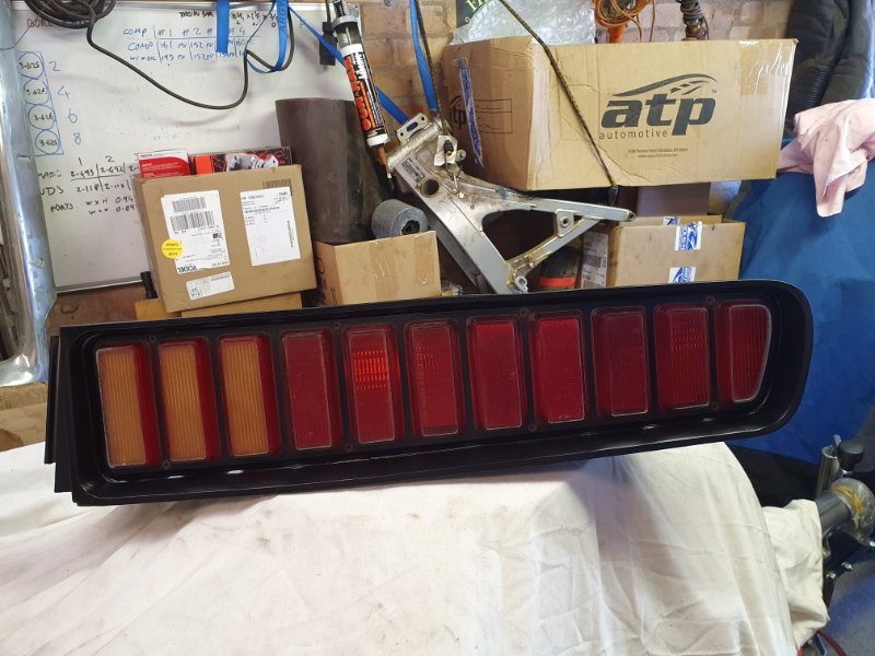

I then set about cleaning up the rear light clusters. They're not in good shape at all, most of the mounting tabs are broken and the O/S is badly distorted, I think at some point the car was most probably in or on fire.
Anyway I gave them a rub down, a coat of Satin Black and with the replacement lenses I got they'll do for now till I can chase down another pair or at least the O/S cluster. If anyone has or knows where I can get one, give us a shout :thumbright:

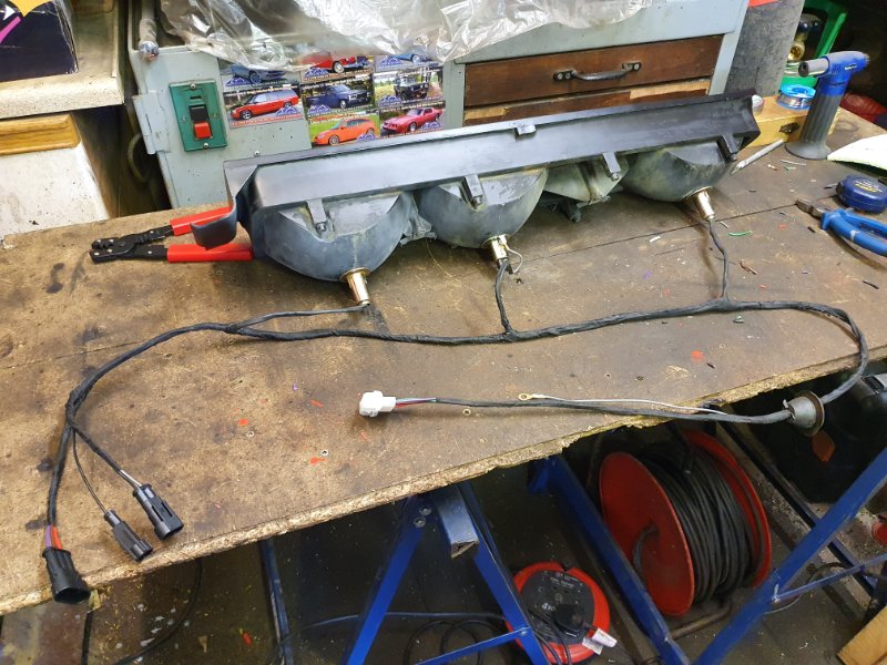

A little bit of an update for you all. I've made a start on sorting out the wiring loom. Started on the rear light section as all the bulb sockets were trashed and currently on the section from the A post to the rear. Then it'll be a case of trying to sort out the under dash hacked mess. Need to make some decisions regarding this section as in what to do about a fusebox, its there but has a lot of corrosion so I'm probably going replace it with a modern Blade fuse type and also whether to add extra relays for the rear lights.
The front under hood section of loom will probably be left to do on the car as I'm planning on converting it to H4 lights and need to see where to place the relays to switch those.

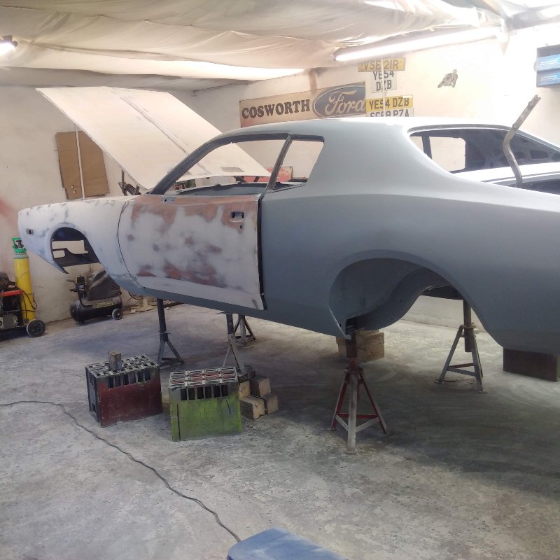

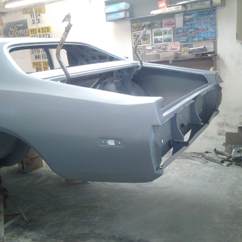

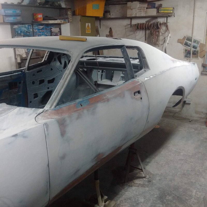

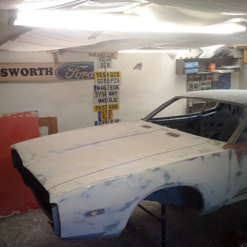

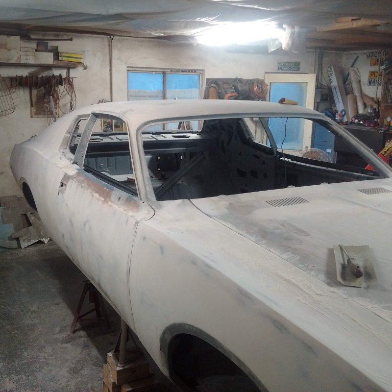

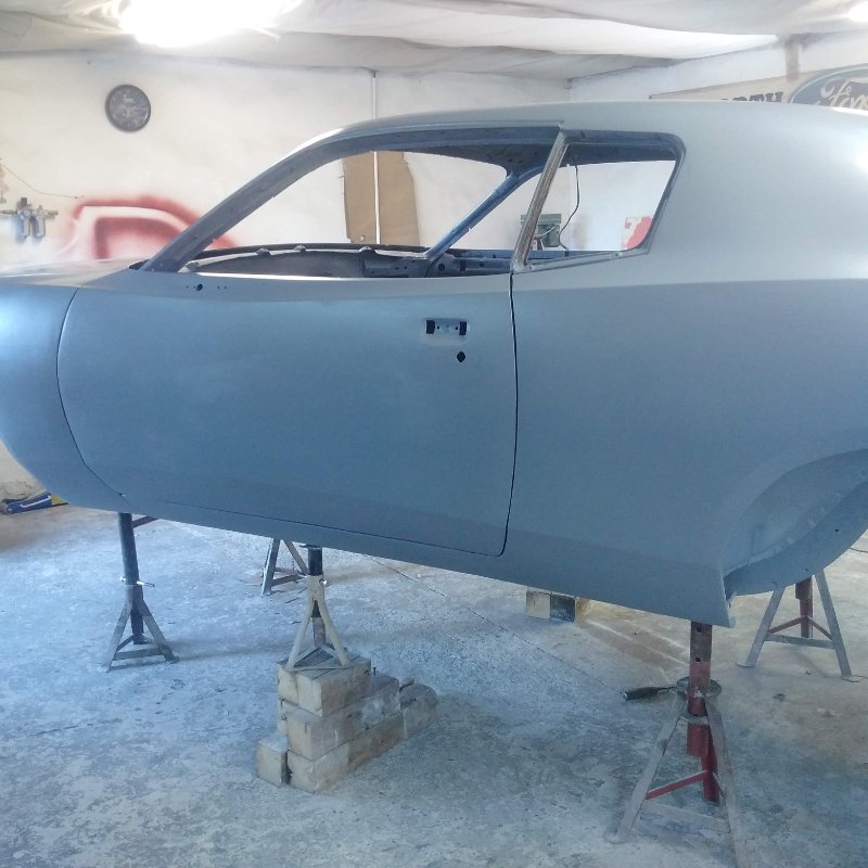

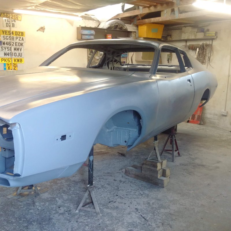

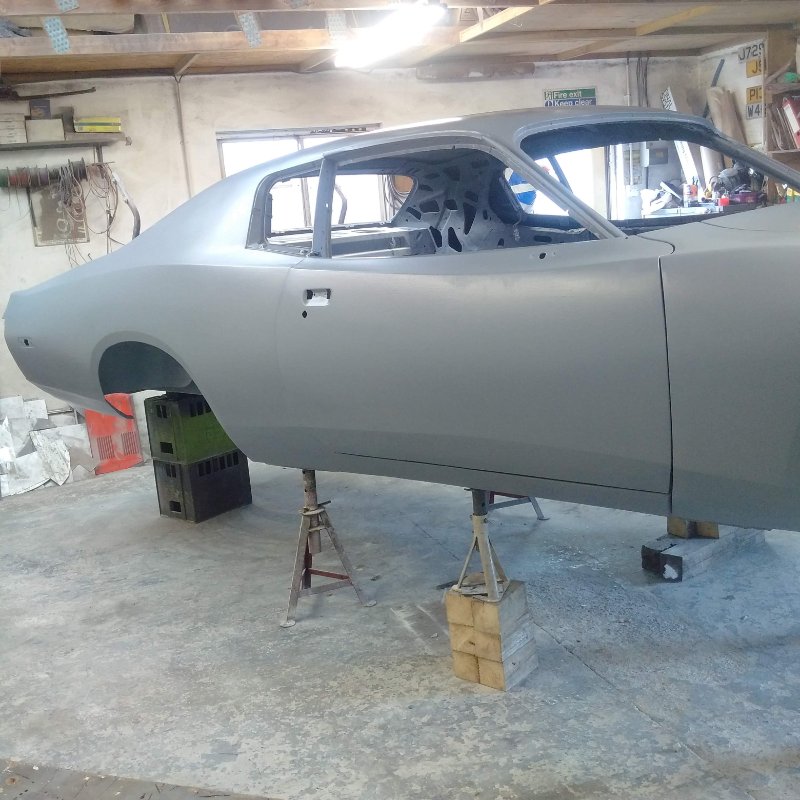

Stephen has sent some photos of the shell which has had coats of zinc primer applied to show the lines and any high/low places.
