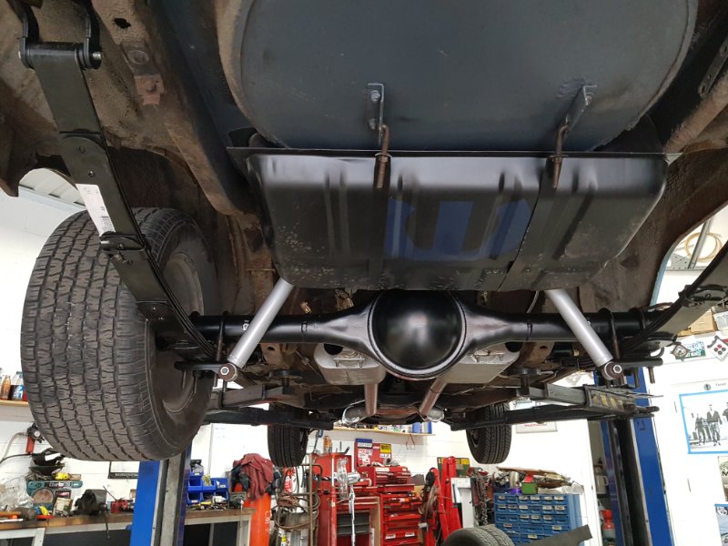

Took a trip down to Jims place to have a look at the progress and drop off a few more parts.
Old stuff has been removed and the new diff and suspension is all in. The prop was being measured when i turned up (for shortening).

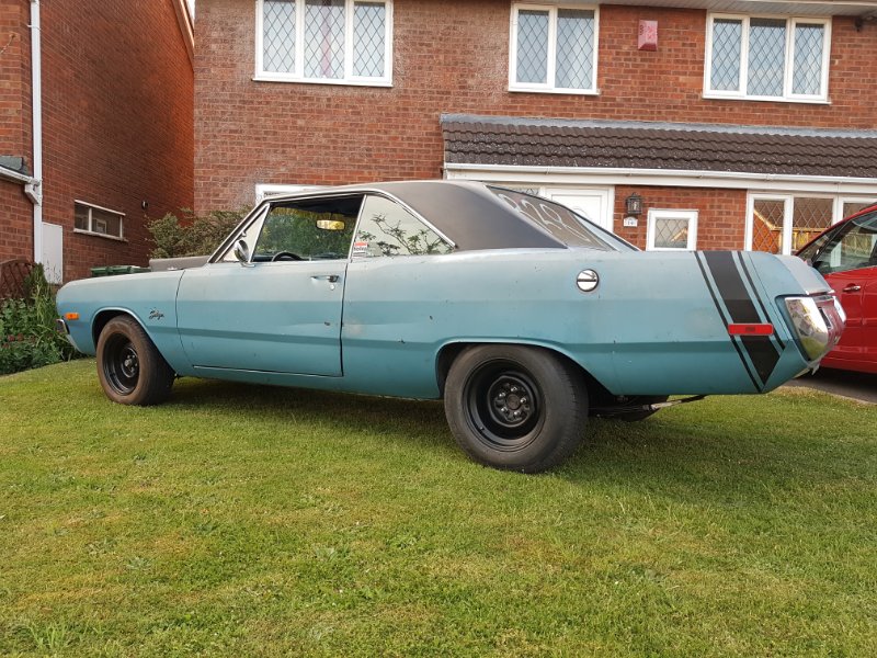

Well the prop arrived back from proptech and got fitted late yesterday. The test drive put the old Mopar grin back on my face.
Superstock springs sit almost level from the rear so no weird lean going on. Its also made the rear end a LOT stiffer.
As i had the front end done a few years ago the car now sits on all new bushes and shocks and its nice a frim/tight. Compared to when i drove it 2 weeks ago its night and day.......a great upgrade that gets rid of it being wollowy!
I never really punched it as i want to put a few heat cycles through the diff first, but initial impressions are its a lot more eager. Pickup is perfect for what i want and i have to cover the brake when running in drive at idle.
Need to get it MOTd and put a few miles on it first, but i think this is probably the best transformation/upgrade ive done thus far..............
As it sits now:
As it sits now:

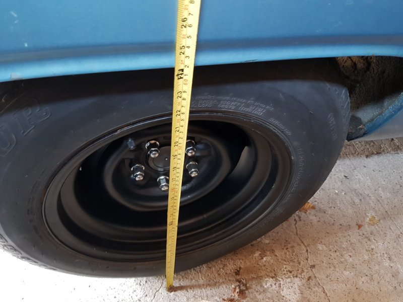

The final ride height compared to before the swap:
- 20180519_122852.jpg (71.21 KiB) Viewed 2057 times
Re: Dave's 72 Dart
Passenger side is up: 1.75" (22.5" to 24.25")
Drivers side is up: 1.5" (22.5" to 24")
As i said in a previous post id been looking for between 1" and 2".......Its spot on where i wanted it.
Very Happy with the result.
